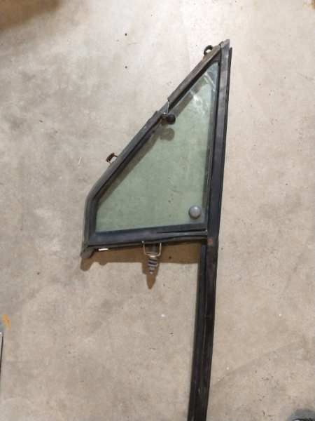

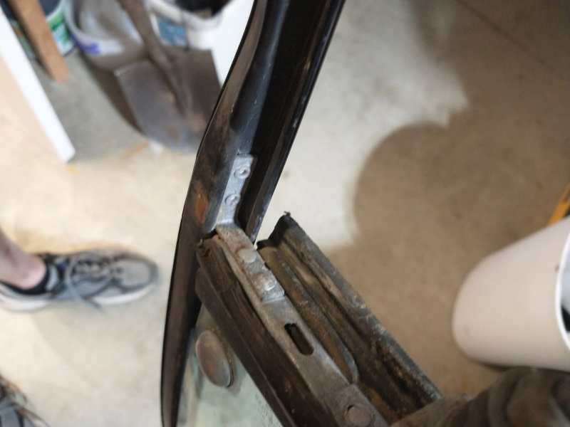

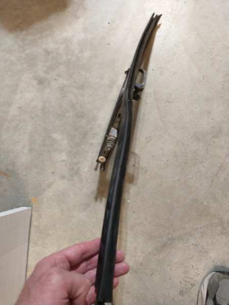

JZLAJeep Posted August 15 Share Posted August 15 This question fits under this heading so hopefully not too much of a high-jack. Apparently starting in '95 Jeep stopped allowing the vent windows to open. Last Saturday we pulled some vent windows from an XJ that was being parted to install on one of our newer XJs later. The driver door was dented enough to break the main glass, but not the vent window. I didn't notice at the time that unsurprisingly, the vertical rail (for lack of a better term) was bent (see the first photo). It appears that we won't be able to just pull the existing, non-opening, triangle window and replace it with the pulled vent window because of the bend and that we'll need to try to take two windows to make one. To that end, which is the easier route? 1) Move the vent window hardware (hinges, seals, etc.) to the existing window. 2) Remove the vertical rails and replace the bent one with the good existing one. Looks like maybe it's a matter of removing a few rivets (see 3rd photo) and somehow putting it back together. Link to comment Share on other sites More sharing options...
Pete M Posted August 16 Share Posted August 16 if there are rivets to remove, you can rivet it back in place Link to comment Share on other sites More sharing options...
