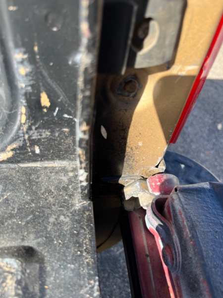

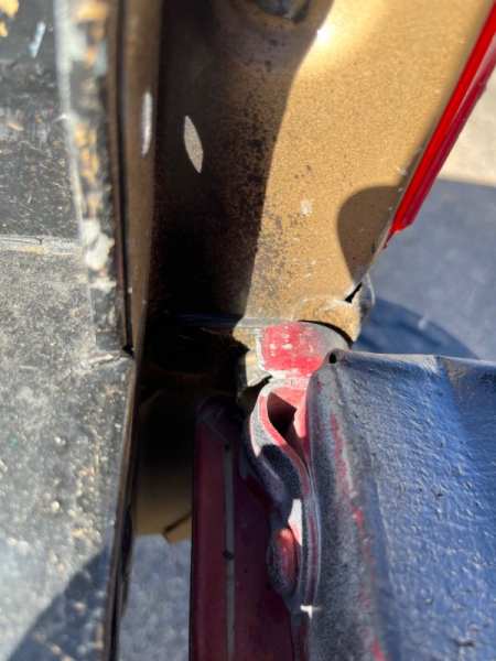

aris_garage_builds Posted July 30, 2025 Posted July 30, 2025 Hi all, my tailgate currently has a lot of movement (very similar to the YouTube video I’ve linked below for reference). I assume it has something to do with the lower pivot point on the passenger side of the tailgate. I notice the drivers side is a closed loop, but the passenger side has an opening which is allowing the hinge to slide in and out - not sure if this design is intentional. Does anyone have recommendations on the best way to repair this so it’s more stable? Should I look for a replacement peice / fabricate a new one? Thanks!
89 MJ Posted July 30, 2025 Posted July 30, 2025 That is open by design. It allows the tailgate to be removable that way. I've heard of people putting a hose clamp around it to prevent it from moving (mainly to prevent theft).

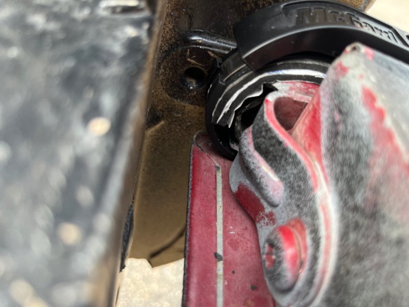

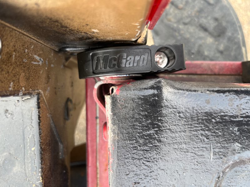

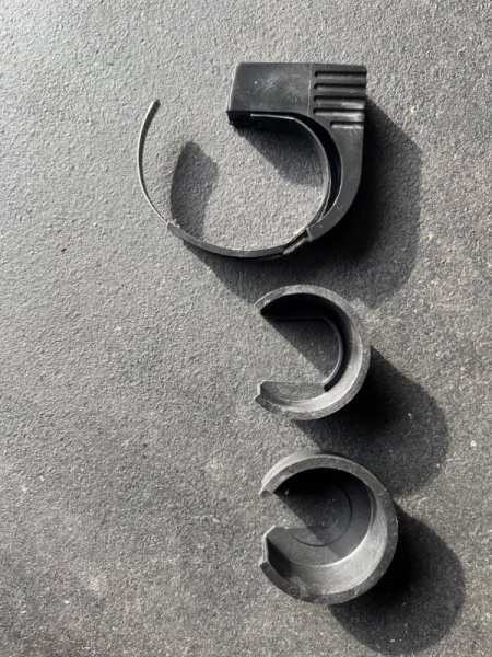

aris_garage_builds Posted November 1, 2025 Author Posted November 1, 2025 On 7/30/2025 at 7:19 PM, AnotherOldJeepGuy said: Please do post back with pics! Apologies for the delay, but wanted to follow up here! I ordered the McGard tailgate lock and it mostly fit. The lock itself fits perfectly behind the tailgate and tucks up nicely against the body when you close it. Included with the lock are two styles of cup like inserts that are molded to fit the hinges of modern popular tailgates. Unsurprisingly, neither of these fit the Comanche tailgate, but I put a little bit of foam in there as a temporary solution and that helped it stay snug. I think you could pretty easily 3D print a cup that was modeled to fit the MJ’s hinge. Might be a future project for me once I finish up some other repairs.
