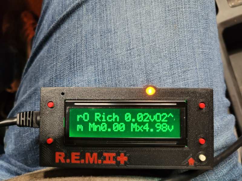

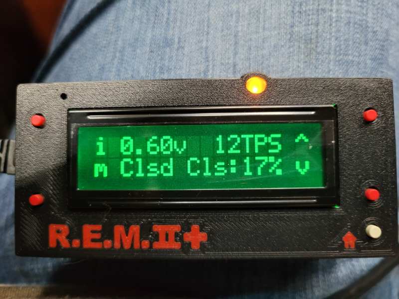

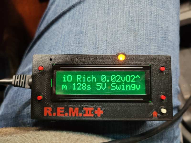

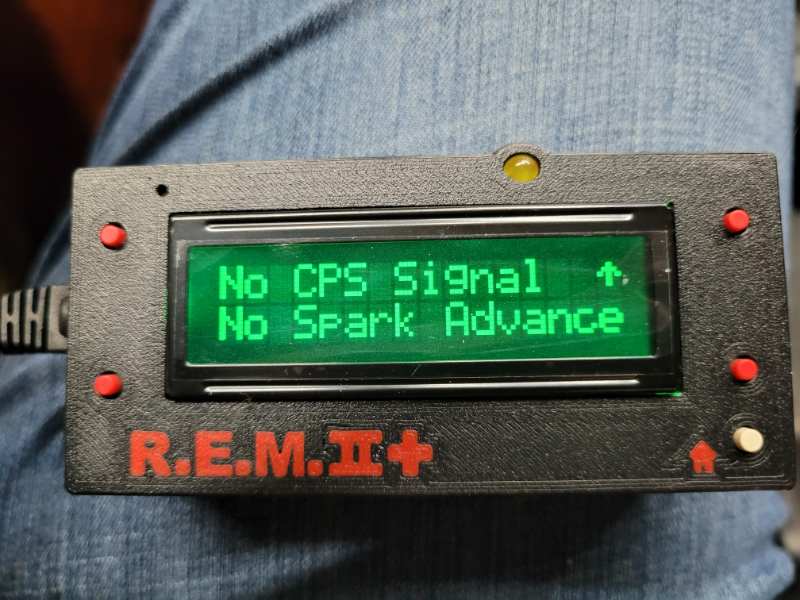

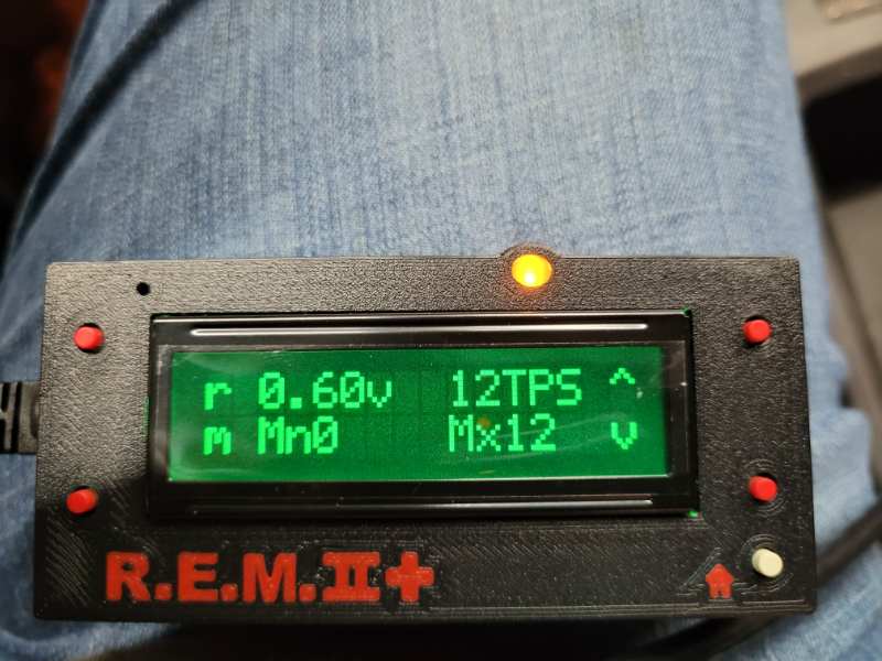

dotnetrob Posted August 3, 2025 Author Posted August 3, 2025 On 8/2/2025 at 12:55 PM, fiatslug87 said: By turning over you mean it started and ran for a second, right? Jump the fuel pump ballast resistor on the driver side fender and try starting. You can also check fuel pressure at the rail, Cruiser’s tips has the procedure. Correct, if i put spray starter fluid directly into the throttle body it starts and run for a second or two. Without starter fluid it just cranks and engine doesn't start. Jumping the fuel pump ballast resistor didn't change the results with or without starter fluid. Got a R.E.M.II+ from NickInTimeDesign today. Plugged it in to get some readings. Still learning all the workings of the REM but below are some screens from the diagnostic section, not sure if they help at all. Only tried starting it without starer fluid to get readings. Didn't try putting in starter fluid so that It would run for a few seconds, not sure if that would results in different/altered data. Did see a message saying No CPS signal, not sure if I should put old cps back since it may not have help swapping it out. Current next steps I plan to test/try. Unless I should try something else first. Check if fuel pump is coming on, hard for me to hear over the ignition buzzer. Got under the jeep last time while some turn the ignition to the start position and pretty sure I head the fuel pump. Just waiting on an extra set of hand so I can retest. Check fuel pump ground by tail lights. I did swap out the tail lights weeks ago, have driven it many times since, but will check to make sure it still good and attached, may move as per recommendation once I get it running again. Checking fuel rail pressure, don't have pressure gauge I can use for this, getting one today Ordered a fuel filter, may or may not change it out depending on results of other test.
fiatslug87 Posted August 3, 2025 Posted August 3, 2025 I would leave the CPS alone, since it starts and runs with starting fluid it’s getting spark. Concentrate on fuel delivery. The TPS should be at 17 at idle when you get it running.
Eagle_SX4 Posted August 3, 2025 Posted August 3, 2025 7 minutes ago, dotnetrob said: Correct, if i put spray starter fluid directly into the throttle body it starts and run for a second or two. Without starter fluid it just cranks and engine doesn't start. 7 minutes ago, dotnetrob said: Did see a message saying No CPS signal, not sure if I should put old cps back since it may not have help swapping it out. I just ran into this a similar issue. My rem said CPS Crank fault but I had spark which didn't make any sense. You also have spark because it would not fire with starting fluid if you didn't. I noticed that the CPS Crank fault doesn't come in immediately when cranking it takes a few seconds to turn on. Which leads me to believe that the computer cuts spark after it doesn't fire. And you either have a fuel issue or your distributor is not indexed properly. Don't change your CPS out. It is probably not the issue. Based on all your symptoms you definitely have a fuel issue and first you need to check if your fuel pump is running. It should turn on for about 2-3 seconds when the key is first turned on then the fuel pump will shut off. You will be able to hear the pump run. If you can't hear the pump run. That is where I would start.
