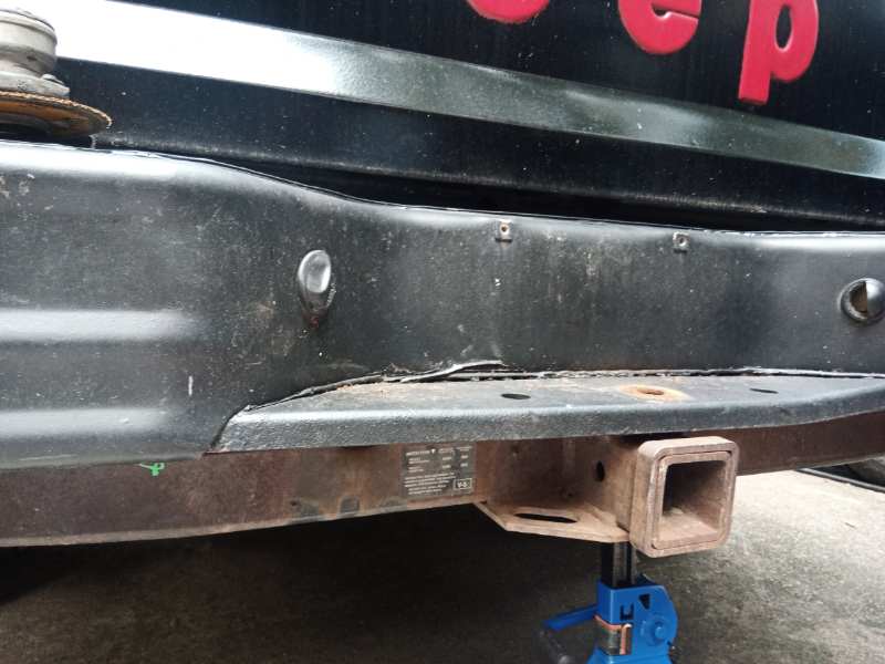

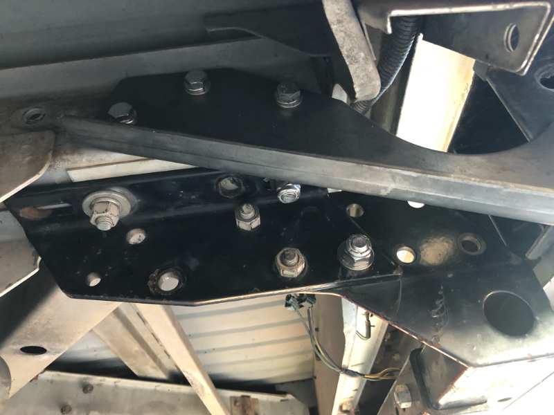

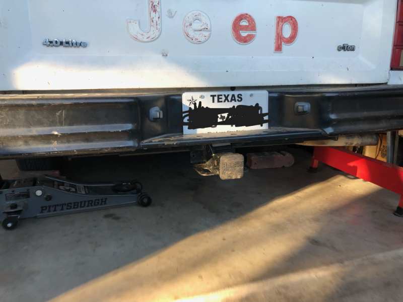

Pete M Posted July 18 Share Posted July 18 if you can weld, you can buy his side brackets separate from a whole unit and grab a hitch from an Excursion from a local junkyard. I did that to the 88 I was working on. I used the excursion after failing to find a single pickup that had a wide enough hitch (they all seem to go between the inner frame walls rather than the MJ's outside-to-outside). Link to comment Share on other sites More sharing options...
