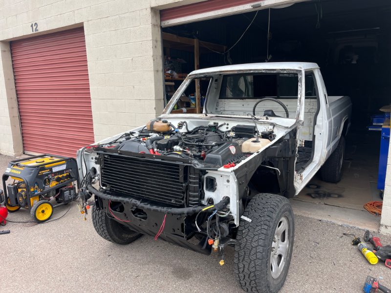

Elwiscon Posted June 26 Share Posted June 26 After months of mechanical work and after some bondo ding repairs and sanding I’m finally close to painting the body, hood, fenders, doors etc are off and almost ready to paint. I’ve been debating between Rustoleoum and Durabak, obviously both have drawbacks, and advantage. I settled for white instead of a darker color, as it looks good, no mixing/tinting, it is clean and it is the factory color. I got a couple swatches of outdoor-rated smooth Durabak, i think it looks great, it can be thinned and sprayed, and they even have a clearcoat. I’ve seen some videos of people painting with rustoleum and it looks awesome, theres a video of a guy using black rustoleum and he even cuts and polishes between coats, with a clearcoat finish, the end result is amazing, deep glass-like and professional. However, i’ve read Rustoleum or other tractor paints loose their shine after a couple years and may even become chalky. My truck will be used as a truck (light hauling, very light off roading), so I hope i can get a long-lasting paint job, white should last longer than a darker color and looks good. Has anyone used smooth durabak? Regardless of product preparation is key so i will make sure i do it right, any input is appreciated, thanks Link to comment Share on other sites More sharing options...

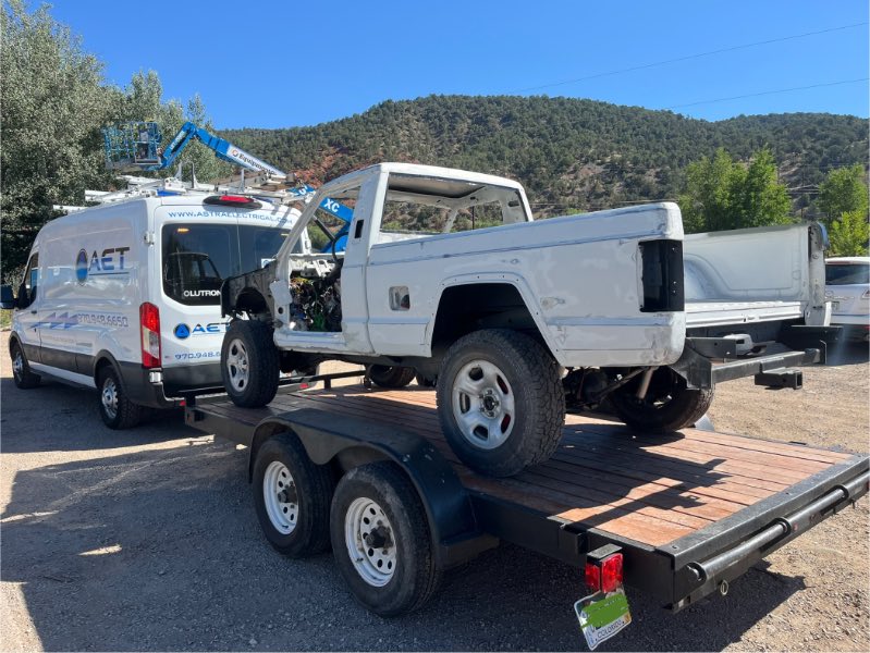

Elwiscon Posted July 9 Author Share Posted July 9 En route 20 miles away to the paint shop! rest of body parts (hood, doors, fenders, tailgate, etc) loaded up in the van. This is too nice of a truck for me to practice painting on so better leave it to the pro's, a little pricey but it'll be well worth it, luckilyI saved some labor money by removing glass, body panels etc, I will also re-assemble it once I get it back . After considering original white and several dark grays/charcoals/ blacks etc I settled for GM's "Dark Spiral Grey", I've always liked that color. I will be raptor lining the bumpers (with proper prep), grille and headlight bezels, originals are dried up and brittle so better get some proper replacements. We'll see how it turns out!, I'll be painting the interior in landau black, original dash broke as I was removing it so ended up getting a nice OEM black dash off of a 95 XJ, a gray center console off a junkyard 92 XJ, and I'll get some Corbeau bucket seats. (Truck was properly tied down after pic was taken) Link to comment Share on other sites More sharing options...
