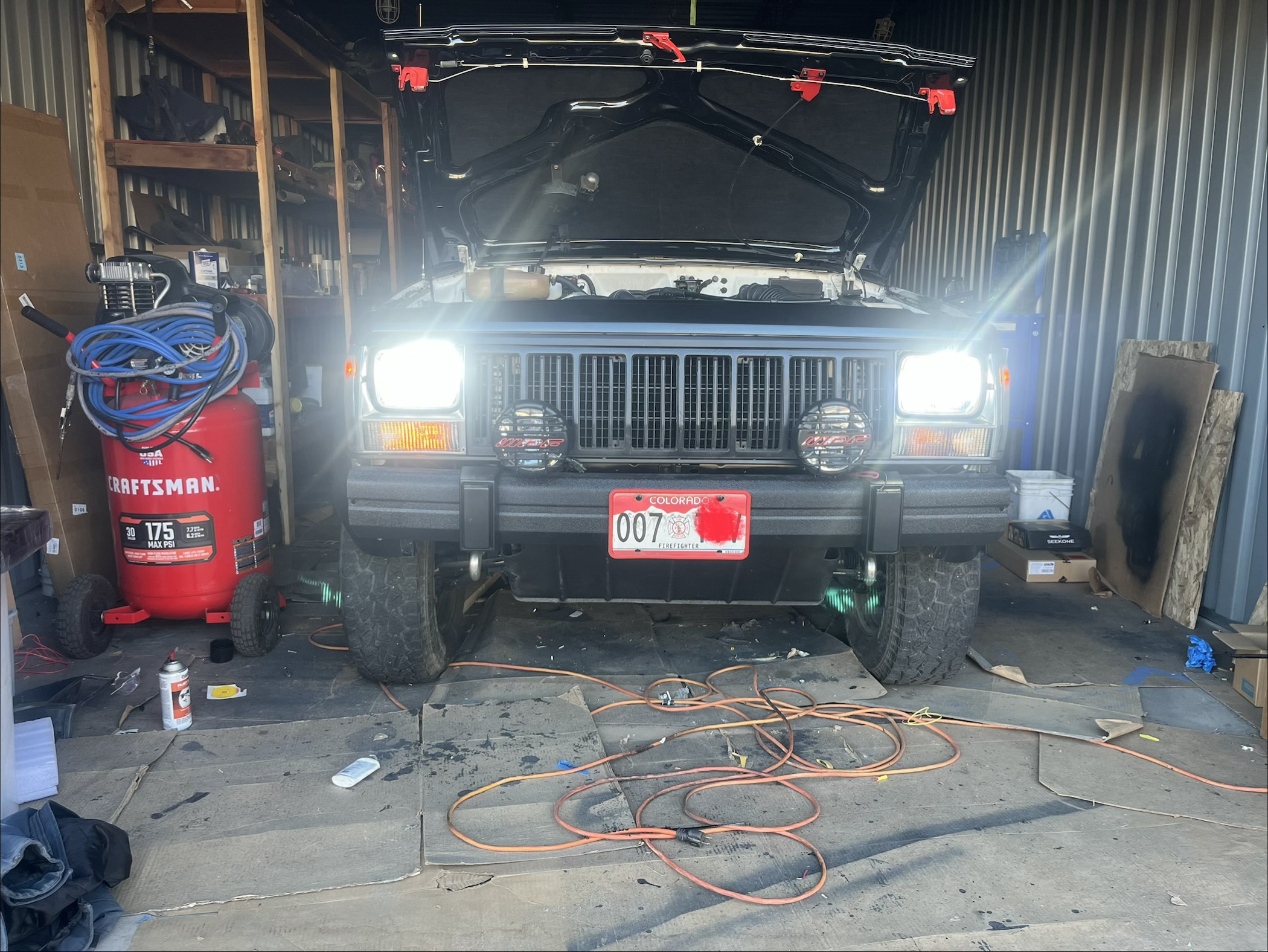

  5. Refinished bumper LED bed light Hella H4 Conversion headlights, Insulated hood, Auxito H4 bulbs (including fogs) still a long way to go
