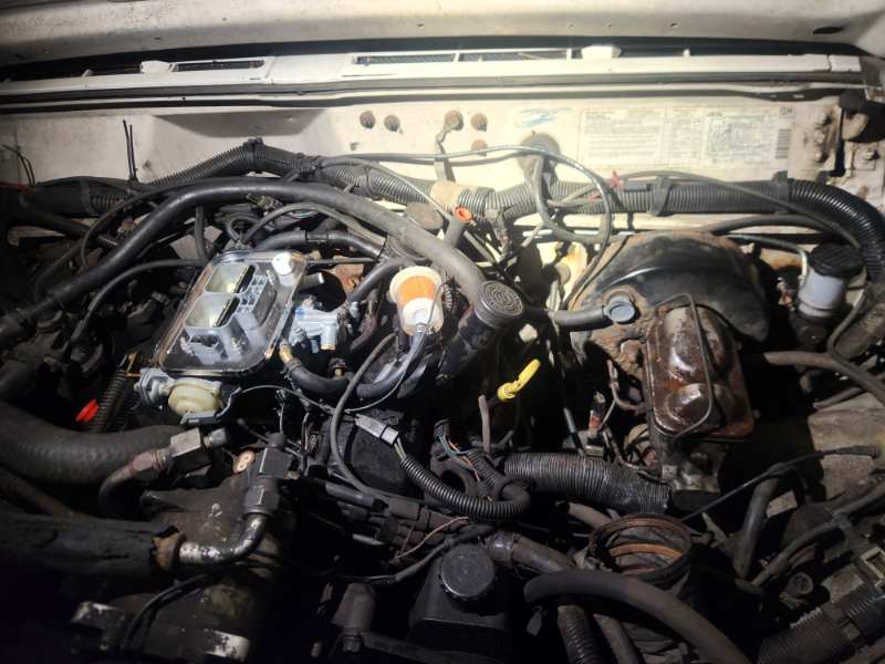

89 MJ Posted June 23, 2025 Share Posted June 23, 2025 (edited) Can you post a picture of the loose vacuum lines that you've got? Maybe a picture of the engine bay from the front left corner too? Just so we can look and see if anything looks out of place. On another note, to get it to run, you just need air, fuel, spark, and compression. Plug your vacuum leaks in the intake and carb, verify that you're getting those 4 things and it should run. Then we can focus on getting it running properly. Edited June 23, 2025 by 89 MJ Clarifying what I said Link to comment Share on other sites More sharing options...
pizzaman09 Posted June 23, 2025 Share Posted June 23, 2025 If you just want it to run, plug all loose lines going to the carb or intake manifold as they will be vacuum leaks. Alternativly, you can start plugging them back in where they belong. The goal is to eliminate as many vacuum leaks as possible as that will give it the best chance of running. Link to comment Share on other sites More sharing options...

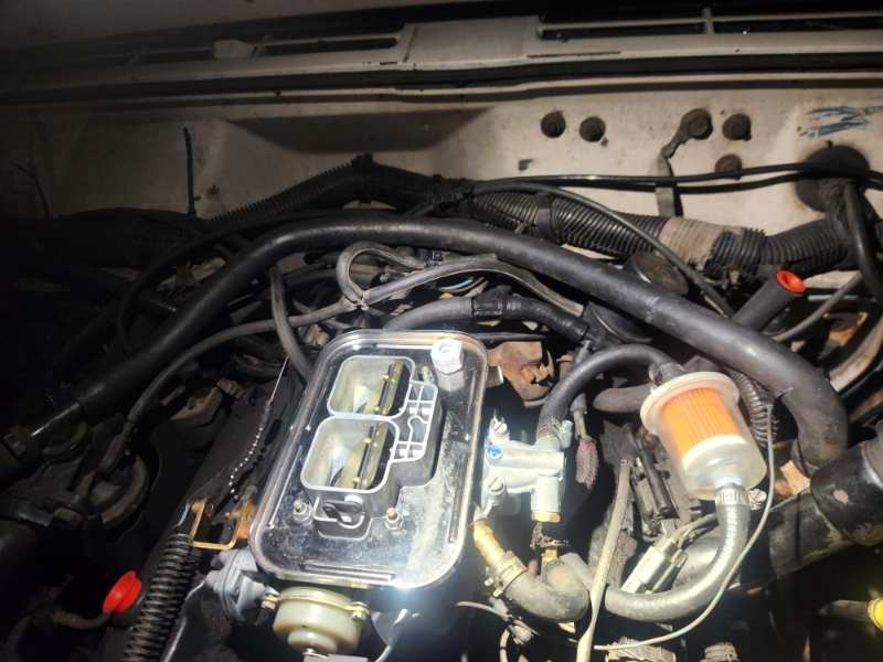

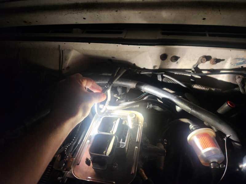

Rusty_Panda Posted June 27, 2025 Author Share Posted June 27, 2025 With the help of carb cleaner sprayed directly into the weber carb its starting but only at 4,000 rpm. I will post the photos but in the meantime I've got to figure out how to tune it. 20250626_202252.mp4 Link to comment Share on other sites More sharing options...
Rusty_Panda Posted June 27, 2025 Author Share Posted June 27, 2025 Link to comment Share on other sites More sharing options...
llhat Posted June 27, 2025 Share Posted June 27, 2025 4000? yikes, this with vacuum lines plugged? will it run 'off' of the cleaner? i think i see fuel in the clear filter... far from expert, but the choke is still engaged on the weber, this activates a 'fast idle cam' which opens the throttle plates at the base of the carburetor, increasing idle speed. ensure the fast idle cam disengaged and basic visuals for vacuum leaks. good luck Link to comment Share on other sites More sharing options...
pizzaman09 Posted July 1, 2025 Share Posted July 1, 2025 Is it possible that the throttle is propped open? Like is the gasket under the carb hanging up the butterflies or is the linkage not allowing the throttle to close all of the way. There is a lot of air getting into that engine. Link to comment Share on other sites More sharing options...
coheed Posted July 1, 2025 Share Posted July 1, 2025 Yeah, that seems like a throttle sticking issue or the carb cleaner is making it run that high. When I have multiple vacuum lines unhooked on my 2.8 it won't even idle because it's too lean. I don't have egr hooked up at all and I only have 4 vacuum lines hooked up; the brake booster, the one going to the fuel tank, one for the hvac controls, and one for the distributor advance. Everything else is plugged. Link to comment Share on other sites More sharing options...
Rusty_Panda Posted July 12, 2025 Author Share Posted July 12, 2025 I think I'll just buy a couple feet of vacume line from the auto parts store and make it look pretty. Anyone know where I can get a photo of the 2.8l w/ ac routing? I can't make heads or tails of my diagram, thanks. Link to comment Share on other sites More sharing options...
Eagle_SX4 Posted July 12, 2025 Share Posted July 12, 2025 43 minutes ago, Rusty_Panda said: Anyone know where I can get a photo of the 2.8l w/ ac routing? This thread has pics of all engine options and years. Hopefully it has what you need. Link to comment Share on other sites More sharing options...
