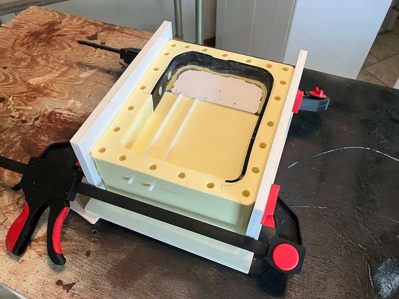

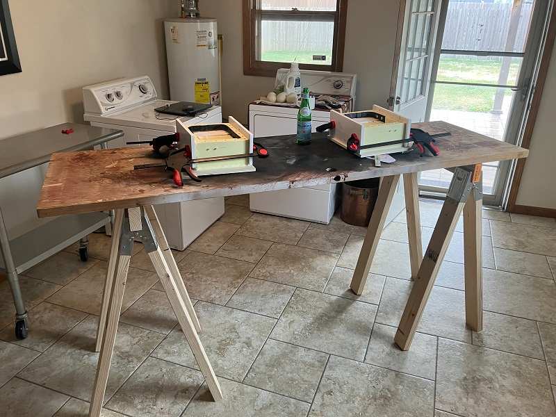

White_Comanche Posted March 23 Author Posted March 23 Pouring Mold Part #2 happened this weekend. Happy to report that the aerosol mold separation product did its job. Today, I had to wait a long 6 hours for everything to cure before I knew anything. Thankfully Mold Part #2 did not stick to Part #1. This project has taken on a life of its own. Got $500 bucks easily wrapped up into this already. There's still a wee bit of uncertainty involving the future steps. Regardless of the outcome, I'm grateful for the success in overcoming all the challenges, and learning. Next: purchasing product to finally pour Mold Part #3. (By the way... an old door with DIY sawhorses make for a fantastic work table)

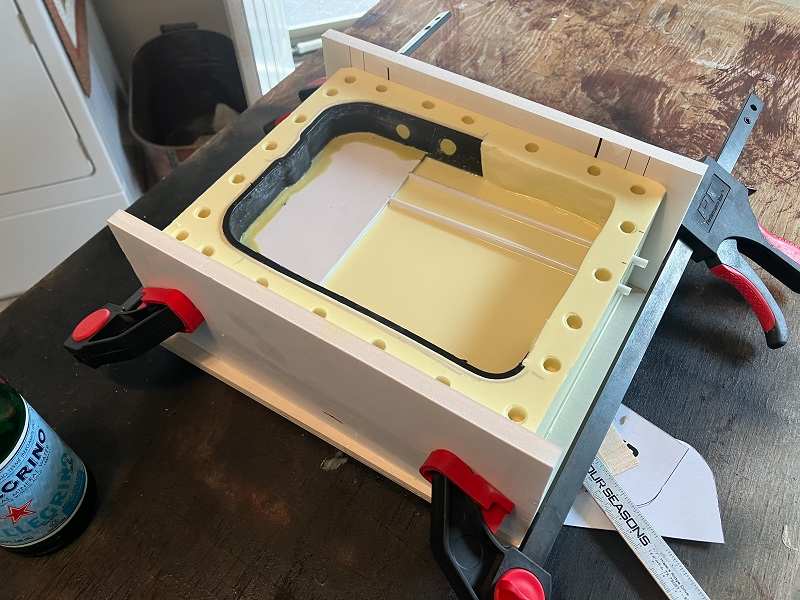

White_Comanche Posted July 26 Author Posted July 26 Did some late night "pouring" ... the bourbon helped out as well Things are looking promising. I will fully demold this tomorrow.

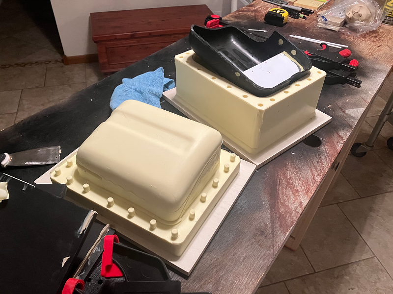

White_Comanche Posted July 27 Author Posted July 27 PROOF OF CONCEPT Everything demolded properly and very cleanly, just a few more vent holes need to be cut for all the air to escape. However, more experimentation needs to happen before making copies. Instead of buying a cheap & quick white resin to make this 1st prototype, I went with a product that helped establish the "furthest reaches" of how soft I can go. You might think this looks hard, but it is not... it's very soft and flexible. One truth I discovered today was how thin factory plastic was in places — which is the next challenge. To match the hardness, look & feel there are a few routes to take. However, each has benefits and tradeoffs. Here's just a few specs I'm looking for. Also, perhaps as important is the ability to pour indoors safely with proper ventilation. • Shore Hardness • Flexibility • Mixed Viscosity • Pot Life • Cure Time • UV Resistance
