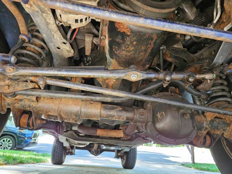

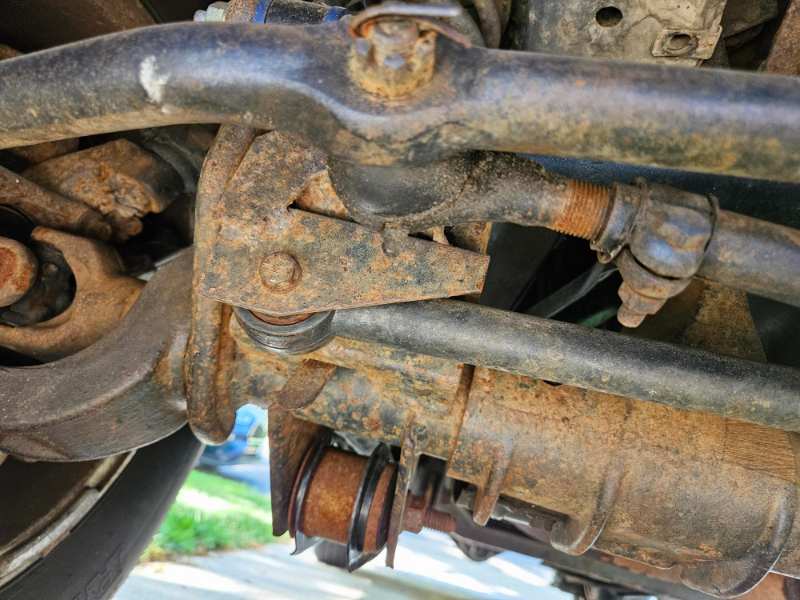

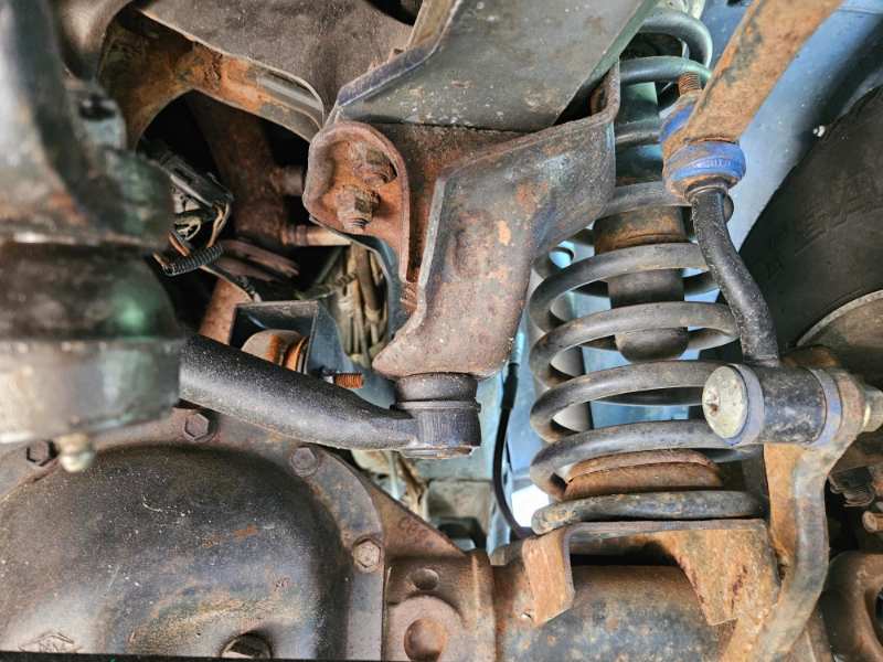

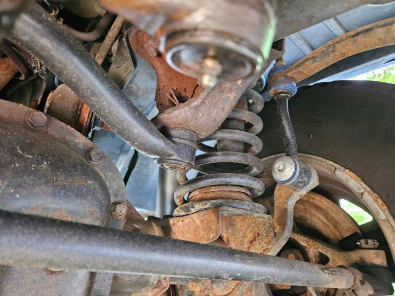

EdJarHead Posted May 2, 2025 Author Share Posted May 2, 2025 Photos showing track bar installation. Other than the missing grease fitting, it appears right to my amateur eyes. Link to comment Share on other sites More sharing options...
ThatJeepGuy Posted May 2, 2025 Share Posted May 2, 2025 My theory now.... your coil springs are wore out enough to where you are technically below factory suspension height enough to where the axle is off center. If you think about it, a simple lift puck would separate the body form the axle more and therefor the axle would follow the ARC and the axle would shift closer to the driver side therefore centering the axle. Prognosis is you need a lift kit now ;) Link to comment Share on other sites More sharing options...
EdJarHead Posted May 2, 2025 Author Share Posted May 2, 2025 52 minutes ago, ThatJeepGuy said: My theory now.... your coil springs are wore out enough to where you are technically below factory suspension height enough to where the axle is off center. If you think about it, a simple lift puck would separate the body form the axle more and therefor the axle would follow the ARC and the axle would shift closer to the driver side therefore centering the axle. Prognosis is you need a lift kit now ;) Makes sense, as the rear seems low as well... especially if I carry anything in the bed, so new springs on both ends should probably be added to "the list"... (which grows faster than I can check things off sometimes). Link to comment Share on other sites More sharing options...
