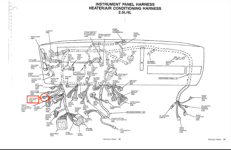

NickyV Posted April 16, 2025 Share Posted April 16, 2025 SOLVED: The main issue was that one of the two grounds connected to the driver's side door jamb switch had been disconnected. Secondary issue was that the seatbelt connectors under the seat weren't connected. Fixing the severed ground on the door jamb got most of the warnings working. Plugging in the connectors for the seatbelt solved the seatbelt warning. --- --- --- ORIGINAL POST: I recently picked up a blue chime module from the JY. Had a black one before that. It didn't make sound, and I figured was busted. But after plugging in the blue one, I had the exact same symptoms I was experiencing with the black one: [NOTE: This post has been edited since a new thread was started.] Parking Brake Light and Seat Belt Light both illuminate, but no sound. So, I found this older thread and did the bench test that @schardein outlined there (quoted below). Both the black one and the blue one seem to work properly during bench test. That is, they make noise as expected. Quote When testing the seat belt warning, apply 12 volts to only the far right, upper terminal as shown in the picture. Then apply a ground to the far left, upper terminal. The buzzer will sound for as long as you maintain the connection. Then, without removing the ground connection to the far left terminal, slide it over so it touches the second terminal at the same time. This starts the timer, and the buzzer will shut off in about 5-10 seconds. To test the key-in and headlight warning functions, ground the lower right terminal. Touch power to the far left terminal (blue box) and the headlight warning buzzer will sound. Touch the next terminal with ground, the key-in buzzer will sound. Testing Procedure from "Electrical Troubleshooting" (1988 MJ Edition): So what gives? Well... I have some theories. I followed the troubleshooting guide and discovered that I'm getting proper voltage out of ports 1, 7 and 8. I am also getting proper ohms readings at Ports 2 and 3... at least I think they are OK. Feel free to let me know if I'm wrong. Here's what I am getting: - Port 2 gives me 0.103K ohms (black lead directly on battery, red lead coming out of port 2). - Port 3 gives me 0.068k ohms (black lead directly on battery, red lead coming out of port 2). - Ports 4 and 6 seem to be the problem: - Port 4 and Port 6 give me "OL," which I believe means there is a problem in both of these ports. I think it has to do with a ground. Here is what I know for sure: 1) The previous owner cut two of the wires on the driver's side door speaker connector. He did a really bad jury-rigged job on a speaker that wasn't even mounted. It was literally just tucked up under the dash. The black-with-red-trace wire is still in tact. The thicker, black (14 gauge?) wire was snipped, and the green (?) 16/18 guage wire was snipped. I think the thicker, black wire is a pass-through ground for the power windows (which I do not have). 2) I also know that the seatbelt connection is not connected. I'd have reconnected it tonight, but I didn't want to take the bench seat out. I can see the connector going directly to the belt, but I can't see the second part of the connection, which makes me think it's gotten wedged under the vinyl flooring. So... Does anyone here know if one of those two things sounds like the culprit here? If the seatbelt connection isn't hooked up does it cause all sound to stop working on the chime modules? Could it have something to do with the snipped wires on the speaker connector? Maybe a combo of both? Or something else entirely? @eaglescout526 — any ideas? P.S. Thanks for starting a new thread. Pics are below in follow-up post. I'm tired and I always forget to take pics, but I can upload some tomorrow if anyone wants to see what I'm ranting about. Link to comment Share on other sites More sharing options...

NickyV Posted April 16, 2025 Author Share Posted April 16, 2025 24 minutes ago, Ωhm said: Chime Module doesn't control the Parking Brake Lamp, strange that it lights up with the Seatbelt Indicator. To clarify. The parking brake lamp only lights up when I engage the parking brake. It lights up independently of the seatbelt light. So the parking brake lamp seems to be working correctly. I only mentioned checking the parking brake lamp, because it is the first step of the troubleshooting procedure. I copy/pasted the troubleshooting procedure into my original post above. It seems that the purpose of this first step is to rule out a blown "Gauges" fuse. The seatbelt lamp lights up when start/run is engaged. In my truck, it lights up even though it is not properly connected. As I mentioned above, C172 and/or C199 is just dangling free. By the way, I'm not sure if C172 and C199 are two sides of the same connection. They look exactly the same in the troubleshooting manual. 29 minutes ago, Ωhm said: C121_J & C121_K being cut shouldn't be part of your problem. Thank you for your input here. I agree... I wondered if there was some kind of shared ground that could be causing the issue. But that didn't entirely make sense to me. Link to comment Share on other sites More sharing options...

NickyV Posted April 18, 2025 Author Share Posted April 18, 2025 Thanks @Ωhm! You helped me to start looking in the right place, and I realized that my issue was between the chime module input and the driver's side door jamb switch (which the manual calls "LH door jamb switch"). Plugging in the seatbelt switch got rid of the "OL" multimeter reading on Port 4. Then I started troubleshooting Port 6. I think this is where the bigger issue was. For those who are experiencing the same issue (chime module passes bench test but doesn't work when plugged in) I'd recommend checking your driver's side door jamb switch as a very early step in the troubleshooting process. There are two ground connections on the driver's side door jamb switch. I now realize that one of these grounds serves the circuit for the courtesy lights and the other ground serves the chime module circuit. Based on my experience, you need the second ground for the lights-on warning and the key-in warning. It seems like the seatbelt warning is independent, and plugging or unplugging the connection under the seat only impacts the seatbelt warning. A mistake in logic that I made during this process was reasoning that my door jamb switch was fine and not looking at it sooner. I thought it was fine because my courtesy lights were working as expected. But, as I said, there are two grounds going to the driver's side switch. After all was said and done, I ended up unplugging my seatbelt warning connection again and leaving it that way. After driving around for a bit, I discovered that there is some kind of loose connection in the buckle itself, because the seatbelt sound/light would come on periodically and I'd have to jiggle my seatbelt to make it stop. These modules really do make an awful sound. Haha! I hope it serves to ensure I never leave my lights on or lock my keys in the Jeep again. Link to comment Share on other sites More sharing options...
