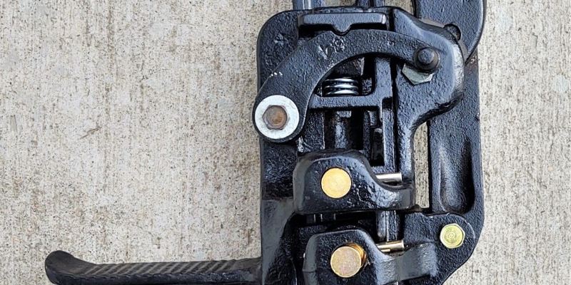

Drahcir495 Posted December 25, 2024 Share Posted December 25, 2024 This is maddening. Such a simple design, but I can't get the stupid thing to work . It won't go up or down? All the mechanisms have been soaked in WD40. I have never had to use it, so I'm not ever sure if I'm working it correctly?? Link to comment Share on other sites More sharing options...

AeroNautical Posted December 26, 2024 Share Posted December 26, 2024 There should be a lever on the side with a "notch" like shown. When placed upward into the notch, moving the large handle up and down should raise the jack (full travel of the handle). Moving the lever down (I would kick it, don't trust your fingers near it with a load) will lower the jack with the large handle, also moved up and down. I believe it needs to be in the lower position to freely move up and down. It's easy for one to get away from you, or slip. They can be dangerous, like Pete said. Link to comment Share on other sites More sharing options...

Drahcir495 Posted December 26, 2024 Author Share Posted December 26, 2024 21 hours ago, AeroNautical said: There should be a lever on the side with a "notch" like shown. When placed upward into the notch, moving the large handle up and down should raise the jack (full travel of the handle). Moving the lever down (I would kick it, don't trust your fingers near it with a load) will lower the jack with the large handle, also moved up and down. I believe it needs to be in the lower position to freely move up and down. It's easy for one to get away from you, or slip. They can be dangerous, like Pete said. Thank you - I will give that a try in the morning Link to comment Share on other sites More sharing options...

derf Posted December 28, 2024 Share Posted December 28, 2024 Keeping them clean is a key. The soaking in WD-40 can attract dust and dirt. That dirt will jam the pins enough to keep it from working. Thoroughly clean it and apply a dry lubricant and it should work fine. Link to comment Share on other sites More sharing options...
Drahcir495 Posted January 1, 2025 Author Share Posted January 1, 2025 On 12/28/2024 at 8:44 AM, derf said: Keeping them clean is a key. The soaking in WD-40 can attract dust and dirt. That dirt will jam the pins enough to keep it from working. Thoroughly clean it and apply a dry lubricant and it should work fine. Ah yes - thank you Link to comment Share on other sites More sharing options...
