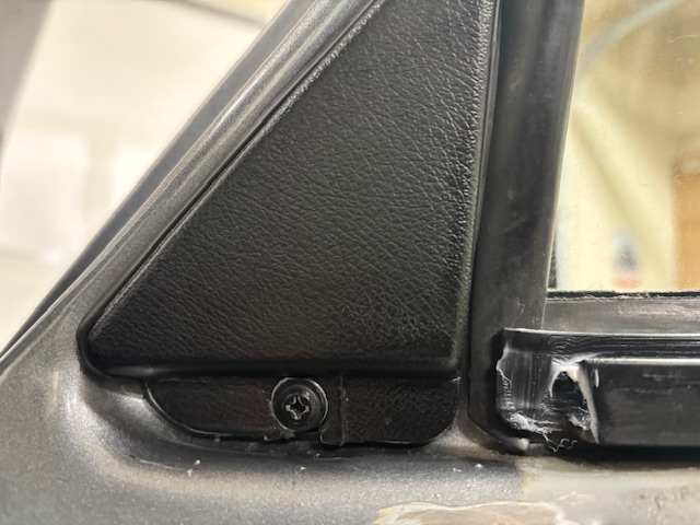

On 1/7/2026 at 5:34 PM, Gjeep said:
I split the difference between the new and the old-style seals, using a 3M weather stripping near identical to the ‘97+ XJ cowl to hood seal. It fits well and looks OEM.
Excellent work!
If you have a link to the 3m weatherstripping you used on the a-pillar, that would be excellent! :beerbang:
Went with the 97+ XJ windows on this MJ also. I prefer the cleaner look/ less complexity. The lower window trim is the first gen with long long ago purchased Beijing XJ window wipes as I could never find in the States a supplier of this style wipe that you could buy in bulk length or anything close that would fit. Believe me, I looked. The first gen 2-dr wipe is unfortunately too short...and I don't like the 97+ style wipe/ trim piece. This MJ gets power exterior mirrors also.

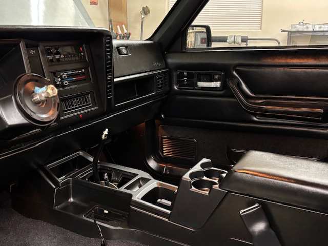

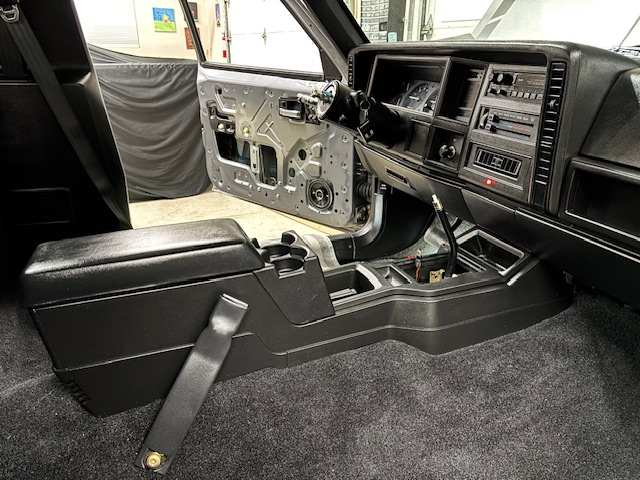

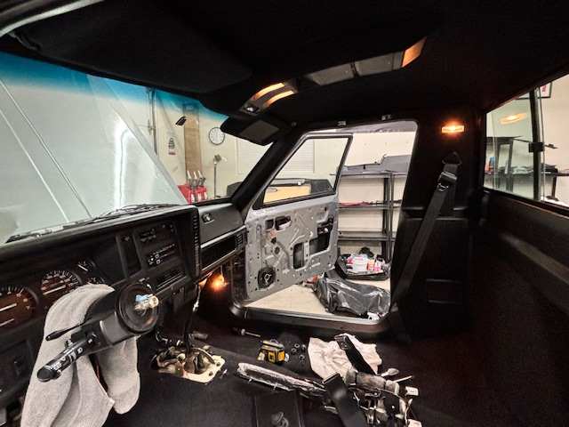

Center console is in, complete with under the lid BT hardwired aux connectivity/ phone charger combo. Lower dash panel also in place. Chemical Guys Satin Shine Protectant on everything.
No doubt there’s many better functioning cupholder setups for the first gen console these days thanks to the 3D printing world, but this one looks right. And I’ve never had issues with canned drinks. One thing I’ve always done since my ’86 XJ back in high school is put door edge guard around the middle area the hand brake comes up as I don’t want to gash up the new ebrake assembly should I use it.

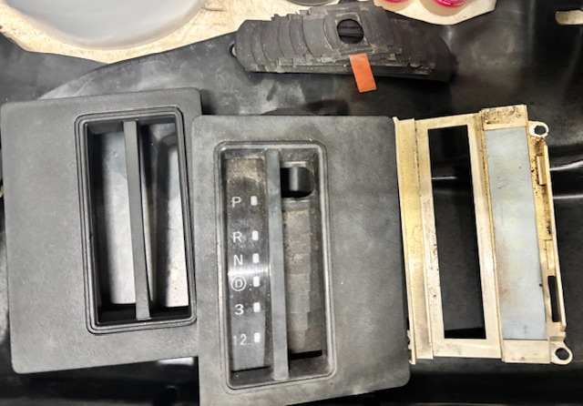

Finally, upcoming project is disassembling and refreshing the console gear select bezel. I have 3 of them to cobble together one good one. After that, door panel installation.

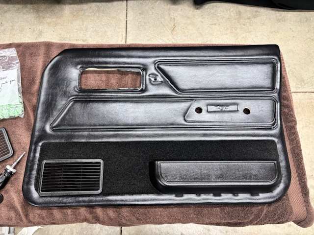

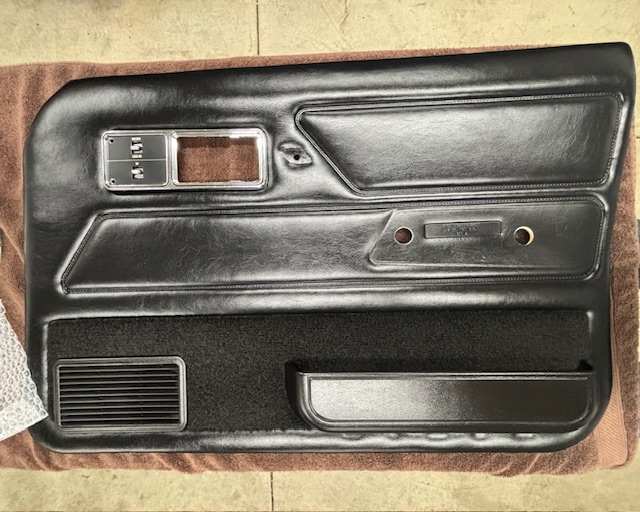

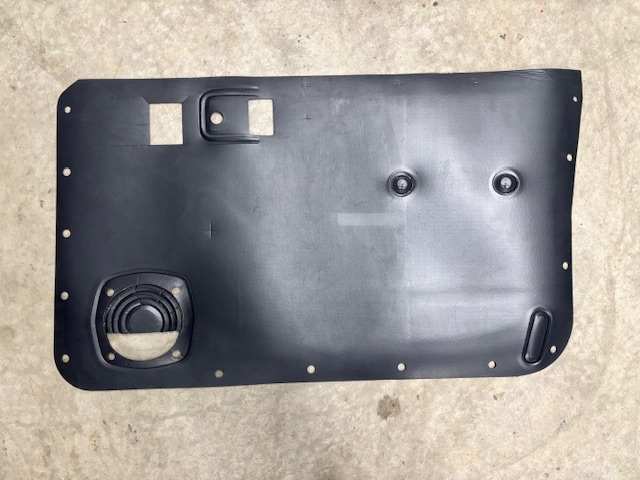

Door panels are reassembled and vinyl conditioned prior to install. This is passenger side.

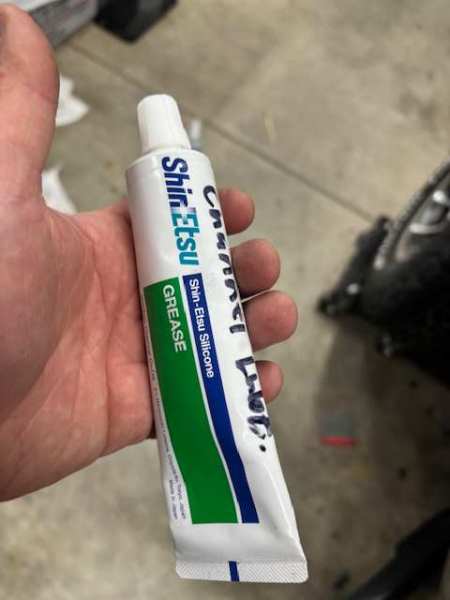

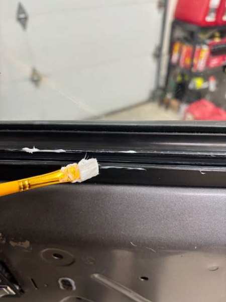

I use channel lube to put under the inside mirror cap and inside the rubber channel the door panel hangs on in the hopes of if I ever need to remove it doesn’t get stuck (risk of vinyl tearing). This brand lube is hands-down best as it’s not oily/ runny. Toyota and Honda use it during their factory assembly and I’ve had good luck with it.

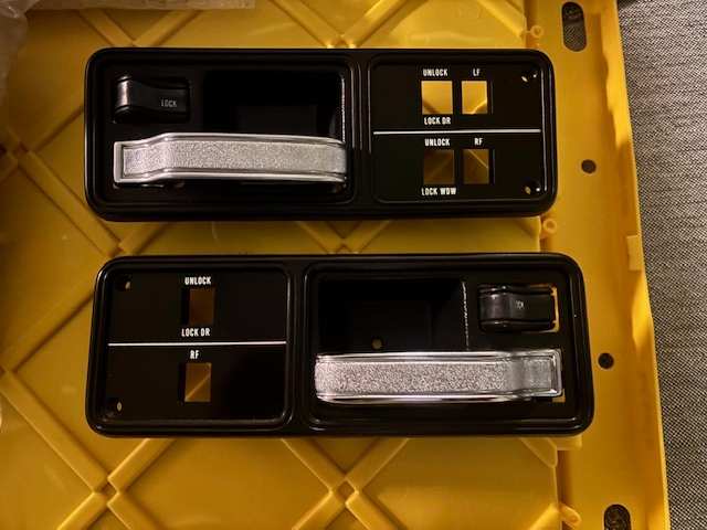

I was deciding between chrome and black door handle/ switch bezels… Going with black to keep things sinister. While going through parts, I unearthed these assemblies I put together back in 2001. Forgot all about them. Originally planned for these to go on my red MJ. Crazy how long ago that was.

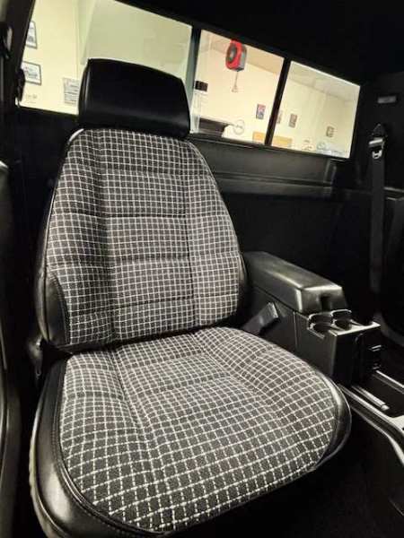

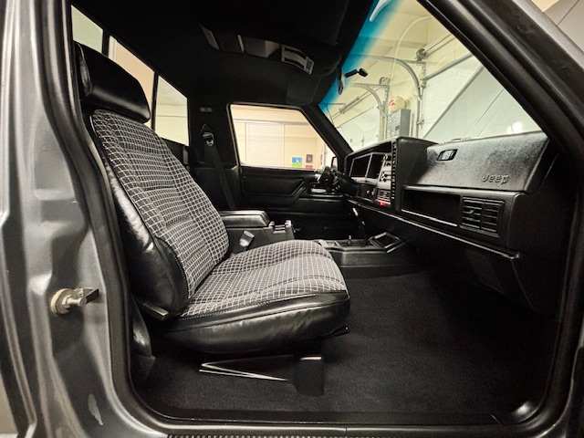

Black Mesa fabric seats are going in. These are XJ variants of the buckets, as they don’t have the upper strip of carpet as factory MJ seats do. I prefer this style with the full vinyl surround. As for the flooring, I went with Husky slush mats as they come molded in black and fit well.

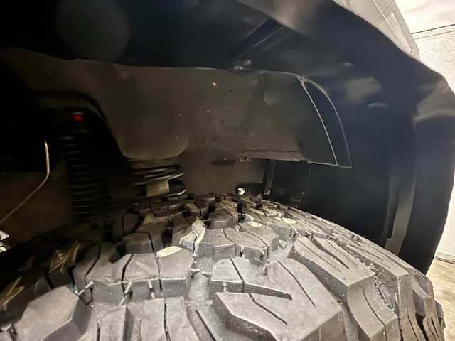

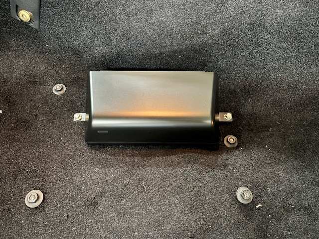

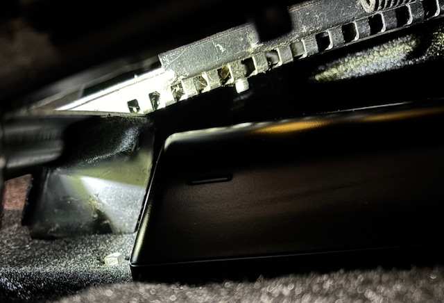

Some pics of Pioneer compact sub under the passenger seat. Fit is perfect and sounds great – not competition thump but rounds things out very well. The front of it has about 1/8” before touching the seat bracket mount backside.

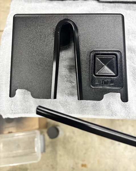

From 2 to 1… Drilled out, cleaned and refinished. Always takes a little bit of doing. Fun fact: the very very early assemblies were screwed together and much easier to disassemble (but difficult to find).

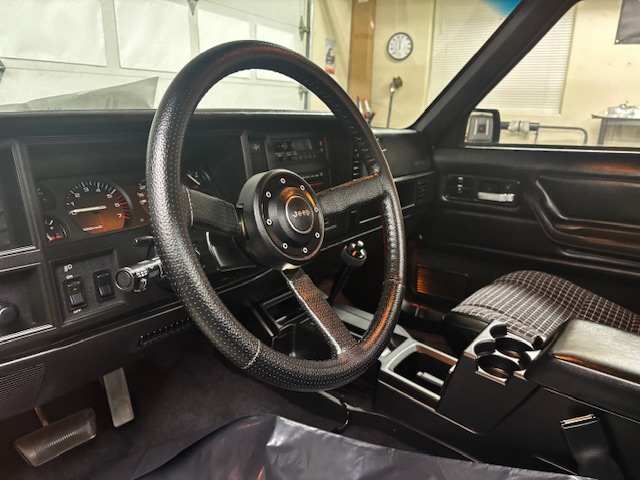

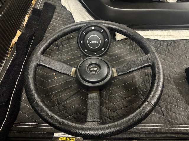

Moving forward after a week away… Black leather Omix-ADA steering wheel is in with XJ Renix era horn hub in place. Just looks better than the HO era smooth hub. Has character.

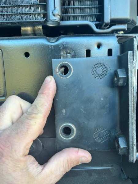

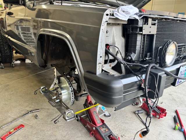

With the airdam in place, it was time to install the tow hook assembly. It’s rare when installing factory tow hooks that a drill is not needed on the front crossmember holes to get them to line up to the reinforcement bracket. This Jeep was no exception. The passenger side was for the most part lined up but driver side top was off.

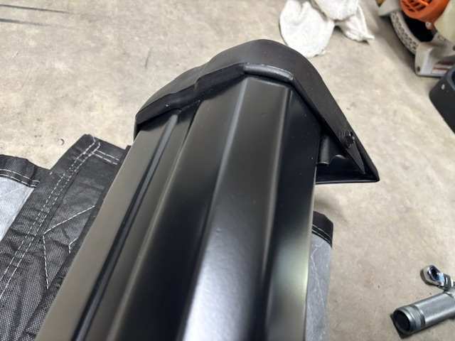

Since this Jeep will be my daily driver, I opted to refinish a straight factory front bumper versus running a new one. Keeping with that theme, I chose Crown end caps instead of NOS Mopar. I was impressed with how easily it installed and to proper shape the passenger side end cap was (pic below). As I moved to the driver side I was thinking – wow, the aftermarket parts have come a long way in fit/ finish. Then the top hole of the driver side was a whole 1/4” off, while all else lined up. Easy enough to carve back the top-side hole but would take much to get it right in production.

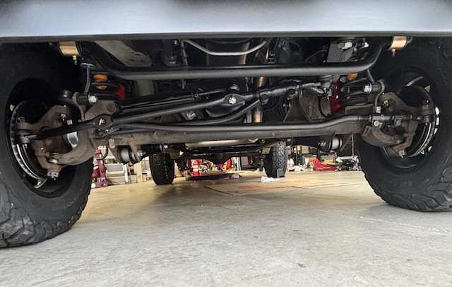

Time to finish up the front suspension and align it.
Got the front suspension finished up, complete with alignment.

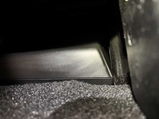

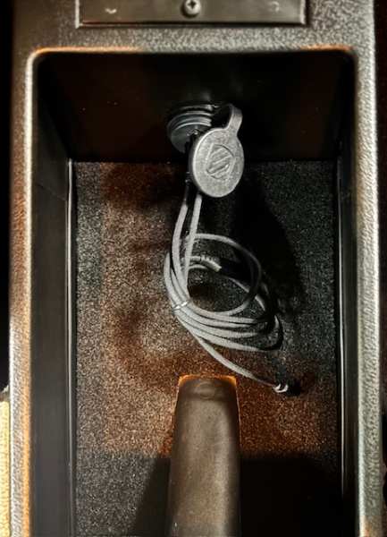

Inside the center console is the hard-wire connectivity if desired for the BT set up. And to keep things from rattling around, trimmed an insert for the bottom side.

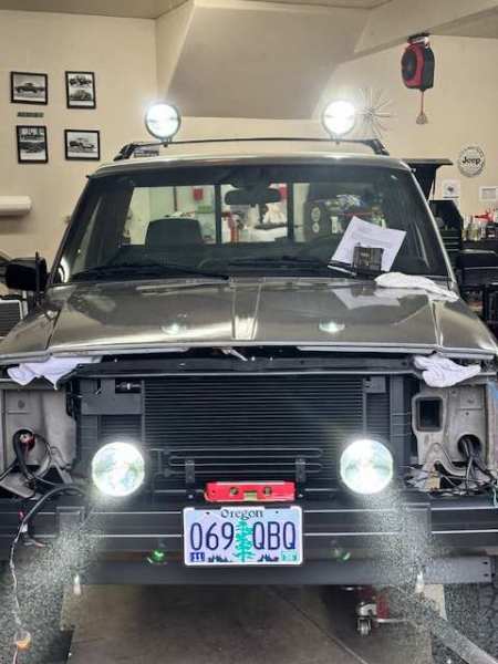

Got the Holley RetroBright’s installed. For those thinking about going this route – two thumbs up. Crazy bright – I went with the 5700K option and followed up with matching 5700K bulbs for the driving lights. I also have these on my red ’97 XJ and for those who aren’t familiar with the ‘97+ XJ, the headlight buckets are a different design than the first gen. The later XJ buckets (red paint pic below) allow the Holley headlights to mount up properly; for the older MJ/ XJs the first gen buckets aren’t as deep so the Holley’s sit 1/8” forward. Don’t really notice it visually.
