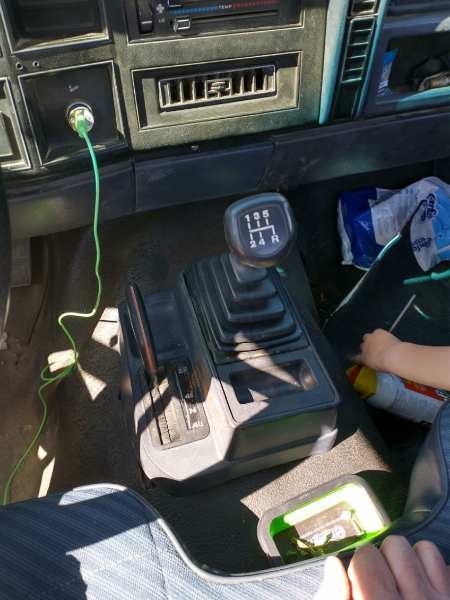

JZLAJeep Posted May 3 Author Posted May 3 Today was the long awaited day that the console was finally re-installed. It's only been 18 months since I asked the question after all... Put extra layers of the flooring (about 1/4" thick) under the flooring to close the aforementioned gap. On the driver's side it took about 8 layers, but we got there. The picture wasn't taken in the best light. Will try to take another one later.
