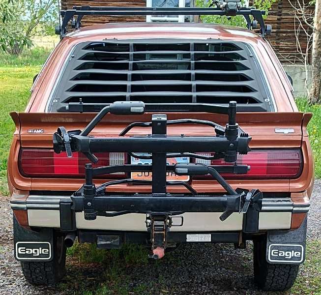

Eagle_SX4 Posted May 7, 2025 Author Share Posted May 7, 2025 Got a set of factory mud flaps put on the back. Link to comment Share on other sites More sharing options...
89 MJ Posted May 7, 2025 Share Posted May 7, 2025 Those look great! Link to comment Share on other sites More sharing options...

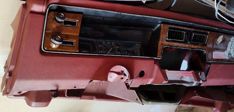

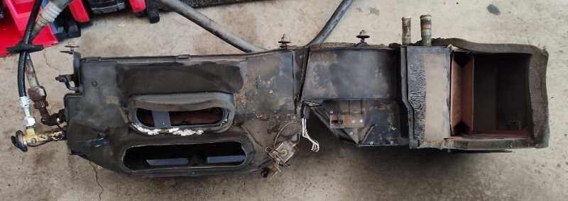

Eagle_SX4 Posted June 21, 2025 Author Share Posted June 21, 2025 Huge win at the junkyard this weekend. I picked up a clean non cracked dash and ac/heater box with controls. I will finally have ac in the car. I need to get a compressor and condenser and wire up the switches.I will paint this dash black and get it installed with the new HVAC box hopefully later this summer. Link to comment Share on other sites More sharing options...
89 MJ Posted June 21, 2025 Share Posted June 21, 2025 Must not have been an Eagle dash, unless it was a 119 rig. Was it from a Concord or a Spirit? Link to comment Share on other sites More sharing options...

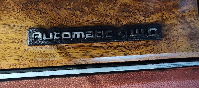

Eagle_SX4 Posted June 21, 2025 Author Share Posted June 21, 2025 1 hour ago, 89 MJ said: Must not have been an Eagle dash, unless it was a 119 rig. Was it from a Concord or a Spirit? I pulled it from a 1980 Eagle 4 door sedan. NP119 full time transfer case with no shifter switch on the dash. Not a big deal I just need to cut a square hole for the switch. Link to comment Share on other sites More sharing options...

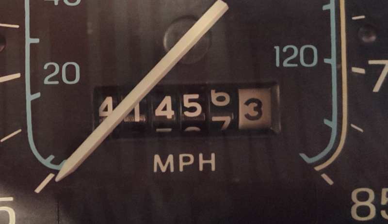

Eagle_SX4 Posted June 21, 2025 Author Share Posted June 21, 2025 Only 5 whole digits on the odometer and AUTOMATIC 4W.D. Link to comment Share on other sites More sharing options...
89 MJ Posted June 21, 2025 Share Posted June 21, 2025 18 minutes ago, Eagle_SX4 said: I pulled it from a 1980 Eagle 4 door sedan. NP119 full time transfer case with no shifter switch on the dash. Not a big deal I just need to cut a square hole for the switch. Gotcha. I figured it either had to be something like that or from a 2wd car. Link to comment Share on other sites More sharing options...

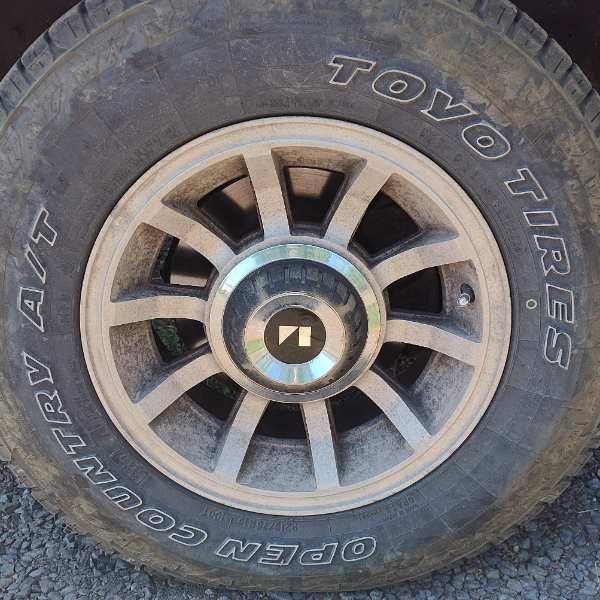

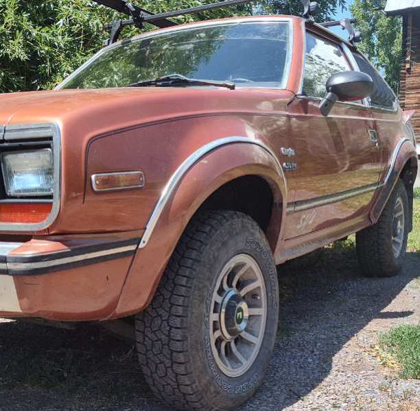

Eagle_SX4 Posted June 27, 2025 Author Share Posted June 27, 2025 Finally got the hub caps stickers made. I might paint them as the painted section is faded but they came out really good. Link to comment Share on other sites More sharing options...
eaglescout526 Posted June 27, 2025 Share Posted June 27, 2025 Oh yeah! That looks classy. Link to comment Share on other sites More sharing options...
Pete M Posted June 29, 2025 Share Posted June 29, 2025 looks fantastic! Link to comment Share on other sites More sharing options...
