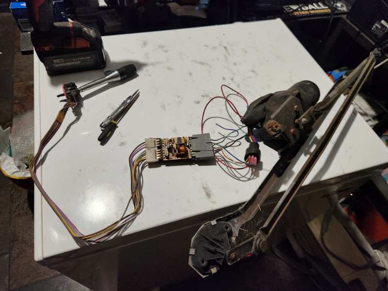

The86manche Posted May 16, 2023 Author Share Posted May 16, 2023 Getting them going! Got one done for testing, going to get a few ready to test tomorrow Link to comment Share on other sites More sharing options...

The86manche Posted May 16, 2023 Author Share Posted May 16, 2023 I got two ready for testing and decided to crack open the worst module in the bunch. One of the ones cruiser sent actually.. and crack open it did. The case was so brittle it cracked apart. So will have to look into options for a new case. Link to comment Share on other sites More sharing options...
The86manche Posted May 16, 2023 Author Share Posted May 16, 2023 I have confirmed 2 working modules! I have roughly 1 minute long videos showing both in action. Truck was not running because I'm working on it so slow settings were.. slow. But they worked. And the higher the setting the faster they intermittently wiped. Link to comment Share on other sites More sharing options...
