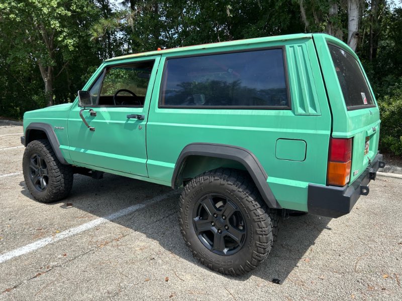

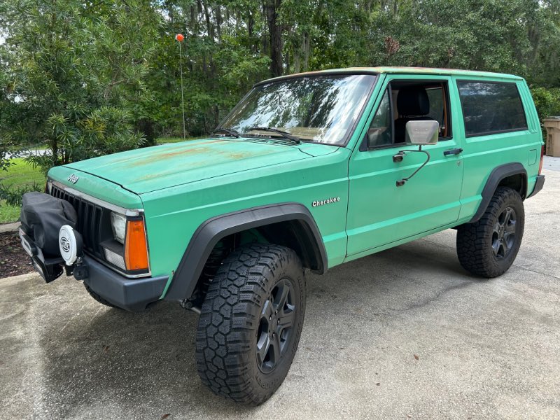

Greenjeans Posted August 1 Author Share Posted August 1 Swapped out to some different JK wheels rattle canned black and 31” tires. My suspension is nice and soft so on the highway my rear tires now just barely kiss the flare if I hit a big dip in the road. It rides and drives so good. I really don’t want to lift it anymore. I might get away with a 1 inch block or something. I think I will just very lightly trim the bottom of the flare in the back where it’s rubbing. Link to comment Share on other sites More sharing options...

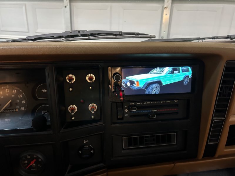

Greenjeans Posted August 4 Author Share Posted August 4 I finally broke down and replaced the junk yard Pioneer stereo with something high tech. I can’t believe I paid $25 for that junkyard stereo lived with it for so long and this thing was only about $70 and is like going from an old Volkswagen to a space shuttle. It has Apple CarPlay with navigation although I probably won’t use it much. The sound difference is amazing. I was able to put a picture of the Jeep on for the start up screen picture/logo. I can call the Mrs. from the front seat using the microphone, which is kind of cool. I have a 1986 remember so my dash might be different than yours. I had to trim about a 16th of an inch with a Dremel on each side of the radio hole. Other than that, it goes right in it’s half the size of a factory radio, and weighs ounces. It’s also as a back up camera and I have not connected it yet. I can put it on my license plate bolt pretty easily if I want to use it. I have tried to cut and paste the Amazon link here, but it doesn’t seem to work 🤷🏼 Link to comment Share on other sites More sharing options...

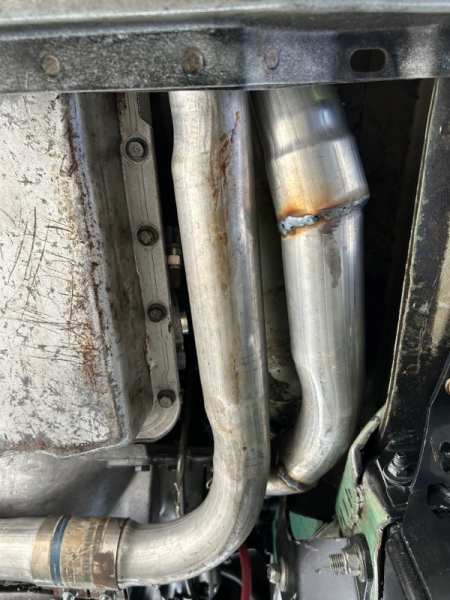

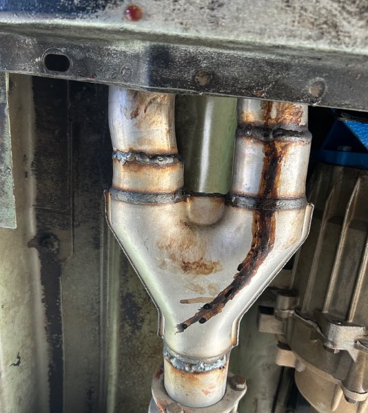

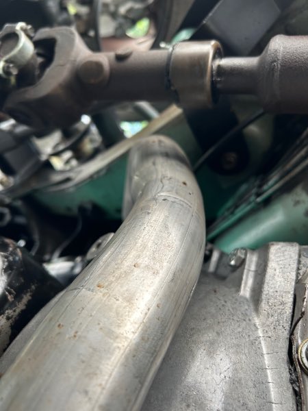

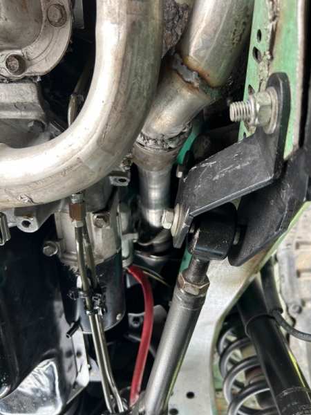

Greenjeans Posted August 15 Author Share Posted August 15 For you V6 guys…..I thought I would share my new “Y” pipe that I had made by an actual exhaust shop. The pictures may be tough with angle, perspective etc…. Also you can see a bit of burnt trans fluid (ignore that 😁). If you’ve been following along, you remember that I made my own Y pipe. It was one of the most challenging parts of this project. It was a horrible experience. It was cobble together from mostly junkyard pieces of pipe that have curves I cut them up and just made something that would work. It was on there for about 3000 miles and it did work but it had some issues. Mainly I could not get the transmission pan off Without dropping the pipe. Also, it’s too close to the front driveshaft. It was also too close to the trans pan and I thought there was some heat transfer. Anyway, I finally bellied up to the bar and paid an exhaust shop to make a proper front Y pipe and it is pretty much a work of art, considering the challenge of getting all this pipe up in there into a compact fashion. They used a couple band clamps, which I asked for so that I can take it apart to remove it if I need to. Other than that it looks close to a factory part. By the way, as far as I’m aware, you cannot order a new pipe from Walker or anywhere else. So you’re kind of stuck with making one. it took quite a few man hours, but they only charged me $300 which I thought was fair. edit- it has touched the front shaft just a tiny bit but not enough to get it exited 😳 Link to comment Share on other sites More sharing options...

eaglescout526 Posted August 15 Share Posted August 15 I love the use of a ford exhaust coupler in the build. Truly in AMC fashion. Link to comment Share on other sites More sharing options...
