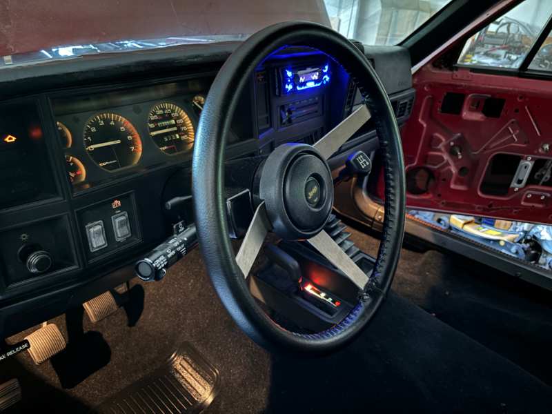

Off work from job 2 at 10PM, back on C100 TLC. LF turn signal now working. Conditioned all the female pins. A1 was slightly boogered. Took a little time with all pins on both sides, hoping my other issues can only benefit from the effort.
Tall boy shifter stick from a TJ. I kinda like it. In first it sits at 3:00 from the wheel about 4" away. The tall AX15 shift tower IS from a TJ so it's a shorter throw already.

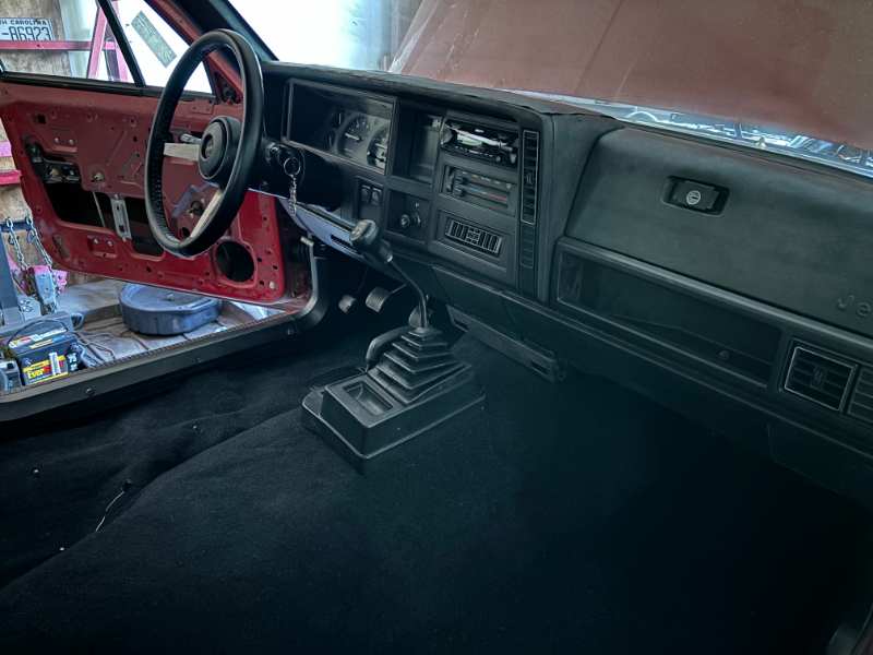

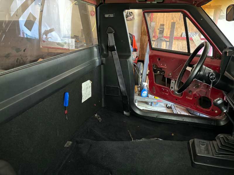

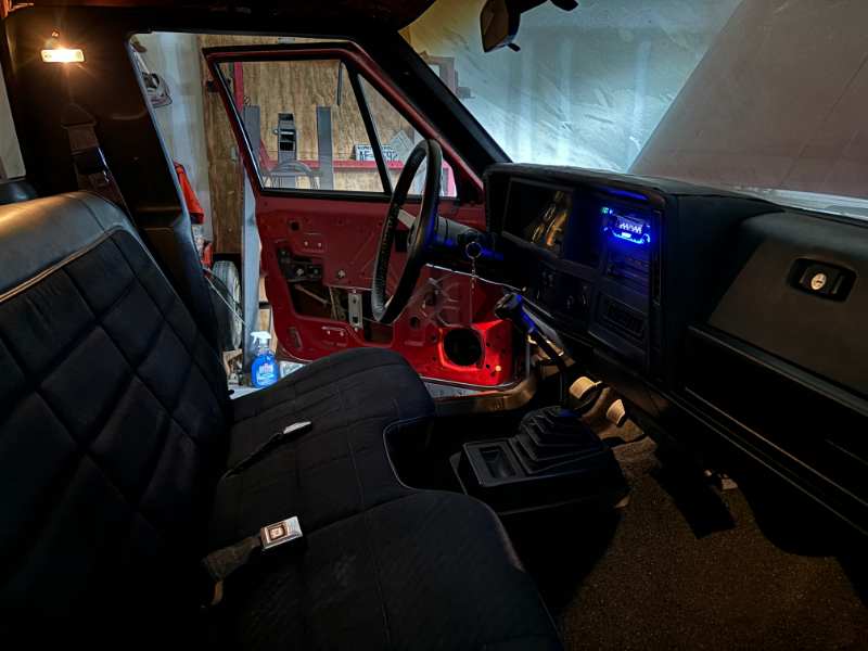

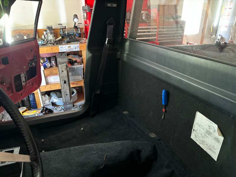

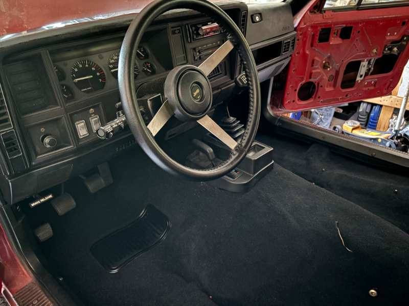

Carpet is in. I started the trimming at the front, just a little at a time until it lined up with the molded areas left and right. Then the sills, and rear last. I added a layer of 1/2" jute to all the areas the carpet didn't come with. Still have to install the rear corner trim/ seat belts and rear panel/ upper trim. And work the headliner in there while I'm at it. Really need to vacuum before I go any further lol.

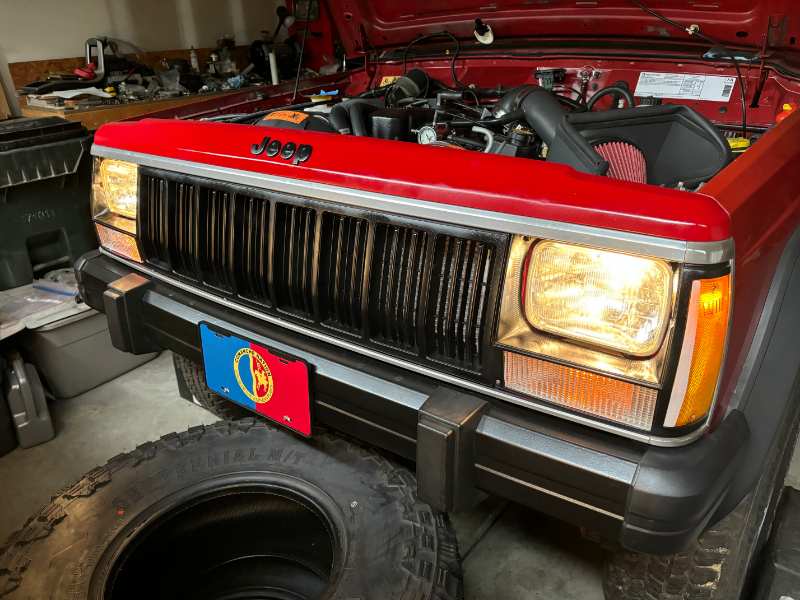

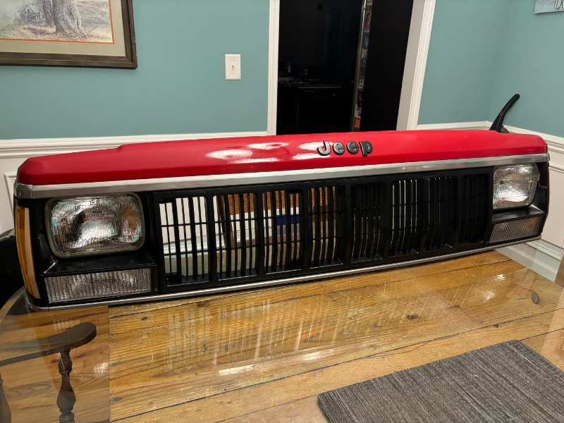

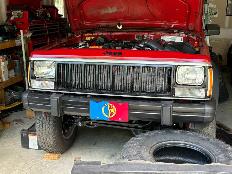

Header panel stripped, cleaned and reassembled. O'Reilly-mixed Colorado Red in a rattle can worked pretty well to put some color back on it. It was pretty beat up. There's a deep enough crack above the Jeep logo that's going to have me looking for another header panel at some point but it's fine for now. The 10-slot grille is long gone but I don't mind the look of the 8.

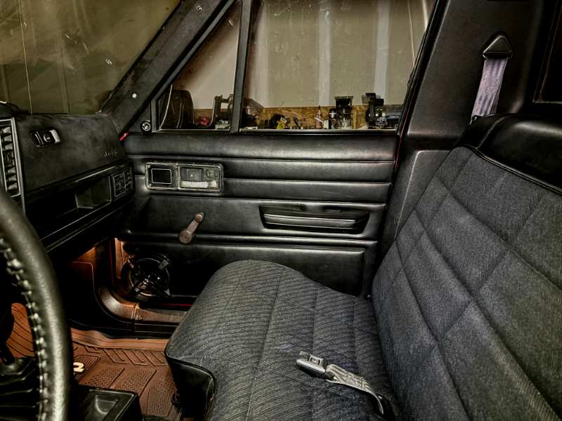

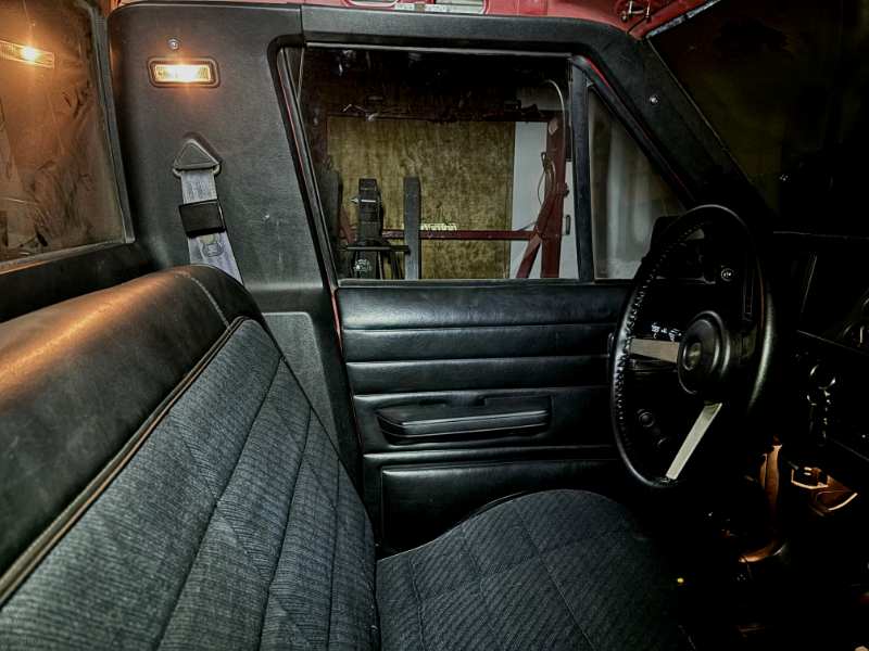

Header panel is on, all lights work (yay). Bumper needs to be adjusted up and tightened, lower valance needs a clean before going back on. Interior is complete except for headliner, bench seat and visors, which hopefully I can knock out tomorrow. Doors will be their own thing, side-project. The regulators need some maintenance and cleaning. Door cards are in great shape. In the next week, I'll be onward to rear suspension. Also need to get those 33s mounted on the steelies ASAP.
Seat brackets cleaned up and painted. Spent some time with the Bissell Green Machine on the seat fabric and it came pretty darned clean.
Bumper is adjusted and secured tightly now.

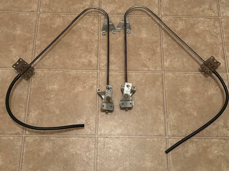

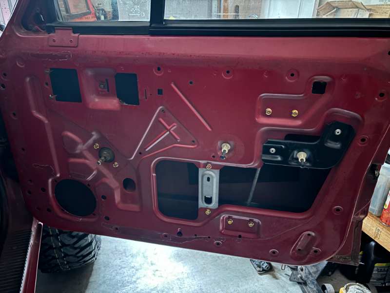

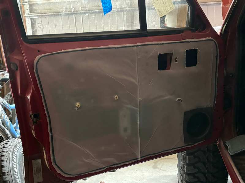

Passenger side regulator had dropped its receiver tube and there was no way I was going to get it back on the barbed end without pulling it. A little heat to soften it and I got it back on there. Followed instantly with ice to shrink and bond it as best as possible. I pulled the other one and greased both with synthetic grease. I don't know if that's a no-no, but the difference is amazing. Before they were both loud and very stiff. The ideal fastener to reinstall them would be stainless or yellow zinc M7-1.0 x 10mm ~or~ 9/32" x 1/2" but good luck finding those without having to wait a day or two at Fastenal or Amazon. Next best is 1/4"-20 x 1/2." With either nylon locking nut or prevailing torque nut on the back. The original rivets spin when you drill them, so you have to hold the back side of them with pliers while you drill. The nut to release the glass is 18mm. There's a wave washer under it.
Passenger side regulator and both new door locks in. Missing half the regulator fastener hardware for the driver's door, but I'll pick that up from job #2 at 5:00. Taking the driver's door lock out, I noticed the short rod attached to it was disconnected from the latch assembly and there was electrical tape around it. And... the one at the lock cylinder was also taped and partially destroyed. Fortunately, I had a couple compatible rod clips left over from door work on my C1500 a couple years ago. All back together and works like it should. Passenger door, ready for panel:

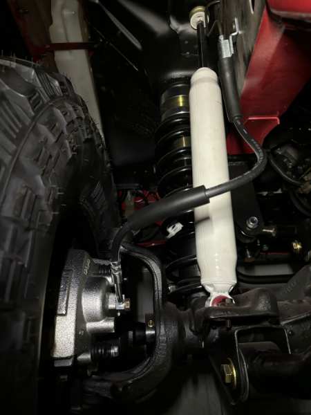

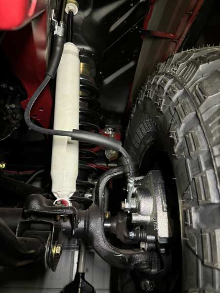

Front brakes installed. This is a PowerStop kit for 1999.5 XJ with cast rotors. Had to make a run to the boneyard for banjo bolts. Snagged a pair from a 97 V8 ZJ and another from an 06 Grand Cherokee. Exactly the same bolts all the way back to 91 apparently. Hoses are from Autozone - 777848 and 777849, 22" OAL. Pulling apart the rear brakes today on lunch break from job #1.

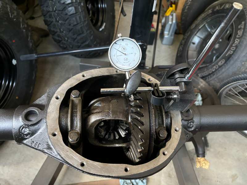

D35 (non c-clip) is out. It needs carrier bearings and axle bearing kit. Pinion bearings and seal have been replaced not too long before I got the truck. Preload is good, bearings are smooth and seal is in good shape with no leaks. Axle splines are straight, axles look good for what they are. Running what I got until something else presents itself.

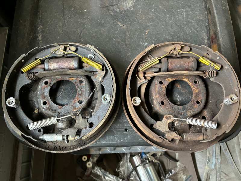

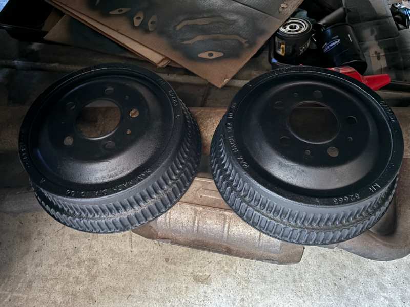

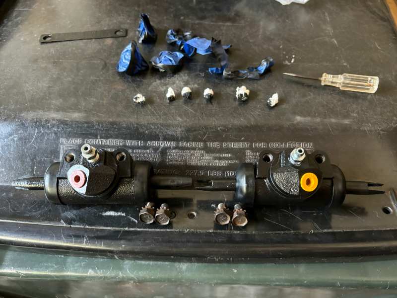

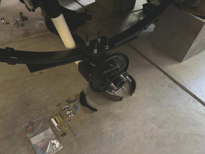

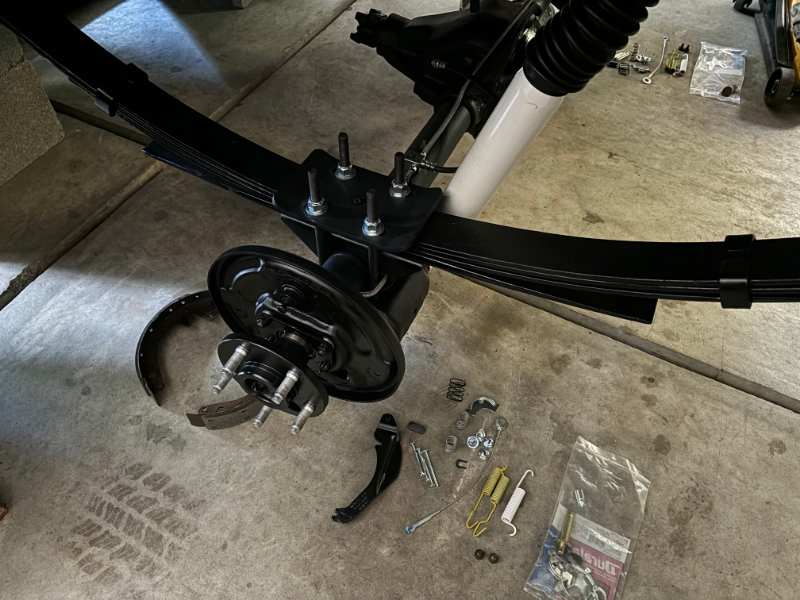

Rear brakes aren't awful, but I have all new hardware and shoes anyway. And an opportunity to clean and re-paint the backing plates.

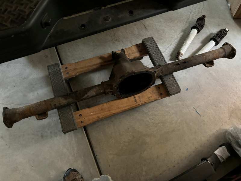

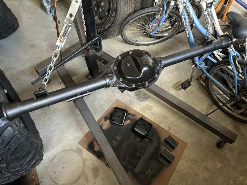

Only update from the weekend- D35 housing is cleaned up. Base coat of Por-15 topcoat, followed by undercoating. Inner tube seals are on the way, carrier is at my machinist in Raleigh getting new bearings. Axle bearing kits may take another week to show up. I plan to have the housing back in SOA with the new leafs (leaves?) this week, with just the axles to go.Then I can take measurements for the rear driveshaft.

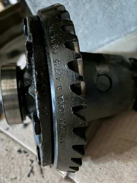

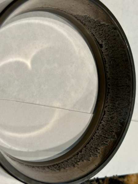

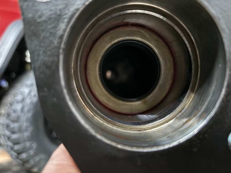

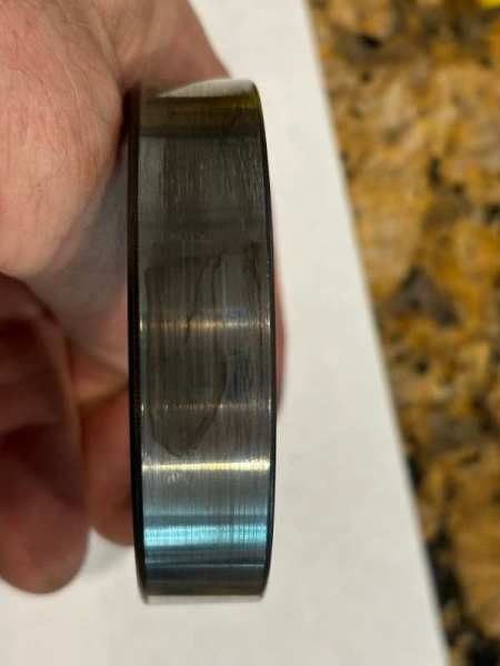

In a holding pattern for the most part. Got the rear brakes blown apart so I can clean and paint the backing plates. Doing a little cleanup, I noticed this on one of the carrier bearing races. :eek:
The carrier didn't have any discernible side-side play when I pulled it but there was obviously no preload, hence the decision to replace the bearings. Glad I didn't roll the dice and just run it. It'd have burned up good in no time...

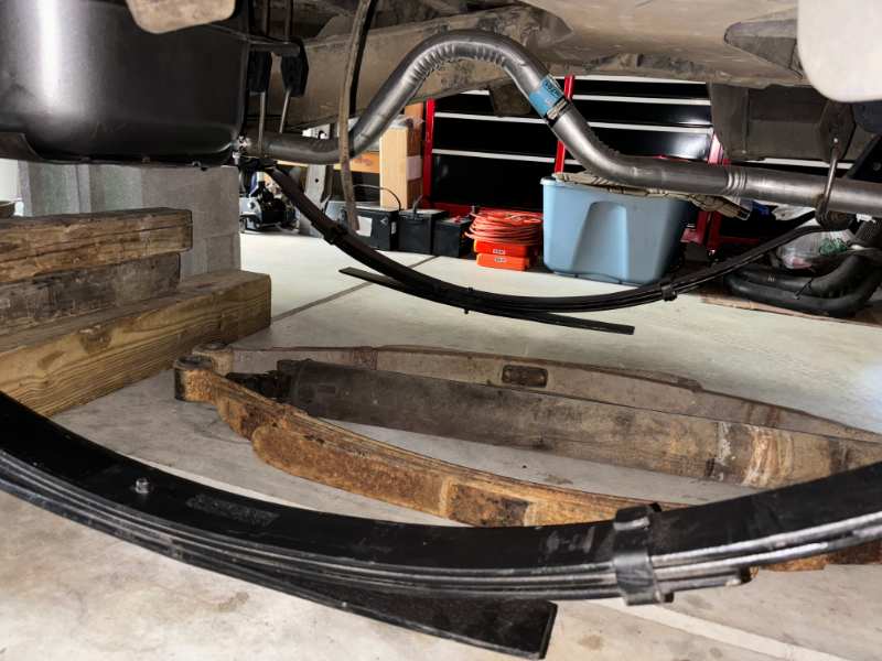

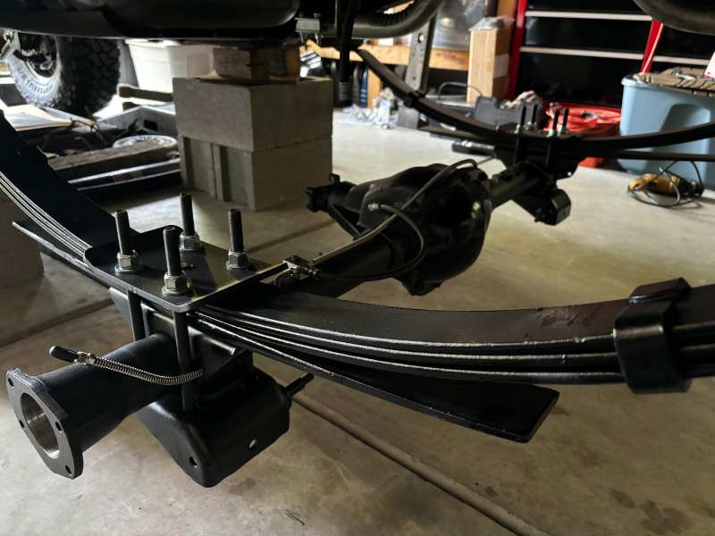

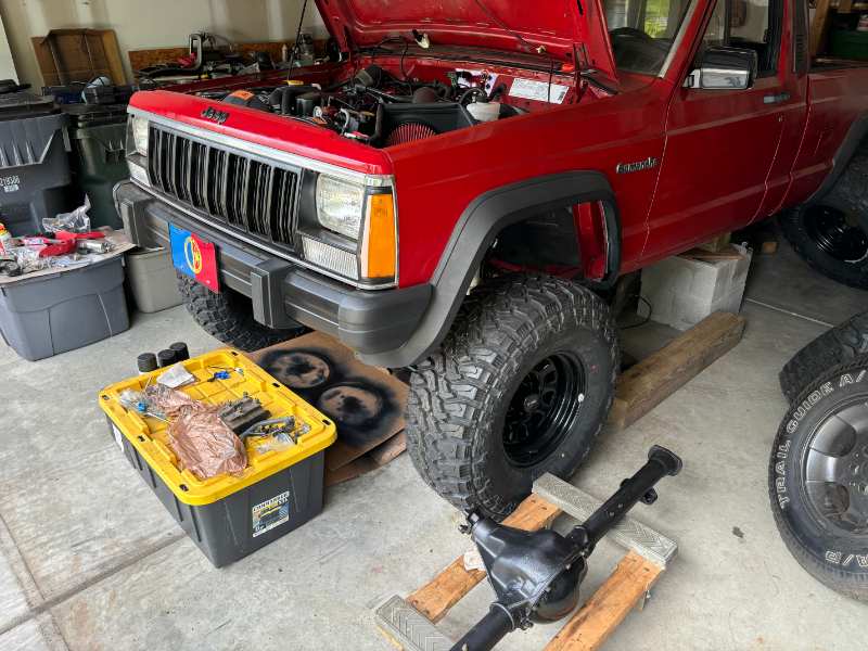

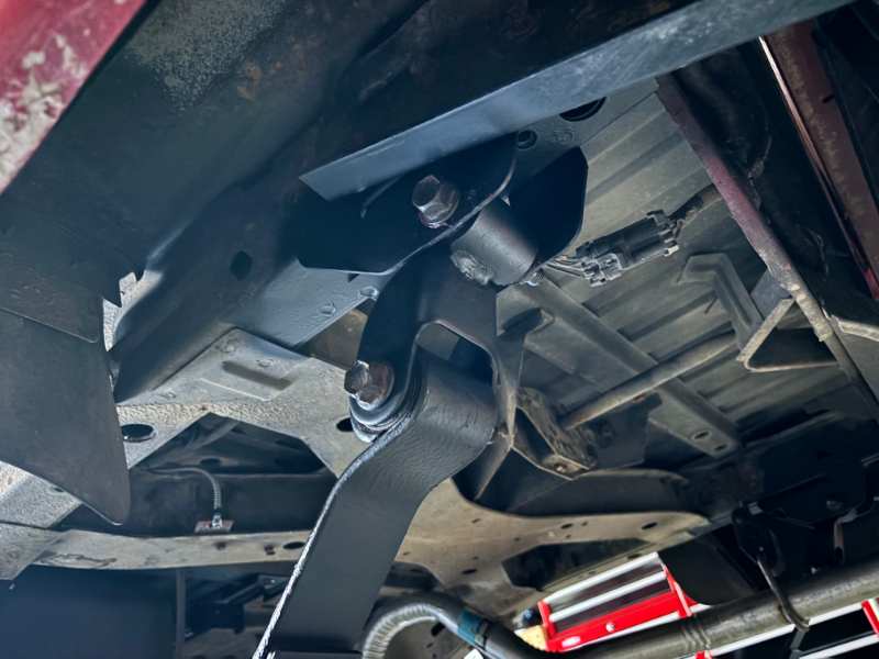

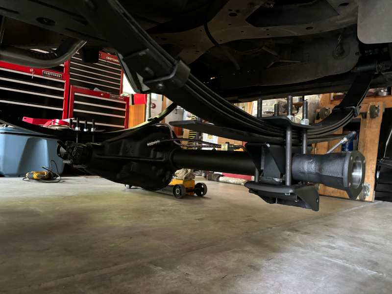

Leaf springs installed (General 97-555). I picked up a cheap set of Chevy drop shackles for the moment so I can work on settling the springs. The temporary shackles will net 1.5" lift. If 5.5" SOA, this will make 7" give or take. Front is 6.5-6.75" right now. Something adjustable/ boomerang after that.
SOA is in. The temporary shackles I put on showed way too high in the back far beyond what it'll settle. So I threw the original shackles back on. I'll need a 24+" rear brake hose to accommodate full droop. And the axle vent tube is 6-7" too short as well. Wheel stud installer broke on the 3rd stud... I'd hoped to get it all back together yesterday. Working on Volvos again today, so it'll have to wait a day or two.
