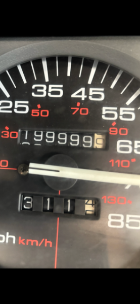

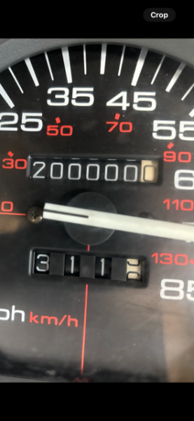

Since I started driving CommuteChe, I’ve kept an eye out for a full dash in decent shape, with mileage near mine. When I ordered this dash, it had just over 900 more miles then what CommuteChe had on it at the moment. With just commuting, I do 500 miles a week, plus running the kids around, etc, etc. The mileage racks up quickly.
Luckily it worked out perfectly with the miles driven and delivery of the gauge. Got home tonight and the gauge cluster had been delivered. Did take just a little bit of effort, but I got the mileage to match on both clusters. 3C1E7A72-BE0F-4AED-811B-2CFF6835C810.jpeg.7dbd1559c674c09c35d7e367e897a9c6.jpeg935658BE-F2C4-405B-B9ED-B61DAC9325A9.jpeg.0c74c7f71884cd7d840eb1f0b853679d.jpeg
138,954.7 Miles each.
