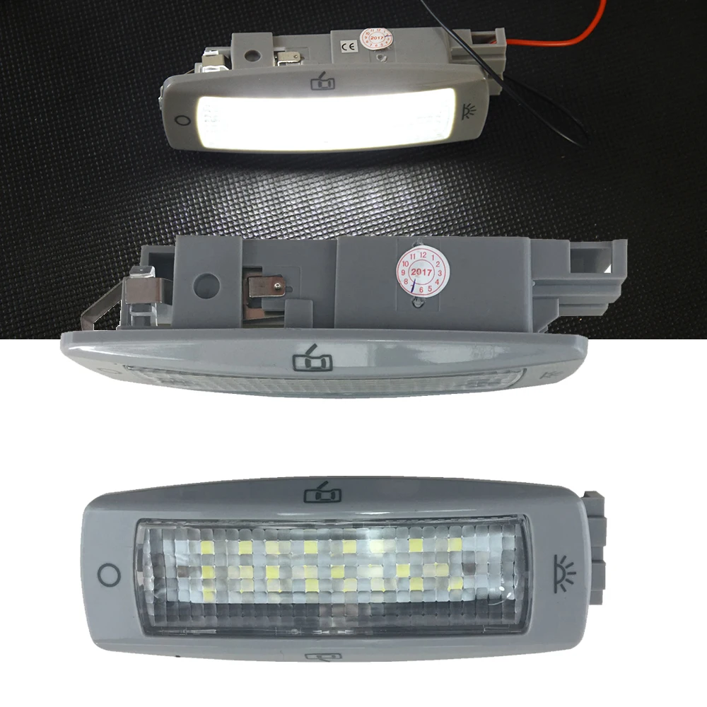

Epplebee Posted June 16, 2020 Share Posted June 16, 2020 While looking some things up about the pillar light I came across someone who used VW courtesy lights so I went ahead and grabbed me a set for each MJ at the local pick a part. Not realizing it at the time both sets had different retaining clips. I know i grabbed a set from a newer Passat and a set from a newer Beetle. Both have the exact same part number but different clips. What I really like about them is other then modifying the wiring, the snap right in with no other modification. Here are the 2 different retaining clips, part number, wiring schematic (don't mind my horrible drawing) and the end result. Link to comment Share on other sites More sharing options...

MercManche Posted December 30, 2020 Share Posted December 30, 2020 Dude, this was an awesome idea. They really snap right in!!! Firstly. These are all the common VWs you can get these out of, they are the rear passenger ones: 1999-2010 Beetles 1998-2006 Golf 1997-2005 Passat The way I am going to approach this, is to buy the LED versions (Knockoffs) and paint-match them. Here is a link to it, if the link is broken in future just search "3B0947291 Dome light LED" I will be going this route and will update with photos once its done! Link to comment Share on other sites More sharing options...

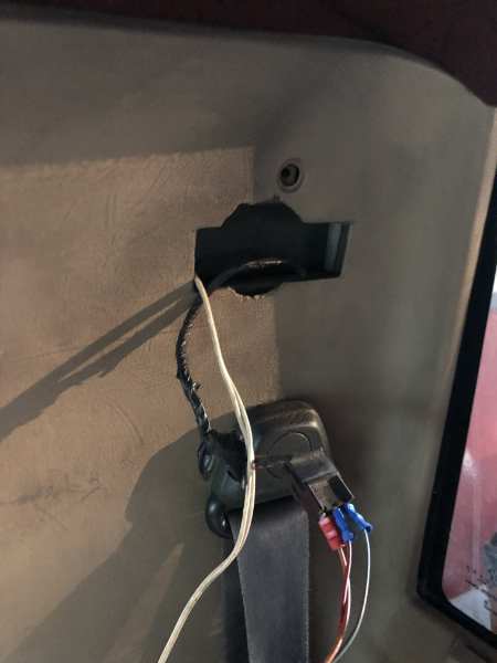

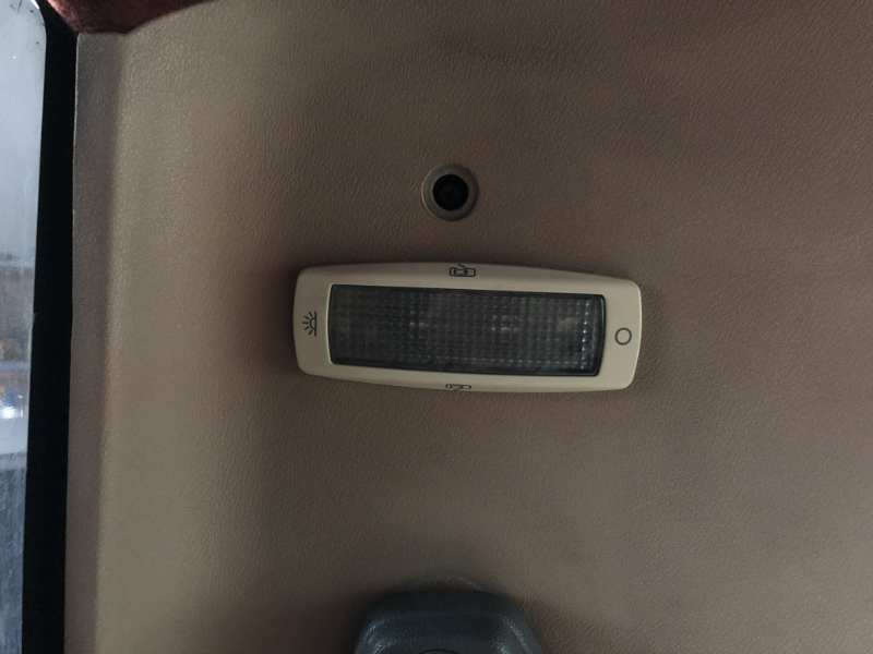

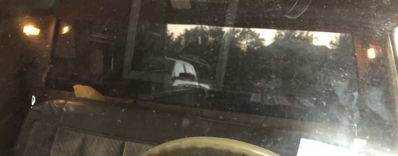

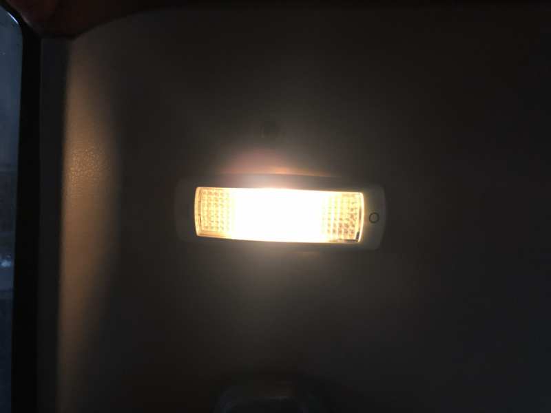

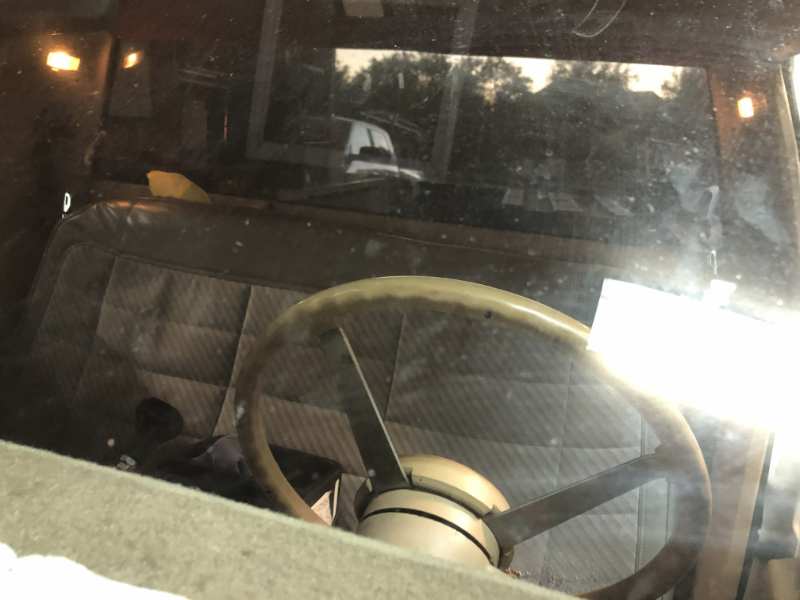

TX_Heat Posted November 15, 2025 Share Posted November 15, 2025 I finally made my way over to the VW section of the PNP today and grabbed a set of these lights after having this saved for the last few months. Very happy with the results as there are no longer holes in my pillars. Thank you to those who figured this solution out and shared it. I did crimp on spade connectors after reading about them in this CC post. They were also a PITA to remove from the VW and they seem to only install one way. Here are my results: Link to comment Share on other sites More sharing options...
