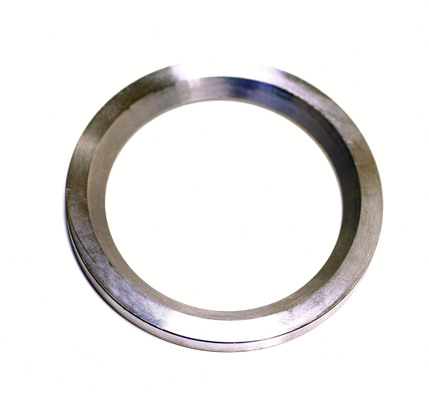

HOrnbrod Posted November 9, 2018 Share Posted November 9, 2018 52 minutes ago, 87MJTIM said: On the website, those part numbers do not show individual components. It shows the full set. Did you get a name for the sales agent? They don't show most individual parts and pieces from their kits; you have to talk to an agent to get them. The guy I always dealt with was Doug, extension 318. But that was quite awhile ago - he may be gone now or maybe even be the President of Teraflex now. Here's the spacer on Amazon. Link to comment Share on other sites More sharing options...

WahooSteeler Posted November 13, 2018 Share Posted November 13, 2018 These arrived today, and invoice in box was for less than quoted over phone......no tax! $282.98 including the spacers. You can see the rectangular bolt pattern vs the trapezoid shape pattern for the later model Jeeps. The sticker on the dust shield says F/JE and the invoice says "Ford Rear Disc Brake...." so these are for both Ford and "Early Jeep" models obviously. Part #s are 86311 for left side and 86312 for right side. #86262 is for the pre-load spacers needed. Link to comment Share on other sites More sharing options...
AZJeff Posted November 15, 2018 Share Posted November 15, 2018 When I ran into this issue, I took the "standard" Teraflex preload spacers and had the local machine shop turn the outside diameter down so they fit into the bore of the D44 axle housing. The shop charged me $20 for both. I had no idea Teraflex even offered alternative spacers. Wait until you get to the part where you connect the parking brake cables to the features on the caliper brackets. The Teraflex bracket isn't even CLOSE to the right dimensions to accept either an OEM ZJ cable OR the Teraflex aftermarket cables. The guys who designed that portion of the kit were REALLY asleep when the worked out those features!! Link to comment Share on other sites More sharing options...

JIMMYRIG Posted September 23, 2024 Share Posted September 23, 2024 Is the preload spacer supposed to sit inside the bore of the axle or just inside the backing plate? I ordered one from teraflex and am trying to install on my d35 non-c with junkyard zj backing plates. The OD of the spacer is larger than the ID of the backing plate and bore Link to comment Share on other sites More sharing options...
