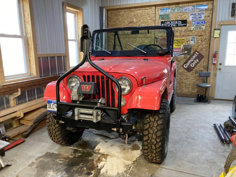

IT MOVES!!!
I need to bend around the shifters a bit, maybe figure some skid plates, modify the exhaust, and make some shifter boots.
I’m going to keep an eye on the transfer case output also. Might need to clearance just a bit if it ever gets to full droop.
Overall, I’m very happy with it right now.

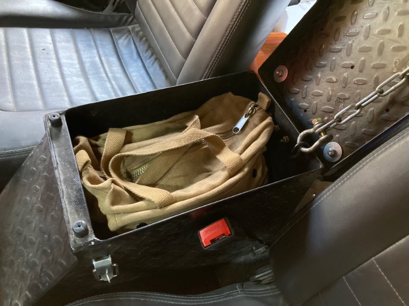

Got snowed in today so why not start on a center console?
I started with a sheet of 14 gauge with about a million layers of paint on it. Can’t say that I’m completely excited about the diamond plate, but I figure I’ve already got it on the outside corners like every rusty CJ out there. See… this was a freebie from a buddy of mine after he unscrewed it from a wall in his garage. He asked if I could use it a while back and instantly I thought center console.
The paint was fairly smooth and on there really good so I only took it off where I needed to weld. It’ll have some kind of cup holder big enough for a Nalgene water bottle on the front, I need to make a lid, and probably rework some of my seat mounts.
Then I hit it with a quick coat of black to hide the ugly gray, and then shoveled some more snow.
Pretty much finished up my Tuffy knockoff with another snow day off work.
I used a chunk of cow mat for the top and cup holders. If I don’t like the feel of the arm rest I’ll wrap it in vinyl or a canvas. Otherwise it needs a bunch of cleaning up and paint. I’ll wait for a nicer day for that.
