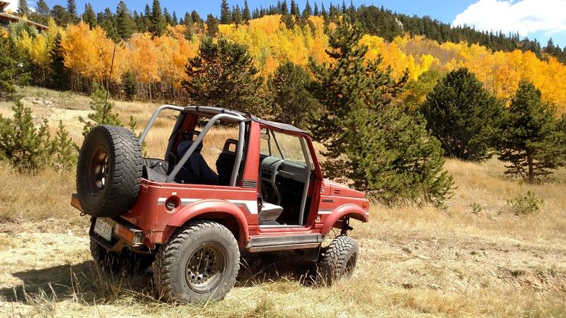

Ditto, the Sami's are super easy to work on and very simply built.  Not a real powerhouse though.  Adding a Sidekick engine to a Sami can add to that some.  Rust is a HUGE issue with those though, both body and frame.  I built a Sami from 2 that had issues, one clean body and the Sidekick engine, the other had lots of the off road drive train and bits.  When finished, very capable off road but damn did it ride terrible!  Very violent on rocky terrain and lack of power steering left my wrists sore after a day of trying to control the steering wheel.
IMG_20150924_124634437_zpsacdtvmvn.jpg~o
An early Chevy S10 Blazer or truck with the 4.3 V6 could also be an option as it has IFS and a decent drivetrain.  A 2dr Blazer with the top and doors removed and caged could be a hoot.  A standard cab short bed S10 could also be shortened after the cab and you could make a flat bed or use a drop side bed from one of those mini japanese "cushman" style vehicles, or make your own fairly easily.
Ok, so this pic is just to bring the phunnay........... :wink:
To expand on my thinking, I'm imagining a simple go-kart but on a slightly larger scale with more power.  Something I can thrash on like a quad or go-kart, but also have a practical use with the ability to haul things around.  Similar to yellaheep's pictures above but more tire clearance and much more stripped down.
