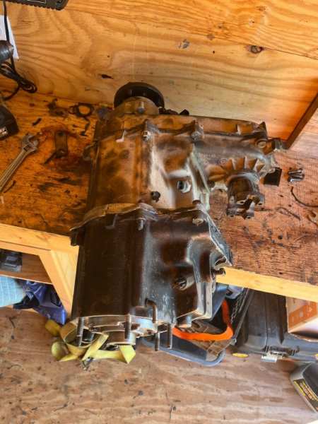

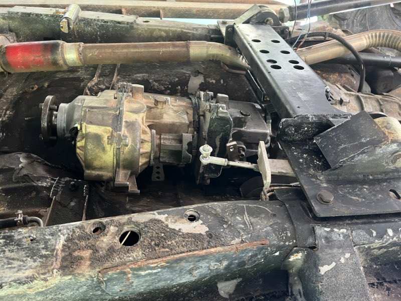

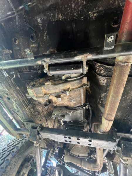

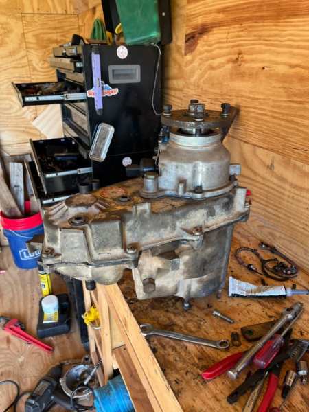

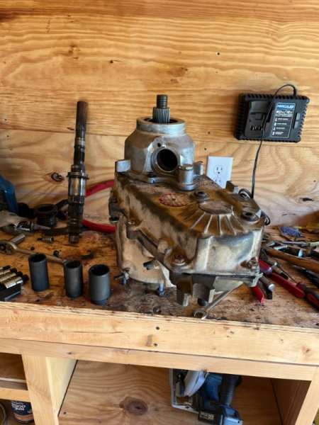

Swampy Posted May 13, 2025 Author Share Posted May 13, 2025 I had to rebuild the tcase because I was having issues with it engaging in 4lo. From what I could tell it was caused by the different gear cut split and the wrong input snout. I got it all changed over and as far as the minimal testing I’ve done it works Link to comment Share on other sites More sharing options...

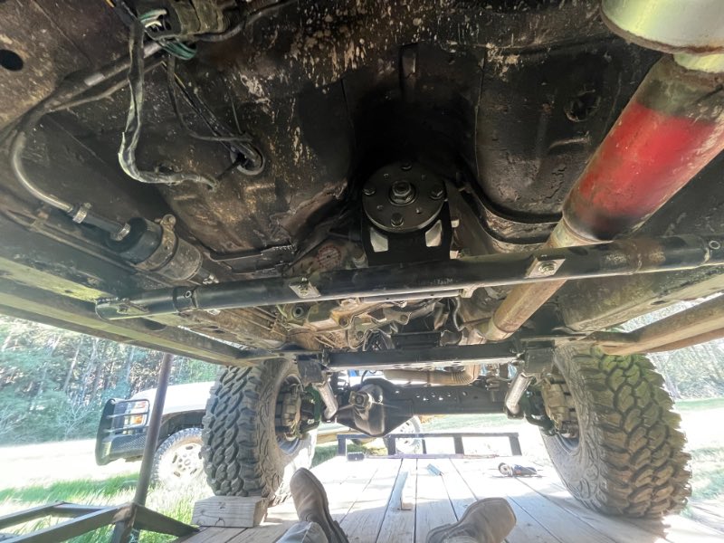

Swampy Posted May 13, 2025 Author Share Posted May 13, 2025 More pics of the tcase installed Link to comment Share on other sites More sharing options...

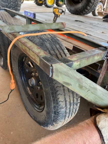

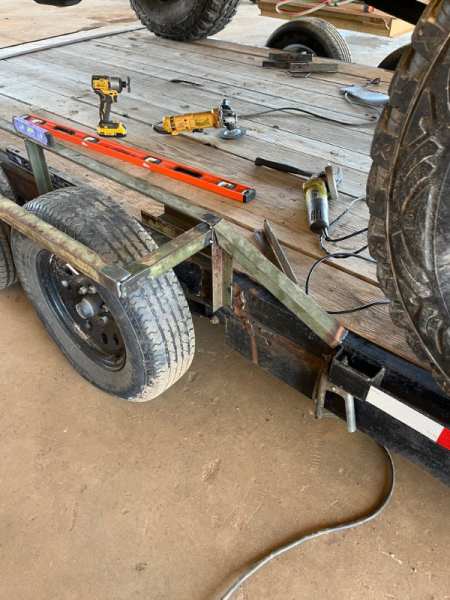

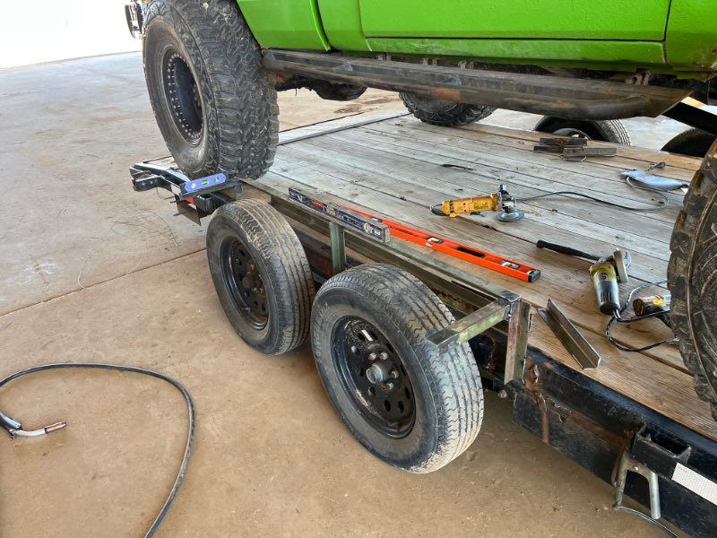

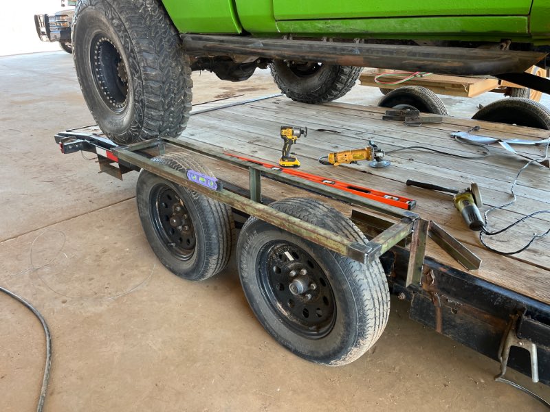

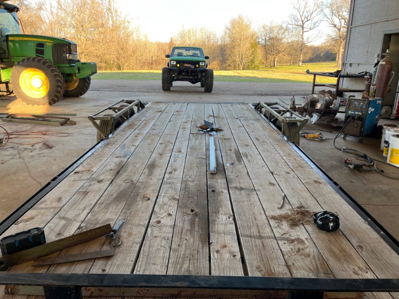

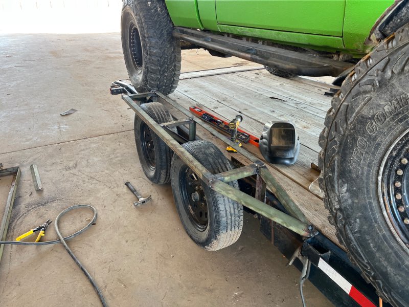

Swampy Posted May 13, 2025 Author Share Posted May 13, 2025 After I got the tcase rebuilt I decided to modify my trailer and build some drive over fenders Link to comment Share on other sites More sharing options...

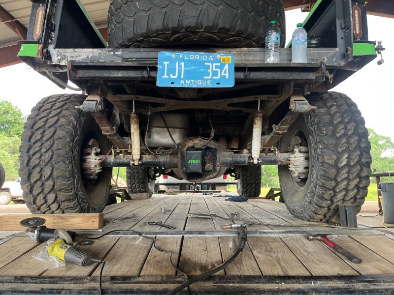

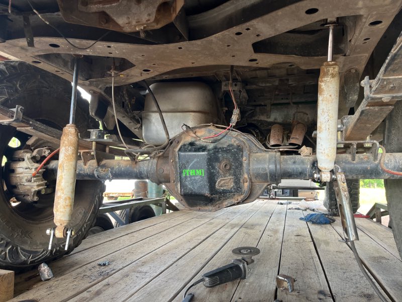

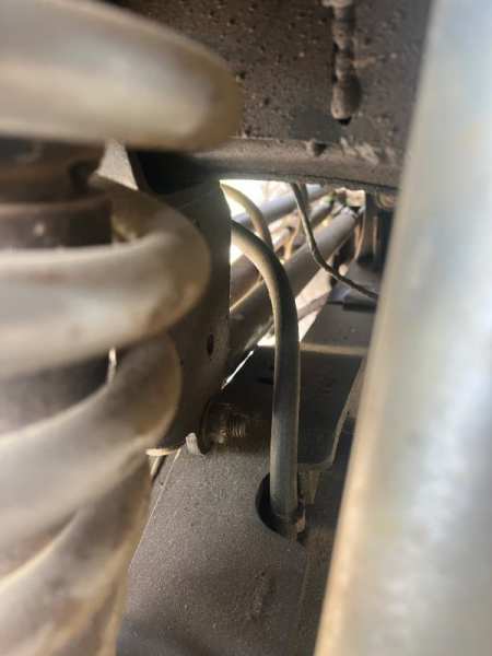

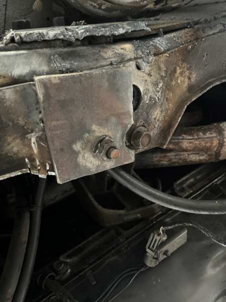

Swampy Posted May 13, 2025 Author Share Posted May 13, 2025 I also changed the rear lower shock mounts because I wanted to use the oem upper mount to help combat some body roll. Had my son helping with these Link to comment Share on other sites More sharing options...

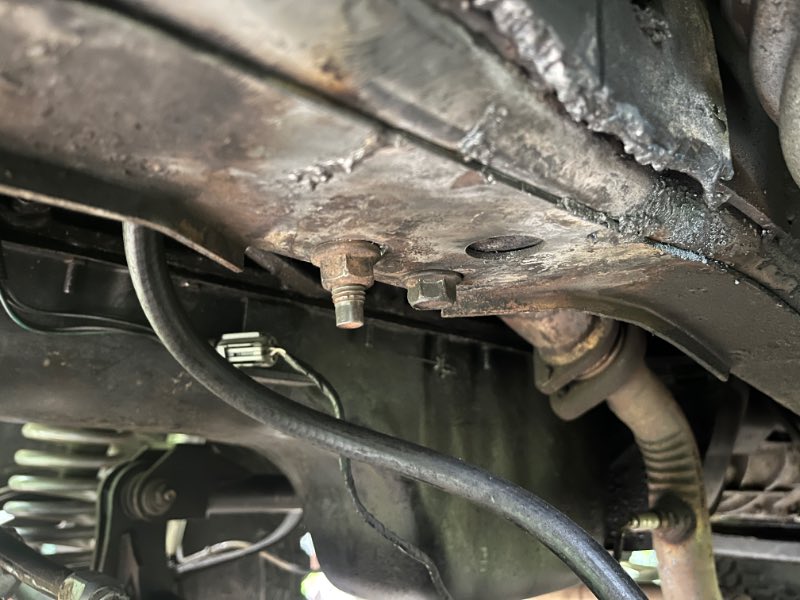

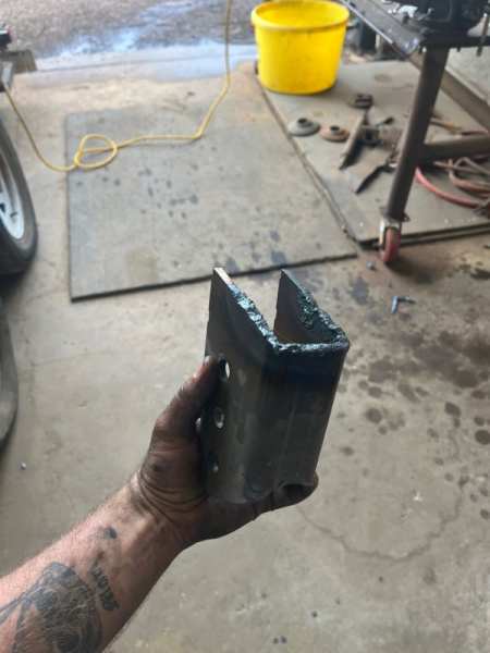

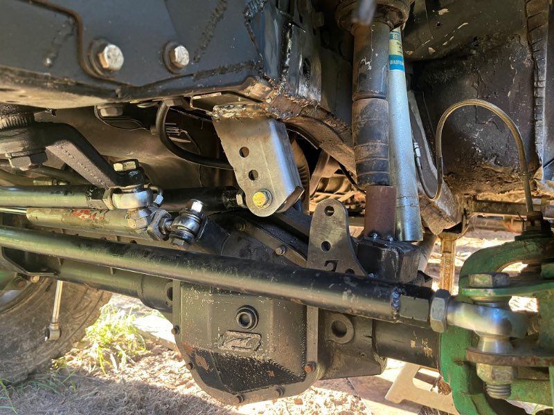

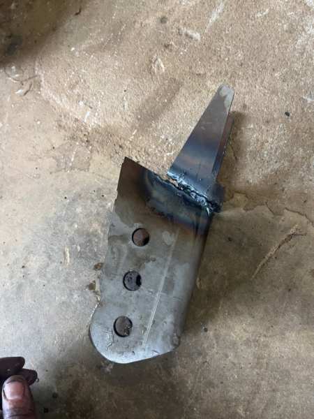

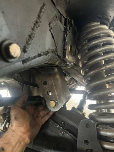

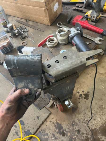

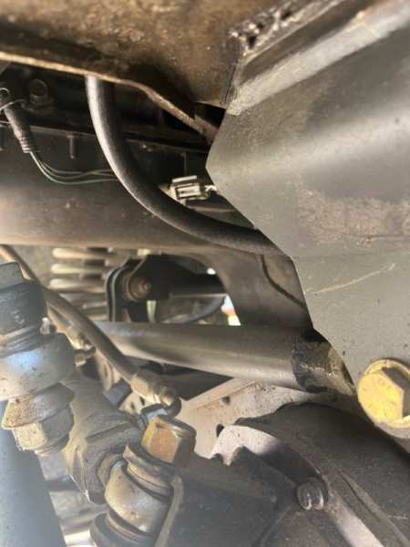

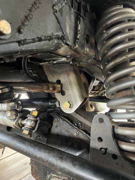

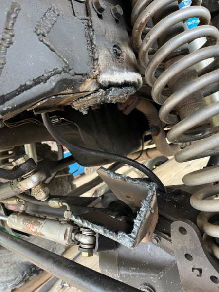

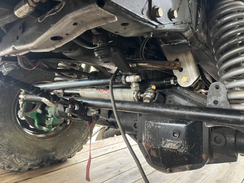

Swampy Posted May 13, 2025 Author Share Posted May 13, 2025 Also changed the front trackbar mount. The bkfabworks mount angled the trackbar too far back and it would contact the truss on the front axle. I ended up cutting the mount off with a cutting torch. Ordered a ruffstuff outside the frame track bar mount. Had to cut the top off of that mount to get it to sit where I needed it to. I made a custom plate to weld the new mount to. I welded the new mount to the frame and made a filler piece to connect it to the old mount that was welded to the stiffeners. It clearances the axle all the way to full bump. And speaking of full bump. I’m going to be modifying all my bump stops to make sure I’m keeping tires out of the fenders and not cutting expensive tires on sheet metal Link to comment Share on other sites More sharing options...
