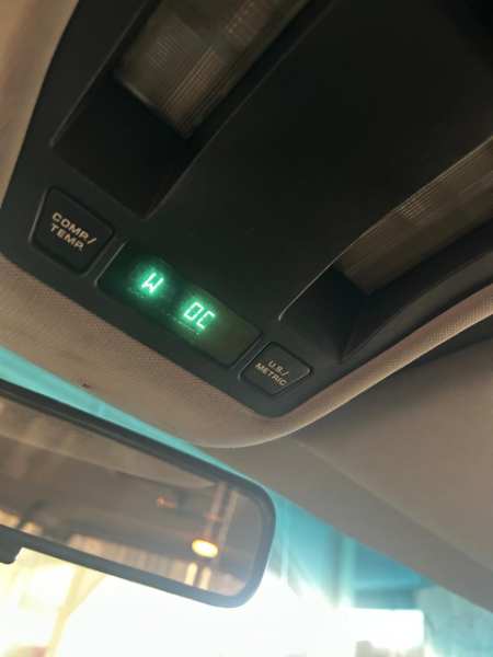

The Cab roof is all done! I also came across a 1996 Xj overhead console at a Salvage yard in St. Louis Missouri! Apparently these are pretty rare so we retro fitted it for the MJ cab somehow the original computer is still working, I had o buy a $40 ambient air temp sensor for the temp to work, but I think its super cool to have in a older vehicle! The Wiper motor didn't survive the submersion, so i picked one of those up too and swapped it out! The interior is completely redone now! I'm just waiting on some Cavfab steering parts to come in the main and she should be all road ready again!
