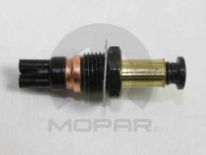

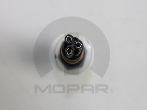

Incommando Posted April 17, 2015 Posted April 17, 2015 I have checked 5 of these push switches ( two after ordering them on-line) from 4 sources including RockAuto. Every time I get one with a blade terminal. Mine has a female terminal with three holes in a triangular pattern. I just need one of these. If someone has a part number that will get me what I need I would appreciate the help. Or if someone has a used one they want to get rid of that would work, too...
Strokermjcomanche Posted April 17, 2015 Posted April 17, 2015 Disregard , I misread your post .Ds278t is the standard number . Airtex 1S1069 Wells SW107
HOrnbrod Posted April 17, 2015 Posted April 17, 2015 P/n 4373296. They changed in 1990. http://www.4wd.com/Jeep-Lighting-Jeep-Lighting-Accessories/Door-Dome-Light-Switch.aspx?t_c=14&t_s=67&t_pt=5781&t_pn=CRO4373296
91Pioneer Posted April 17, 2015 Posted April 17, 2015 Do what I do, grab a used one from the junkyard from a back door on an XJ. The back door is used much less than the front doors ;) Yep, my 88 had a single blade terminal, my 91 has those 3 pins terminal thingy.
Incommando Posted April 17, 2015 Author Posted April 17, 2015 Thanks Don and the others. I have a Rock Auto "advantech" SW107 in my grubby little hand right now and it is blade type. It looks like the part # is right but the thing is mispackaged. Don, You are an amazing resource! X70bajillion.
