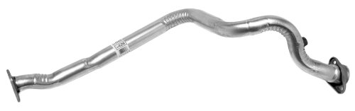

teamsmith Posted March 10, 2015 Posted March 10, 2015 I would like to use the stock HO exhaust manifold (headers) for my swap but it doesn't have the bung hole and the dowpipe won't line up with the Renix crossover pipe. Does anyone know if I can use an HO crossover/down pipe (which has the bung) and whether it might match up with the rest of the exhaust under the truck? I'm looking at Walker front pipe off Rockauto:
Crash Posted March 11, 2015 Posted March 11, 2015 The ho, non egr manifold is longer, the downpipe has the bump for O2 sensor in it
Jeep Driver Posted March 11, 2015 Posted March 11, 2015 Get your engine in and take the truck to a muffler shop and they'll make you one for $90.
teamsmith Posted March 11, 2015 Author Posted March 11, 2015 Get your engine in and take the truck to a muffler shop and they'll make you one for $90. the muffler shop will make me what for $90? A bung hole, a cross over pipe? The Walker down pipe is only $45 and it has the bung hole, although I might have to extend the wires on the o2 sensor. I was just curious if anyone had done this or otherwise had insight on whether it would mate to Cat on my old exhaust.
Rockfrog Posted March 11, 2015 Posted March 11, 2015 When I swapped to the HO manifold I used an HO down pipe and had a muffler shop splice to the old exhaust just before the Crossmember. Cost me $60.
teamsmith Posted March 11, 2015 Author Posted March 11, 2015 sweet. So I'll order the Walker down pipe with the bung and figure on some flexpipe or other adaptation to the rest. Thanks
Rockfrog Posted March 11, 2015 Posted March 11, 2015 I've often thought a short flex pipe behind the bellhousing would save the manifolds from cracking. Plan to use the Renix flange (has no crush) a custom down from that to a flex pipe behind the bell and mate that to my current exhaust. And adding bung for the 02 sensor is easy... Drill hole, have welder burn bung in. Any muffler shop will have them or they can be found at auto parts stores or even eBay for little cost.
cruiser54 Posted March 12, 2015 Posted March 12, 2015 Get your engine in and take the truck to a muffler shop and they'll make you one for $90. the muffler shop will make me what for $90? A bung hole, a cross over pipe? The Walker down pipe is only $45 and it has the bung hole, although I might have to extend the wires on the o2 sensor. I was just curious if anyone had done this or otherwise had insight on whether it would mate to Cat on my old exhaust. Wires will reach....
Rockfrog Posted March 12, 2015 Posted March 12, 2015 Yep, a careful rerouting is all that's needed and there is plenty of slack to reach the new location.
