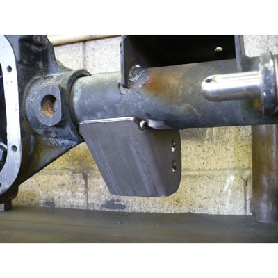

Pete M Posted May 1, 2015 Share Posted May 1, 2015 That is a really cool truck. I would suggest you gusset those like mounts. With the forces they will see in a truck that tall they will probably fail. Other that that I'm digging it. Totally different from the norm. Good work! You'll probably fail well, they are kinda hanging out in the breeze. :yes: I would add a flat gusset across the pairs of tabs so they look more like this: awesome build! :thumbsup: Link to comment Share on other sites More sharing options...
