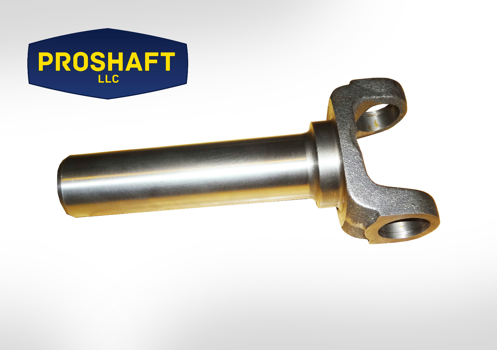

HOrnbrod Posted June 2, 2014 Share Posted June 2, 2014 Your drive shaft is too short. It either needs to be lengthened by a shop for more slip yoke spline engagement, or you can replace the slip yoke with a longer GM yoke. http://www.ebay.com/itm/GM-Turbo-350-Extra-Long-Racing-Slip-Yoke-700R4-7-5-1310-Style-Precision-369-/251547475996?pt=Motors_Car_Truck_Parts_Accessories&hash=item3a9165e01c&vxp=mtr Link to comment Share on other sites More sharing options...

lil_loco Posted June 3, 2014 Author Share Posted June 3, 2014 That might be a great suggestion! So if I'm running ax4/NP207 what specs should I be looking for? Is the yoke you linked the correct one? Your drive shaft is too short. It either needs to be lengthened by a shop for more slip yoke spline engagement, or you can replace the slip yoke with a longer GM yoke. http://www.ebay.com/itm/GM-Turbo-350-Extra-Long-Racing-Slip-Yoke-700R4-7-5-1310-Style-Precision-369-/251547475996?pt=Motors_Car_Truck_Parts_Accessories&hash=item3a9165e01c&vxp=mtr Link to comment Share on other sites More sharing options...
HOrnbrod Posted June 3, 2014 Share Posted June 3, 2014 This yoke works fine w. the 231 and 242 cases, but am not sure of the output shaft spline count on the 207. Did not notice you had an 86. Since the drive shaft is out, count the internal splines on the yoke. Link to comment Share on other sites More sharing options...
