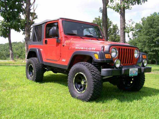

jeepdoggydogB Posted November 30, 2009 Posted November 30, 2009 After 31 inch Cooper STT's Before My STT's are noisy, but they stick to just about any surface, and have lasted more than three years. I had to recently replace the front two because of balljoint and alignment issues now fixed.
