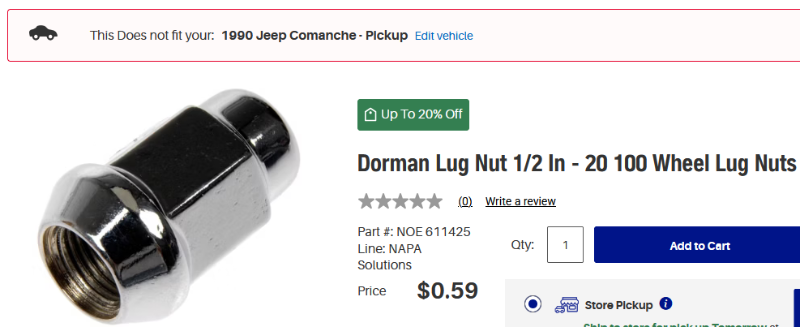

GonzoTheGreat Posted May 1, 2025 Share Posted May 1, 2025 5 on 4.5” is the lug stud pattern on the hub. 1/2” x 20 is the stud/nut thread NAPA Link to comment Share on other sites More sharing options...

AnotherOldJeepGuy Posted May 1, 2025 Share Posted May 1, 2025 NAPA's website doesn't think this fits, but I am guessing the expertise here is more accurate than that of the NAPA website! Link to comment Share on other sites More sharing options...
