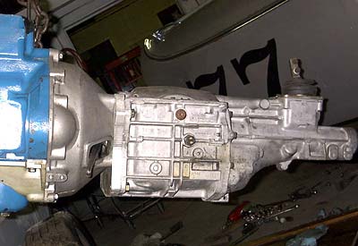

i'm trying to figure out what i have for a transmission, i have a 1986 Comanche 2.5L 4x4 with a 5-speed tranny, i know that i can't have a BA 10/5 because they didn't come out until 1987. I've heard that AX5 wasn't available with the 2.5L until 1987 also so that would leave me with the T5 right? I'm just trying to make sure i have my reasoning right because i've heard that the AX5 was avaible in 1986. thanx for any help in advance.
Believe it or not, I have the T5 listed as available with the early 2.5.

Take a look at the tranny- does it have an intermediate plate?
That would clear it up pretty quick.

where would i look for the intermidiate plate?
The AX series trannies are split from front to rear with a plate in the middle- let me see if I can find a picture...
Let's try this one-
Just for giggles, here is a 2wd T5 (Yours mabe a hair different, but the main body will be similar)-
In the upper picture there is an itermediate plate between the two parts of the tranny, the AX5/AX15 both have this. (It is pretty obvious when you look at it)

once again i'm really sorry i added the poll, it just made everything confusing, but thanx for all the info,from the pics i'm almost positive i have a T5, i'll have to crawl under after class today
I know that i have an external clutch slave cylinder...if that means anything
