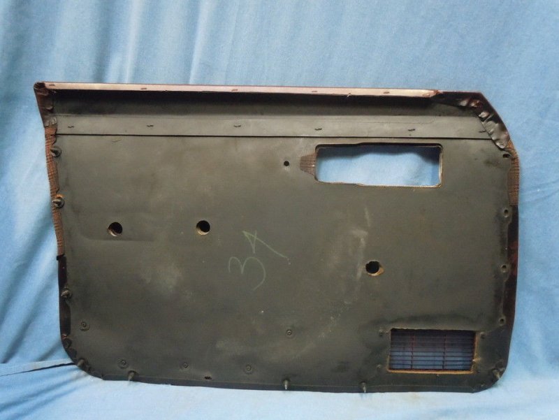

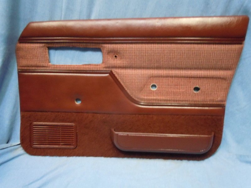

  10. Has anyone recovered door panels that have the cloth insert running from the door handle across and down behind the arm rest, specifically just the cloth part? I'm getting the seats recovered, actually just the tweed cloth inserts in the middle of the seats, and while the cloth pattern the upholsterer was able to find is pretty close to the OEM tweed, I'd really like to have him do the door panels too for a true match. We looked at the panels (mounted) and the question is, the border/heavy trim where the vinyl on the top and bottom meets the cloth, is that glued on or stitched on or what? Pics attached are not my panels but show what I am talking about. The upholstery guy said he's not sure if he'll be able to put in the new cloth if the border is just glued on. Hoping somebody has dealt with this before..............
