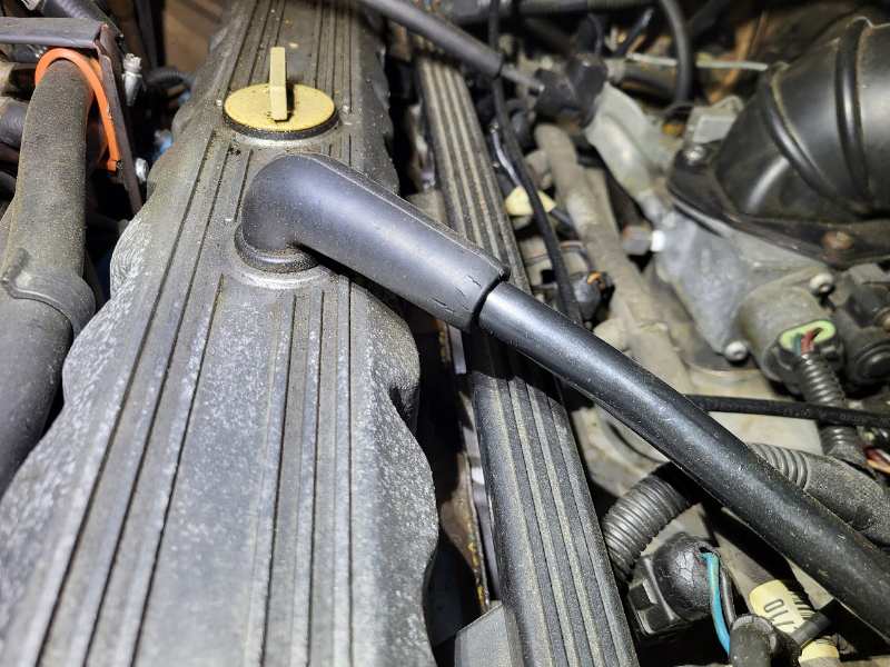

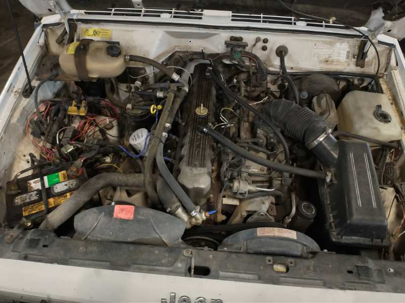

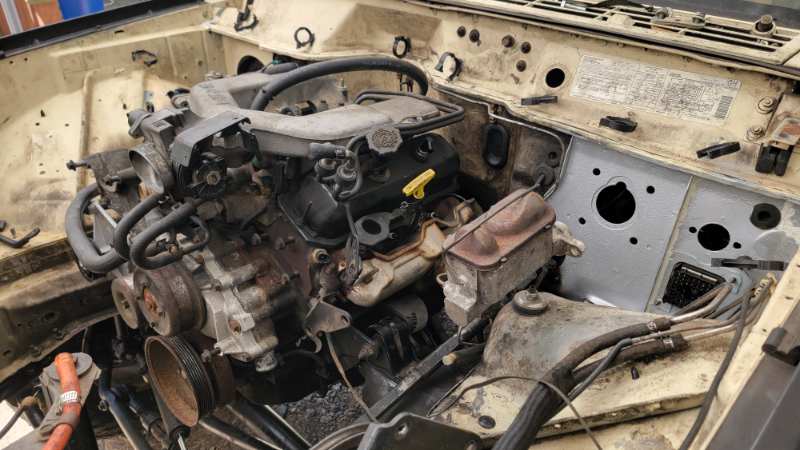

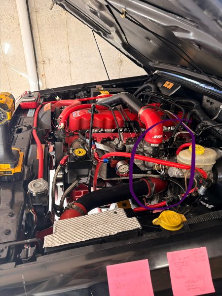

MayDay!! - Hard Accel Killed Idle
AnotherOldJeepGuy replied to AnotherOldJeepGuy's topic in MJ Tech: Modification and Repairs
To eliminate the brake booster as the source of the problem, I think I will disconnect the hose to the booster and plug it and see if the engine runs better. Anyone see an issue with doing this? - Today

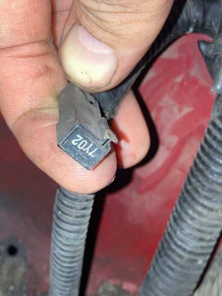

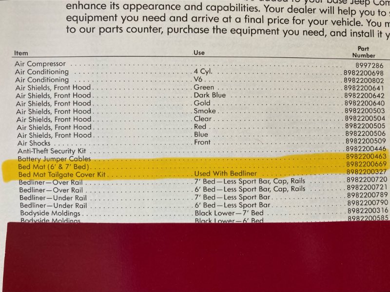

No such number in my 87-90 parts catalogue

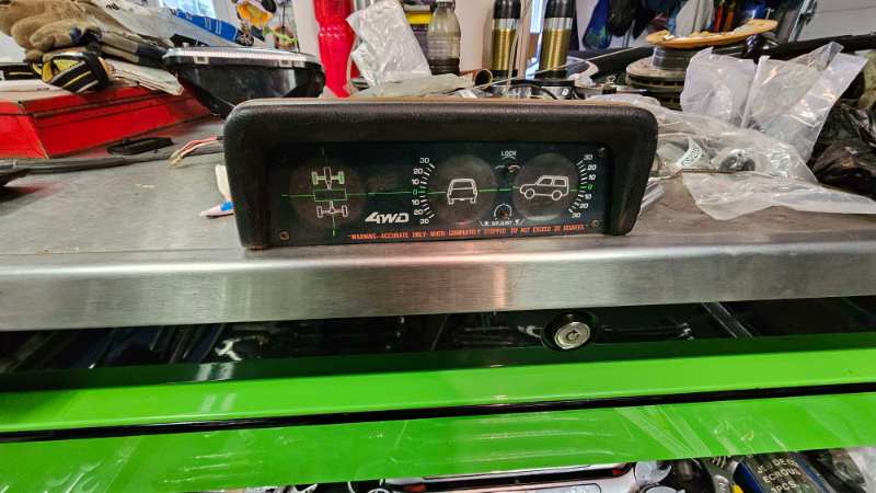

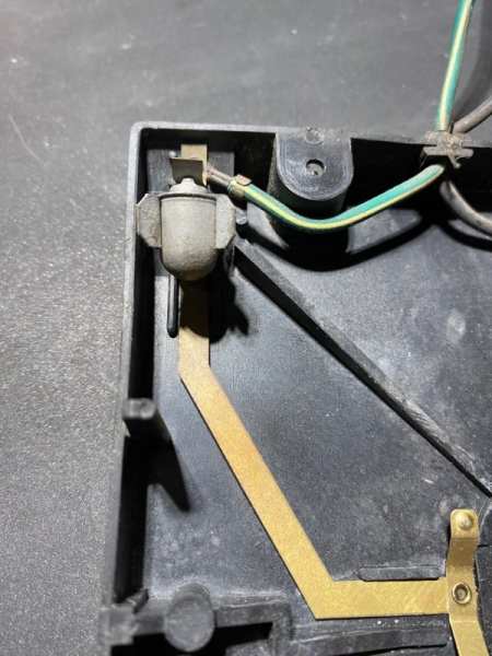

Dude, Honestly the temp gauge and compass are horrible and finnicky. My temp does work now. But blinks. I have no idea how to permanently fix them so you're on your own. I plan to replace it with a 2"x 1" arduino board that shows my fuel pressure, outside air temp and then my boost controller settings.
Eagle_SX4 replied to AnotherOldJeepGuy's topic in MJ Tech: Modification and Repairs
If you take the air box out you can get to all the bolts from the top side. It is a little bit of a guessing game on the center 2 on the bottom but you can get them. -

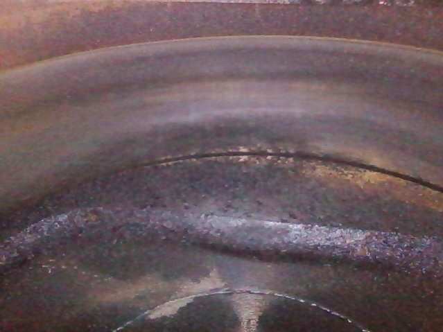

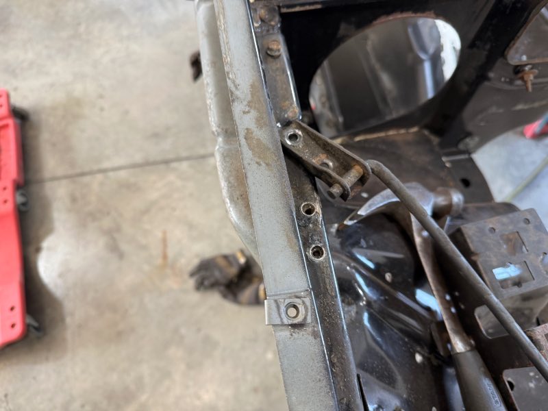

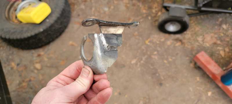

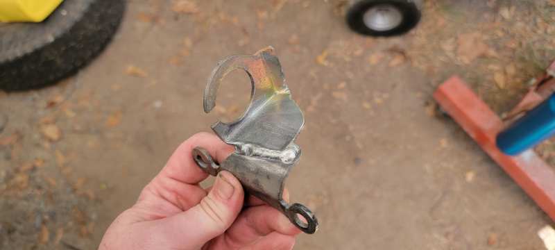

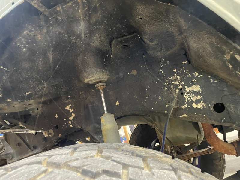

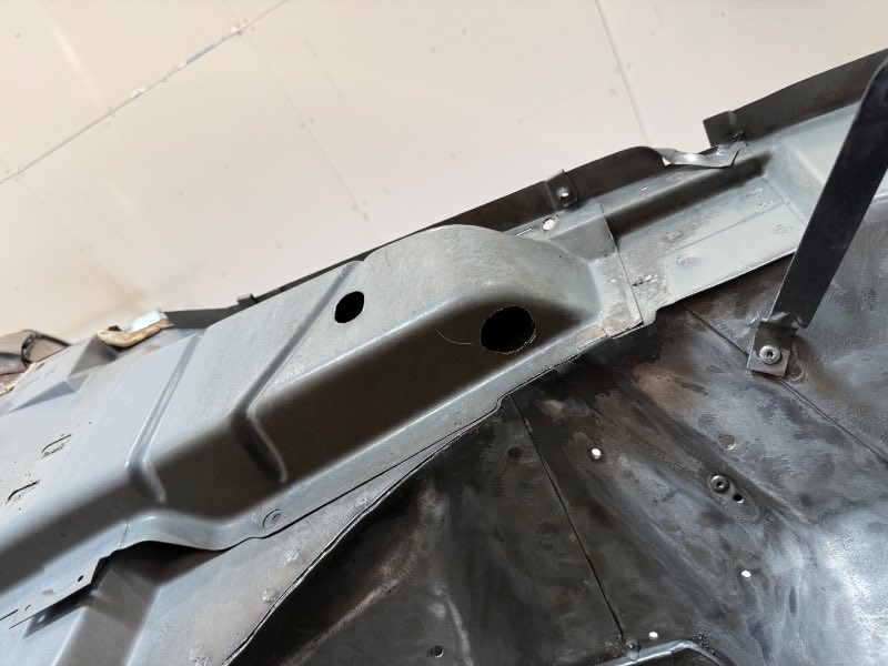

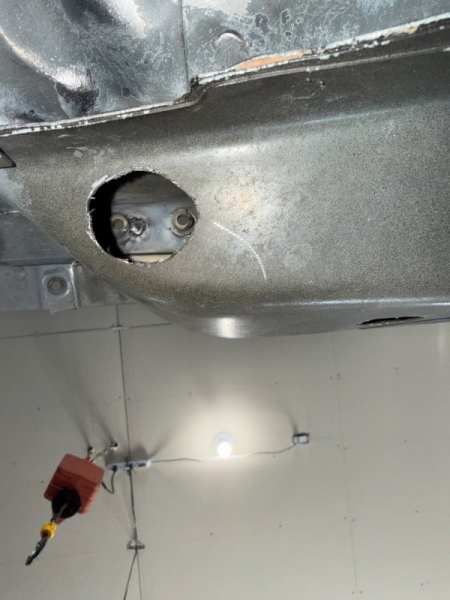

Front wheel well done What to do when you really want to take off your hood prop rod and the nut underneath are spinning free and there is no acces to them . Drill a hole big enough to get your welder nuzzle and tack them in place Job done
Beats me, but someone else might know if that is a possibility. -
Porquer replied to AnotherOldJeepGuy's topic in MJ Tech: Modification and Repairs
Could you have damaged your booster diaphragm when you slowed down? I’m not very familiar with vac boost, but it seems like that could cause a vac leak that could cause weak brakes and poor running. - Yesterday
Yeah I've learned that can be an issue. I got a wrench on all the ones you can get to from the top and a couple were a little loose. I got to 2 bottom ones that I could snug a little and 2 were tight. But there are still 2-3 that I can't get to with any tool that I have. I'll need to find a 9/16 box end that is at least 2 feet long and I might get to the others. -
pizzaman09 replied to AnotherOldJeepGuy's topic in MJ Tech: Modification and Repairs
I'm very suspicious of the exhaust manifold, leak at the head due to jarring the engine hard one way then another. Check if your bolts are tight. The smoke is likely exhaust smoke. -
Well the IAC was a good thought, but it is still clean from the cleaning last Feb, as it the TB. So that's no it I also noticed as I limped it into the garage, brakes are not working well. I know @89 MJ already mentioned looking at the hose to the brake booster, but it looks completely fine. But what ever failed is something that is causing very bad idle and at the same time power brakes don't seem to be working either. I currently have the battery disconnected in an attempt to reset the ECU. It's a hail Mary but it's something to try. If that doesn't work I'll probably have to trust it to one of the local shops since I'm thinking this is quickly getting beyond what my ASTM degree can handle. -
