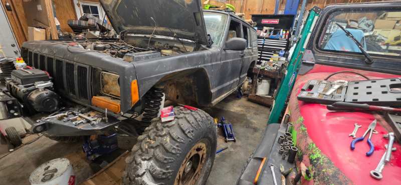

mvusse Posted May 4, 2008 Author Posted May 4, 2008 Work day 2. Went to Davey's Jeeps and got a new driver's side fender as well as a (green!) bumper. This is what I started off with today: fender bumper and bracket (with horn attached) Header assembly had to come off again to get the fender off. The new fender and that bracket are on. It IS grey. Just a different shade. I guess I have a Cherokee Sport now :D And with the bumper installed. Header assembly back in place. And back out into the cold. I drove around like this for a while, with the total cost now at $560. Did most of a tune-up: Spark plugs, wires, distributor cap and button. Since then I have also replaced most of the rear brake line, and other miscellaneous brake parts, as well as lower control arm, track bar and track bar bracket. Also put on a CB antenna where the radio antenna is supposed to go, but the radio has not been installed yet. More pictures on that later. At the moment I'm at $710 plus probably another $100 in little parts, so let's call the total $800. Part of the last $150 still has to be installed, though.
