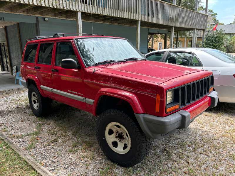

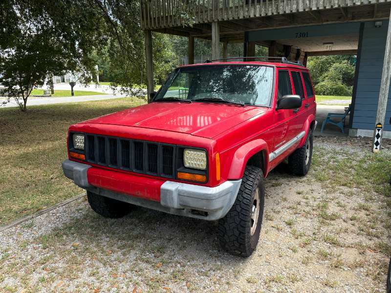

A family member has been wanting something to drive on the beach during the fall/ winter months, when it's allowed by permit. She's sent me a multitude of FB Marketplace ads for everything under the sun other than something Jeep. One or two I was willing to look at but they sold quicker than I could get there to look them over. I'd said a few times "you just need to find a used Cherokee, it would be perfect." Her response every time was "Jeeps are junk." Then she drove my MJ back toward the end of August... and maybe Jeeps aren't junk after all.
2001 XJ Sport 4WD/ AW4 with a blown up Dana 35 - $1000.00. Engine was replaced in 2016, probably due to a cracked head/ ensuing issues.

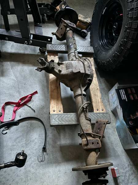

Labor Day weekend a nearby LKQ yard had a 2000 XJ with a 29-spline Chrysler 8.25 under it. Everything was 1/2 off that weekend so I scooped it up for $100.

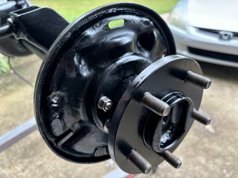

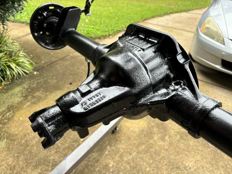

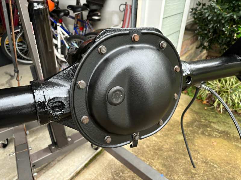

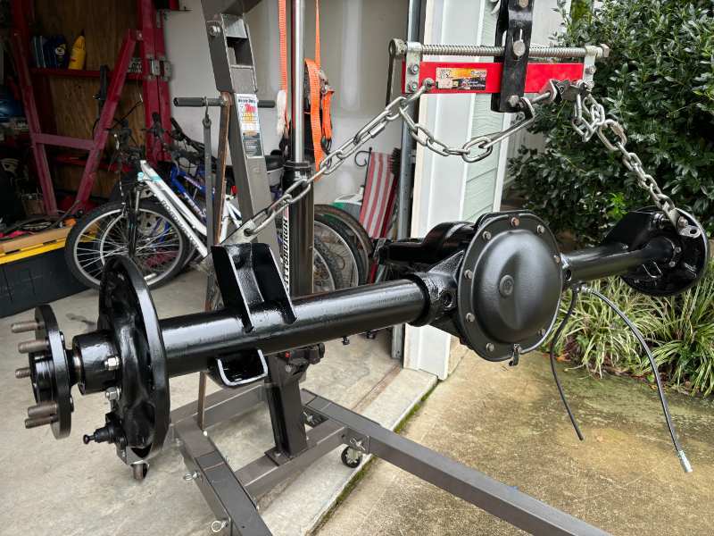

I put about 30 hours into it last week from Sunday-Sunday and got it redone...
Everything but the wheel studs, plus all new brake hardware and parking brake cables. Just need to assemble the brakes. If the 9" drums on the D35 are decent I'll re-use them, or just replace them if not. Backlash is a pitch perfect 6.5/1000ths, pattern is excellent.

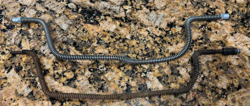

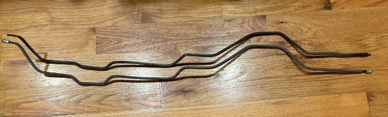

New brake lines made from AGS PAC-325 roll left over from the MJ (Poly Armor Coated 3/16") with Stop Shop gravel guard. I can see I'd like to replace the other lines on the Jeep in the next 6 months as well.
IMG_E1686.JPG.0e55f0f1d13883fcf741698471a6919b.JPGIMG_E1726.jpg.b99fb06e18e4c351a0554df7f957d460.jpg

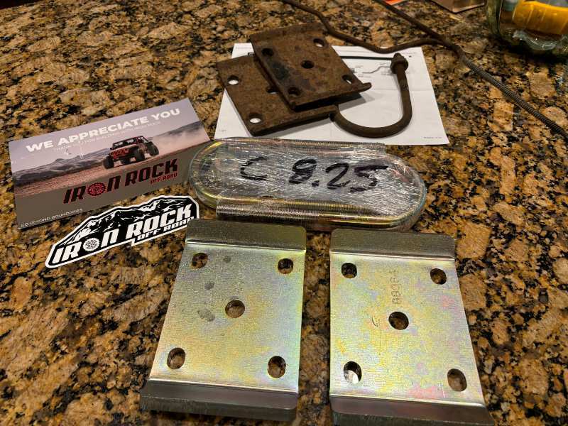

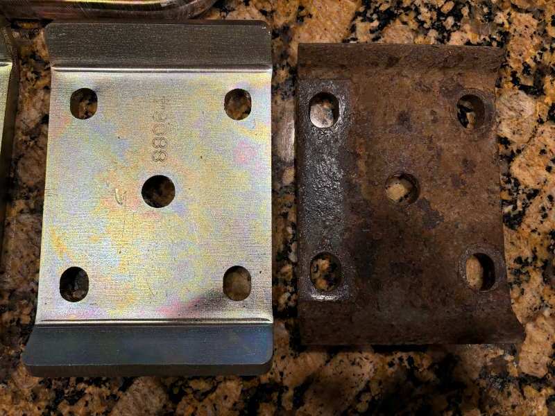

New Iron Rock Offroad plates and u-bolts, the most expensive part of the axle swap ($119 with shipping).

12 hours ago, Eagle_SX4 said:
What paint did you use?
For this one I used a pretty basic Rustoleum spray enamel. Since this rig will see a considerable amount of salt exposure I wanted something easy to maintain with readily available inexpensive paint. Any rust that creeps in in the future would be easy to address and then re-coat. The longest bit of work was peening the nodular iron center section to get all the rust layer off down to clean metal. I normally wouldn't bother coating the yoke but I thought it would be a good idea given its environment.

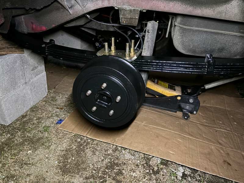

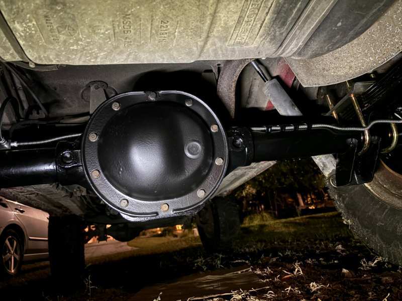

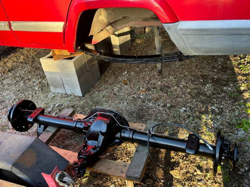

Yesterday was the day to haul the axle down to the coast and get it swapped. The rear brake line came off without drama, thank goodness. I spent some time cleaning up the leaf springs and drums and coated them with VHT Chassis & Rollbar paint. The drums are almost new (score). I had assumed the 3" lift was a cheap front springs with add a leaf in the rear. Turns out they're Zone Offroad 3" springs in the back. A couple steps better than Rough Country anyway.

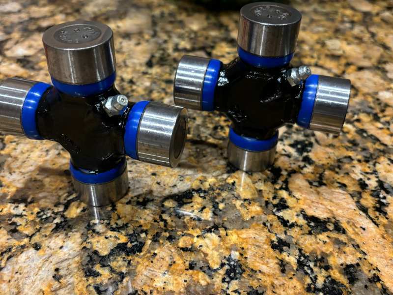

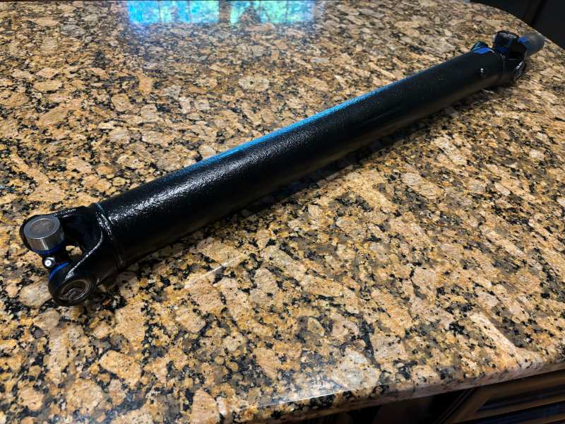

I like to "Black Max" my u-joints...
The original driveshaft had about 1/2" of engagement at the slip yoke on the Dana 35 with that lift :eek:. With the 8.25 it's perfect. I'd read that the D35 -  8.25 swap with a 3" lift requires nothing if you have the D35 shaft. Truth.
I got a late start at 2:00 but had it mounted and torqued, with driveshaft attached, by sundown. I'll head back to install the parking brake cables and drum hardware probably next week.
Rear ride height is exactly 3" over stock number in the back. My understanding is that these were installed around 2016-2017 not long after the engine was replaced. So they've settled and are holding 3" above stock. Not bad, word is these springs are stock-like ride quality.
Carrier and gears on the D35 are fine. Left axle shaft is smooooked.
I may find an axle shaft, put bearings and seals in it and see if anyone local wants it for cost of the parts. Backlash is a nice 7.5 thou. 3.55 gears.
That shaft is definitely borked.  Probably not worth the effort to salvage it.  Maybe post it up for free and tell people they would need a shaft.
If you were closer, I'd offer to swap a shaft out of my parts Jeep that's destined for the salvage yard.  Still, trying to get $100 out of a Dana 35 is ambitious.
Probably good advice. I possess the character flaw of having the conviction that anything can be fixed. So I want to fix it. But I won't. Thanks for talking me back from the edge. Cheapest axle shaft I can get is $45 at my local boneyard, IF there's a D35-equipped XJ. Add about another $35 for bearings and seals and I'd be at $80-90.00.

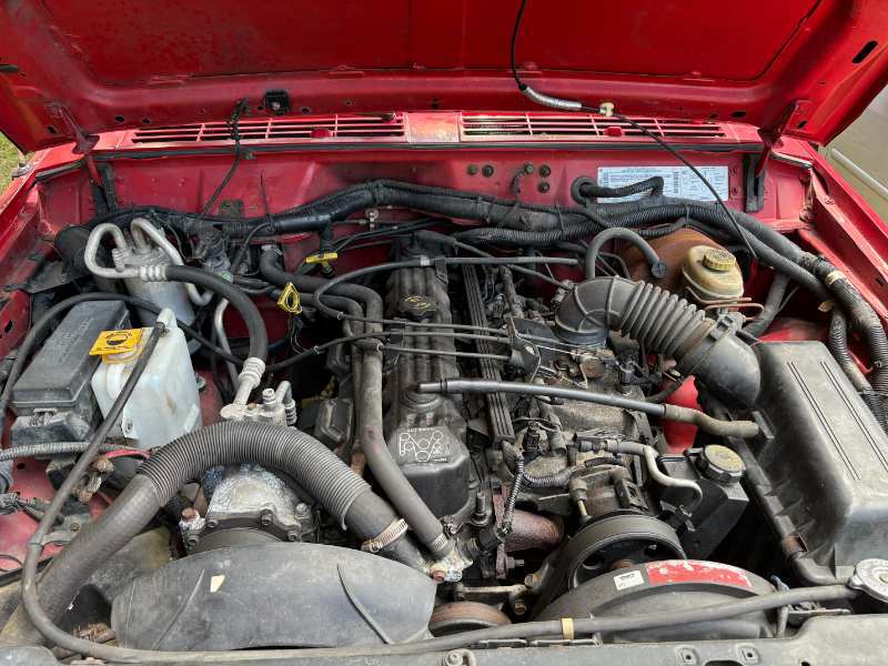

Last weekend I got the rear brakes and cables sorted, bled, adjusted and drove it. Hadn't heard it run before then. I have to say it's the smoothest and quietest 4.0 HO motor I've ever heard. 50psi oil pressure at hot idle. Transmission is butter smooth. I also fixed the wobbly console and put new shifter bezels on it. Yesterday it got a new battery tray. She's really happy with everything so far and she drove it last night for the first time. Motor was replaced in 2016, I'm trying to find what the mileage was when that happened.
Here's the bad - the front axle really really needs a refresh and the front tires are cupped and chopped and hella noisy. I can tell this Jeep would want to be a wobbler! It'll hold together until spring, no problem. She's going to be driving it short distances at 45MPH or lower, to the Emerald Isle Beach surf access points and occasionally to the grocery store. That's essentially 5-10 mile round trips, tops.
