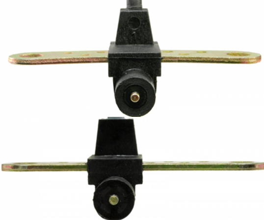

Big_Mark Posted Wednesday at 03:30 PM Posted Wednesday at 03:30 PM Like the title says, whenever I decelerate, whether under load or coasting, I hear a popping sound coming from, I think, my exhaust. Let me say, this has been happening the whole time I've owned this Jeep and i though it had something to do with compression because it happens when I downshift and use the engine to break/slow the vehicle. BUT the other day, I was feeling to lazy to use my hand to shift down, so I pushed in the clutch and let off the gas and coasted around a corner, sure enough the popping began. I have two working theories; 1. The PO put in new injectors (4 holes)I wonder if the injectors are dumping to much gas into the engine at the lower speeds to burn it off, hence popping/backfiring in my exhaust? 2. The CPS isn't signaling the system about the reduction in speed so the ignition is dumping too much fuel. Do any of you have other ideas? Has this happened to you? I've done all the grounding, troubleshooting steps in Cruisers guide, and otherwise the engine runs like a top, I'd just like to iron out this wrinkle, thanks in advance!
89 MJ Posted Wednesday at 03:53 PM Posted Wednesday at 03:53 PM Do you have a regular CPS or a high altitude CPS? Immediately after the engine swap in my truck, it started doing this and did so for probably 1500 miles or so. At that point, I switched to the high altitude CPS and have had it happen much less, it maybe happens a few times in the first hundred or two hundred miles of pulling the truck out of winter storage, then it gets itself sorted out. My other thought would be that it runs too rich with the current injectors. Do you have a REM? I'd be curious to see what it says for O2 information on deceleration.

Big_Mark Posted 11 hours ago Author Posted 11 hours ago Thanks guys, cracked header seems likely, as for the CPS I am not sure if I got the high altitude one or not, I'll see if I can figure out which one it is since I replaced it a couple of years ago. and no REM here, cept on the stereo! It's always something!
