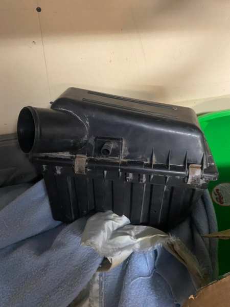

Soon to go in the engine bay. I’ll use my Renix top half with the bottom half of the later air box. No more warp!

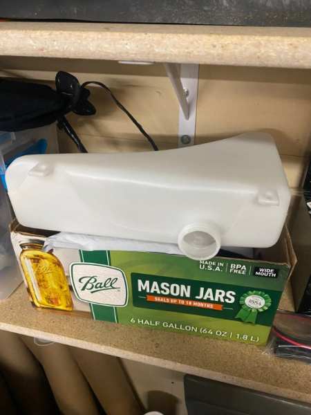

We’ll see how the quality it on this replacement coolant bottle, mines still working but has busted tabs
Looking a little rough right now, some fresh paint will be night and day difference!

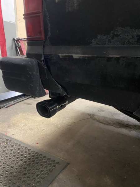

The Borla exhaust tip for the mighty 2.5

That coolant bottle is probably the only thing crown makes that’s worth while. Ironically they don’t make the cap which I find incredibly odd but they’re a crappy company that doesn’t go the whole 9 yards for restoration parts. Like they have XJW headlamp bezels. That’s it. Nothing else XJW specific.
But that bottle will last a long while. I had one. I think I sold it after I got a genuine NOS one
Yes I thought it was cheesy not having a cap. I made the mistake of buying crown fender flares one time, never again.
Not sure how they stay in business.

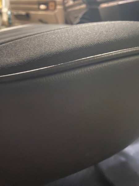

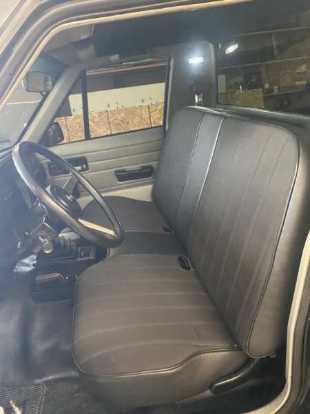

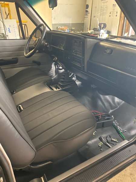

That seat turned out very well
Thank you! The lines are similar to the door panels, very happy with the look and no longer smelling the old vinyl

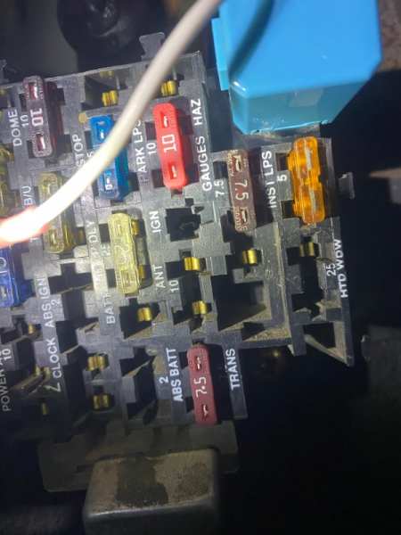

My gauges fuse connector was partially broken, so I’d lose my gauges intermittently. Finally got around to removing it from the fuse block to replace, and realized it was bridged to another connector. Since it’s a pain in the butt with not much wire to work with, I just flipped it so the bad connector was in the ignition slot now. Easy fix without having to do any cutting.
