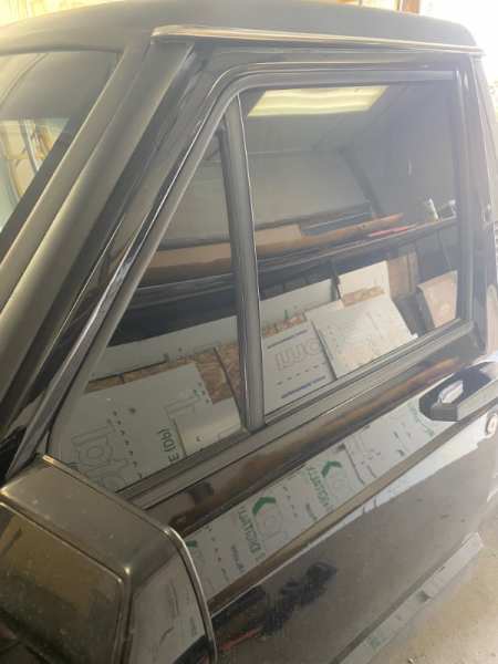

  1. Finally painted and put the door window trim back on. These were such a pain in the rear, and I don’t plan on never removing them again..
