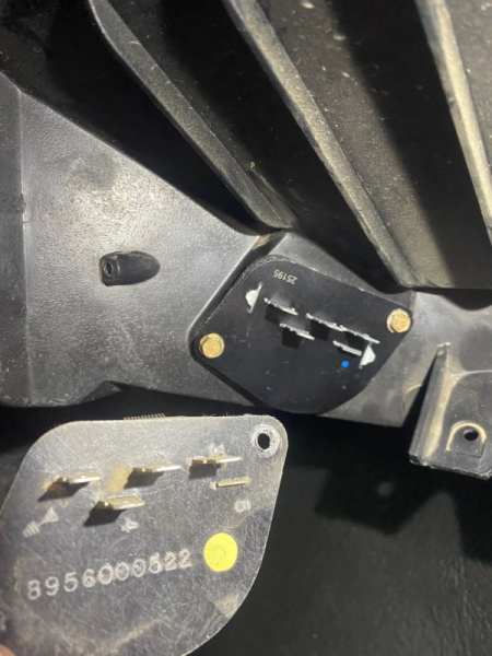

Precautionary measures replacing the blower resistor. Will be doing the improvement to the blower ground ground at the same time I do my battery cables.

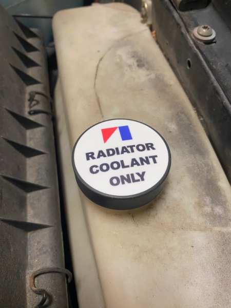

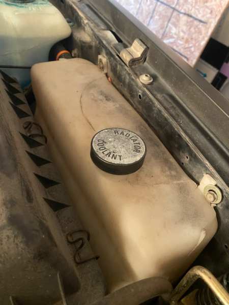

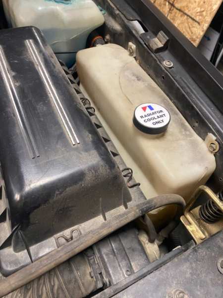

As I mentioned before, my wife and I own a sign and vinyl shop. I will be making a new printed/laminated 3M decal for the coolant bottle cap to freshen that up a bit and add some flair.

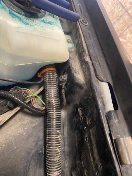

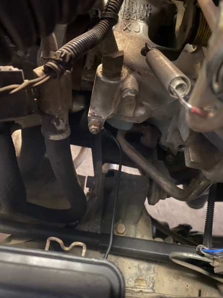

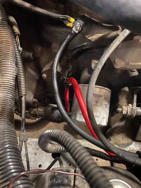

Refreshed the ground by the washer bottle and ran another ground from there to the motor.

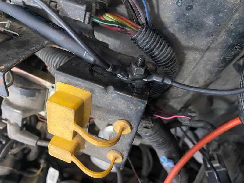

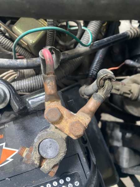

Added a ground stud to the relay bracket for the blower motor ground and ran a 4ga cable from there to the battery.

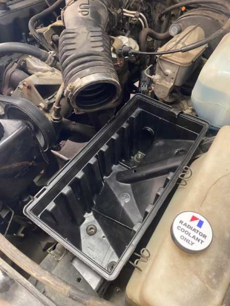

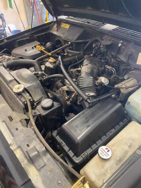

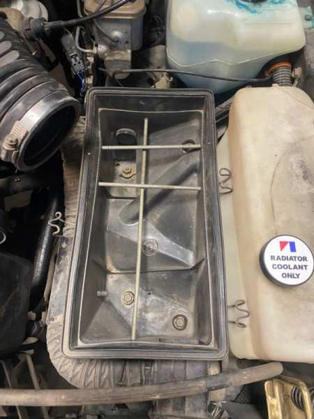

Also installed the crankcase breather hose back on to the air box, and a new air filter. So nice having a non-warped air box!

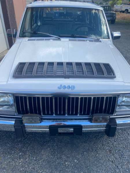

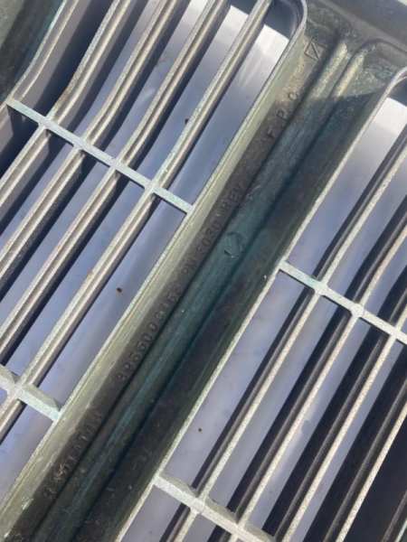

After looking at some pics online of color matched grills (limited XJs) and consulting with my wife, I’m really leaning towards going with something like SEM trim black instead of glossy color matched black. That way I can paint myself and touch up myself if needed.
Color matched grill is pretty fancy for a Sportruck

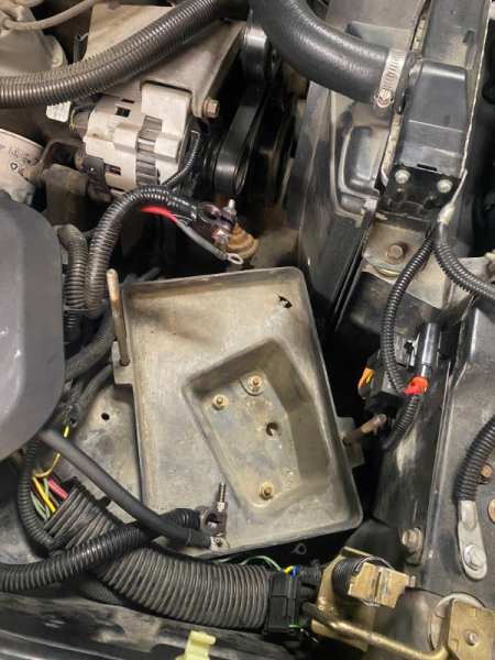

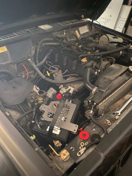

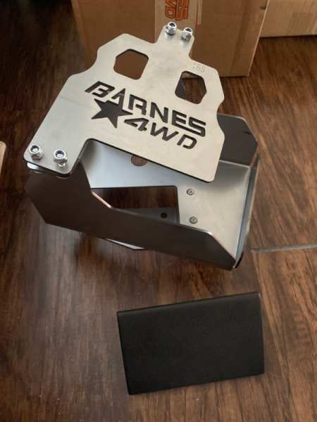

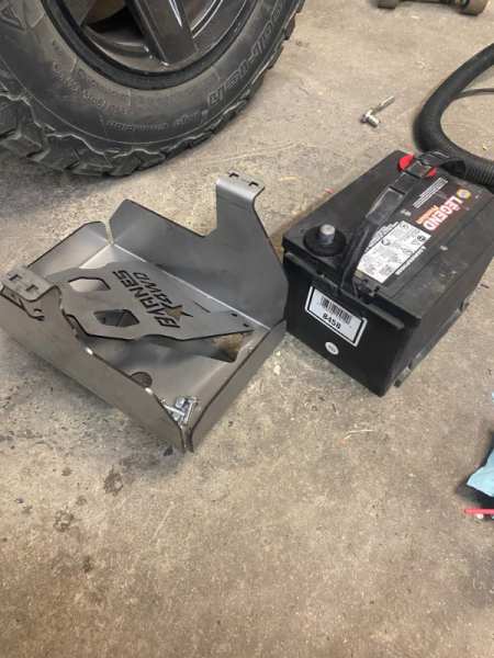

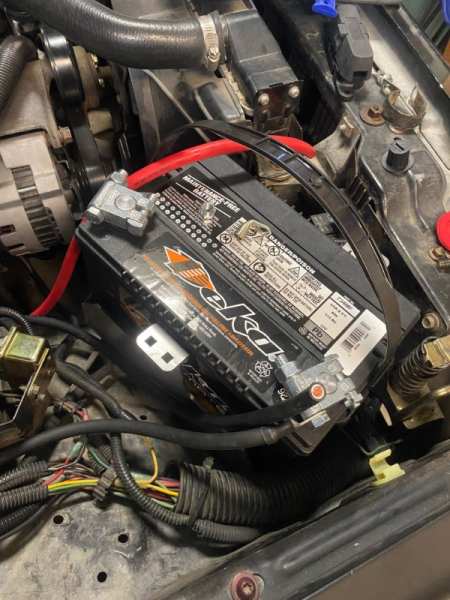

Got my battery tray in as well as an oem black ash tray. Haven’t decided on powder coat or paint.
I can finally get to work making new battery cables.

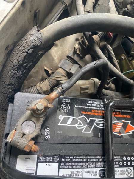

Out with the old, along with some slight surface rust clean up and topping with some Eastwood. No more cheapo napa cables.

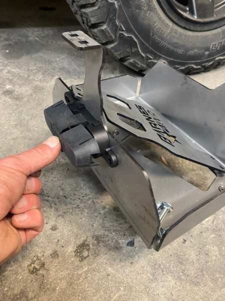

I plan on mount in the fuse holder to the battery tray in some way shape or form. Thinking welding a bracket to the side will serve better than counter-sinking machine screws for inside the tray.
Also realized that I need to get a group 34 battery for this tray, which is another upgrade from the stock battery that will go great with the new cables.
Still letting the Eastwood cure up on the MJ before I put the battery tray in and start crimping cables.

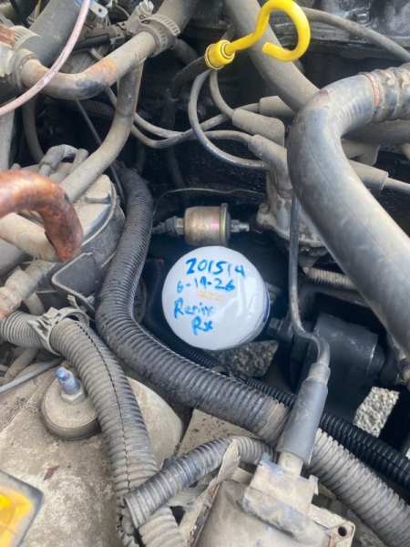

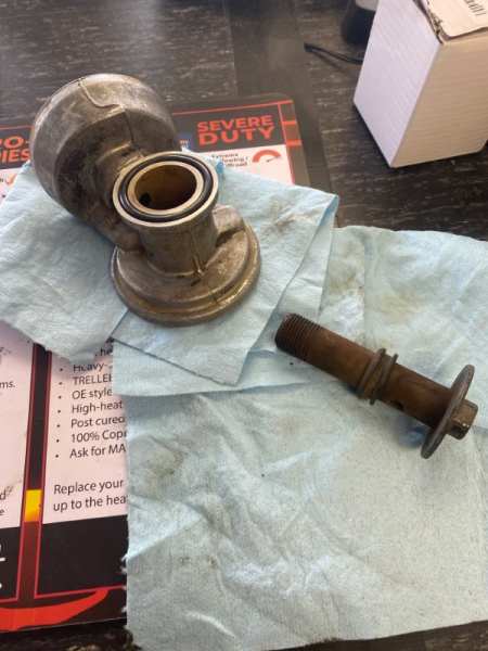

So today I tackled the passenger side motor mount on the 1990 XJ as well as the oil filter adapter o rings. Will replace the driver side mount when I put in the HO air box bottom on.

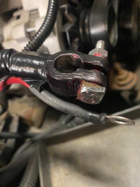

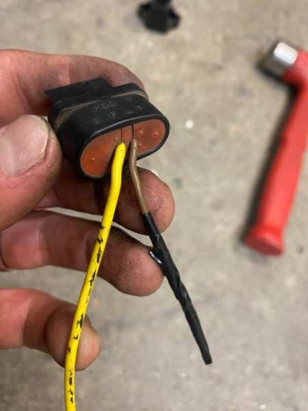

What is this brown wire coming off the alternator plug supposed to go to? It was disconnected and it was charging just fine.
EDIT: A bit more research seems to show that the brown wire is unused since I have a voltmeter and not an idiot light.

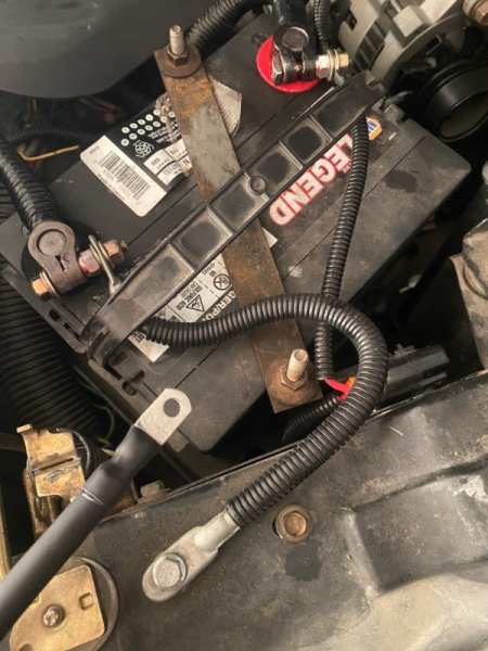

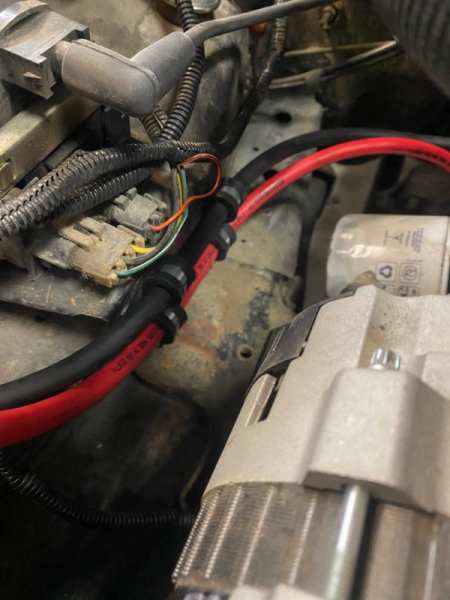

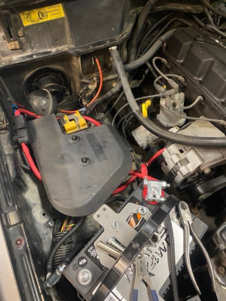

Made more progress on the cables today. Need to make a minor trim to the relay cover and make a cable to the rad support, and the firewall to motor cable. Just barely have enough cable to finish this after doing the 90 XJ as well. Last but not least will be some 2ga cables for the ZJ.
  • 1 month later...
Battery cables galore!
Along with new fusible links and many other wiring replacements and repairs.
