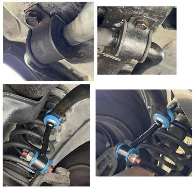

AnotherOldJeepGuy Posted March 31 Author Share Posted March 31 Yep, metric. The bolts holding the sway bar to the frame came out in good shape. I did work them back/forth along the way being mindful of the force and soaked them good with penetrating oil. The other two bolts fastening the link to the frame were completely trashed, as were the threads at the top of the old link, sure glad I got the suggestions to just replace these! I managed to get them out, it took breaking loose force the entire way for all 4 of them, no way I wanted to put them back in. For the ones at the bottom of the link, which did not come with the new links, I matched it up at Napa to M12-1.75 bolts. Added washers since the original nut was a nut/washer combo. The washers they had were not optimal but they will work. I managed to get get 27Ft-Lb on new link top nut, but I stopped short of 75 for the bottom link bolts, at under 50 they seemed to already be 500-lb gorilla tight so I stopped. (I never used a torque wrench from the 70s or so until a couple years ago and the target numbers always seem to take a lot more force than I am comfortable with anyway to click, so I'm calling my intuition good enough). The smaller bolts on the bottom I tightened them until the seemed plenty tight, tighter than they were when I removed them and called it good. The result seems good. Test drive good. I don't know how much effect this has on actual sway, but several of the loud "clunks" I was hearing when I went over a bump now sound like a new truck, I'll take that! Link to comment Share on other sites More sharing options...

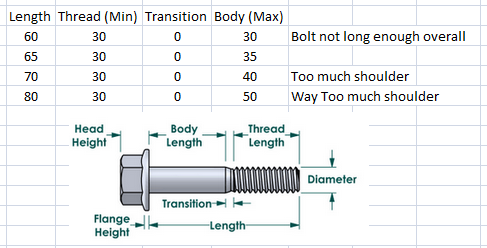

AnotherOldJeepGuy Posted 18 hours ago Author Share Posted 18 hours ago Well the more I look the farther down the rabbit hole I go! I would have never dreamed how much of a research project this would turn into for a stinkin bolt! Rabbit Hole #1 I put my digital caliper to work trying to measure how much thread I need to make sure the threaded part goes at least partially into the hole so that the nut can be tightened / torqued. It looks like any bolt with an un-threaded part (shoulder) longer than about 37mm would expose some of the shoulder, meaning you could not tighten it. The original bolt measures 70mm, but it was fully threaded so this rabbit hole doesn't come in to play for the original or any other fully threaded bolt. The full thread class 8.8 bolt I put in before knowing about this rabbit hole is 65mm long and that total length looks good, but 5mm less than that starts to look too short. Meaning I need something 65mm or longer. A bit further down the rabbit hole on bolt specs and it seems that any length from 65mm up has a MIN thread LENGTH spec of 30mm (based on Bolt Depot and Bolt Barn info), so that means the MAX length of the shoulder is [spec-ed length] - 30mm (MIN length). There is also a transition area identified between the non-threaded area and the threaded area but I don't see numbers spec-ed for that so I have to allow for that in the answer. So rabbit hole 1 of 2 concludes that the only size of a shouldered bolt that works is a 65mm. Rabbit Hole #2 The M12-1.75 bolts I see online seem to be paired with lock nuts, although the don't look like lock nuts to me because I am used to seeing a filler of some type in the nut, nylon I think, to turn the nut into a lock nut. The nut I took off had no such filling, so are there lock nuts that don't have this filling, and, do I need a lock nut? Link to comment Share on other sites More sharing options...

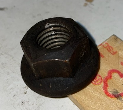

AnotherOldJeepGuy Posted 3 hours ago Author Share Posted 3 hours ago It's not obvious [to me] that there is anything special about the old nut, but it was very hard to remove and seemed to remain tight all the way until it was within a turn or two of coming off. Any nutty experts here that can say for certain just by looking if this is or is not a lock nut? And the plot thickens, I do know for a fact that the new top nuts that came with the new Mevotech links were lock nuts, the nylon insert type. Link to comment Share on other sites More sharing options...
llhat Posted 2 hours ago Share Posted 2 hours ago i cannot tell in the image... but by your description of the actions on removal, the nut was of the thread distortion / deformation type, and a lock nut. typically these nuts have some pressure placed on them after threading to 'smoosh' the top few threads. to me, if the new nuts have nyloc design, use them. I do not think they are vastly superior or anything, but will work, and you've got them. Link to comment Share on other sites More sharing options...
AnotherOldJeepGuy Posted 1 hour ago Author Share Posted 1 hour ago 41 minutes ago, llhat said: i cannot tell in the image... but by your description of the actions on removal, the nut was of the thread distortion / deformation type, and a lock nut. typically these nuts have some pressure placed on them after threading to 'smoosh' the top few threads. to me, if the new nuts have nyloc design, use them. I do not think they are vastly superior or anything, but will work, and you've got them. Makes sense! Link to comment Share on other sites More sharing options...
