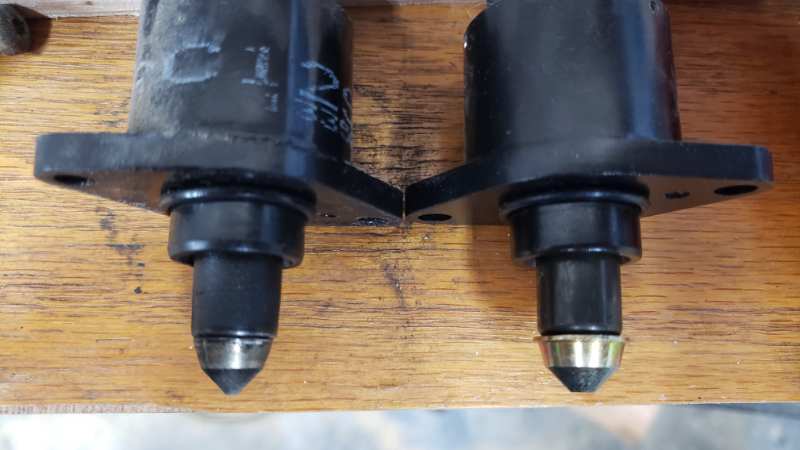

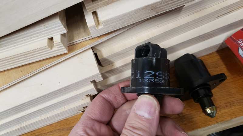

knever3 Posted January 30 Share Posted January 30 I am 13 years into figuring out why my idle is erratic. I just changed the idle air control again with the '91+ style for the BBK throttle body. I pulled the IAC and cleaned and measured the resistance. Idle was low at 550rpm so I adjusted the throttle plate screw a touch and it stayed at 750rpm. I was watching the rpm on the MT-2500 and it went nuts, rpm and theottle position was all over the place, all at idle in park. What in the world! I wiggled the diagnostic connector and the wiring for the sensors and it didn't change. Link to comment Share on other sites More sharing options...
