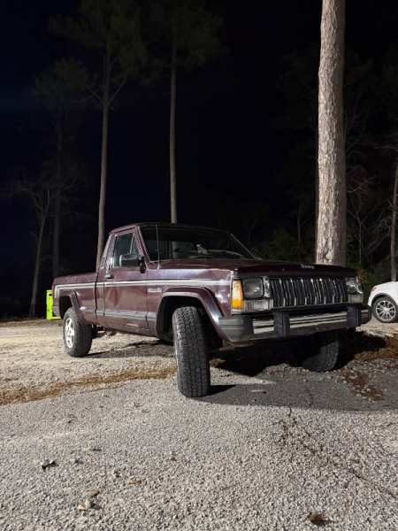

thejeepmanwithcrocs Posted Friday at 11:34 PM Share Posted Friday at 11:34 PM Just got my 3rd Comanche. This one as a daily to and from work while my lifted long bed gets a new roof at the body shop thanks to hurricane Helene. Anyway the turn signals were all rigged with weird ground wires and such and had no ground on my right side. And no power in my left side. Also while diagnosing I realized it had no brake lights. So the wire going to the stop lamp switch had corroded and came out the terminal. New terminal and now brake lights. I got new bulbs and sockets in the front. Now my left turn signals work fine front and back. My right side will illuminate front and back but no blinking. Is it safe to assume the switch might be bad? Link to comment Share on other sites More sharing options...
