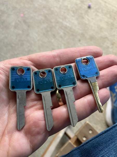

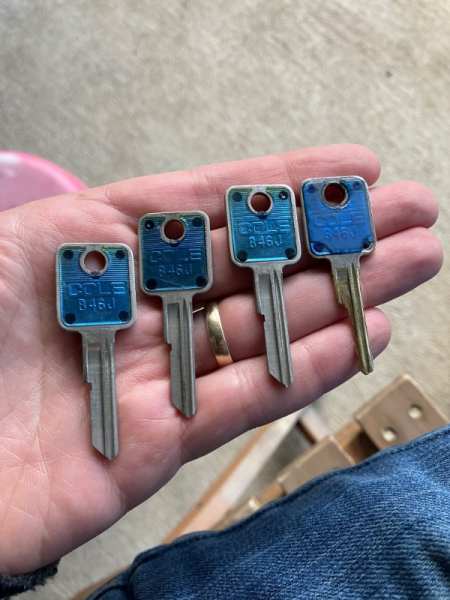

I bought some key blanks that are totally identical to the one my grandpa used. It wasn't easy to track down, and I bought the only ones I could find anywhere on the internet. Now I need to find a locksmith who's willing to use my own blanks.

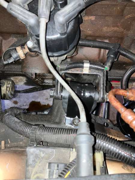

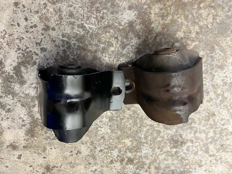

I just finished replacing the transmission mount. The old one was liquifying and melting all over the cross support.
My truck has almost no rust at all underneath, so it was surprising to see how stuck on those bolts were. With a little penetrating oil, my electric impact wrench made pretty quick work of them. They came out hot! I had to work them in and out quite a bit to get them to go back in.

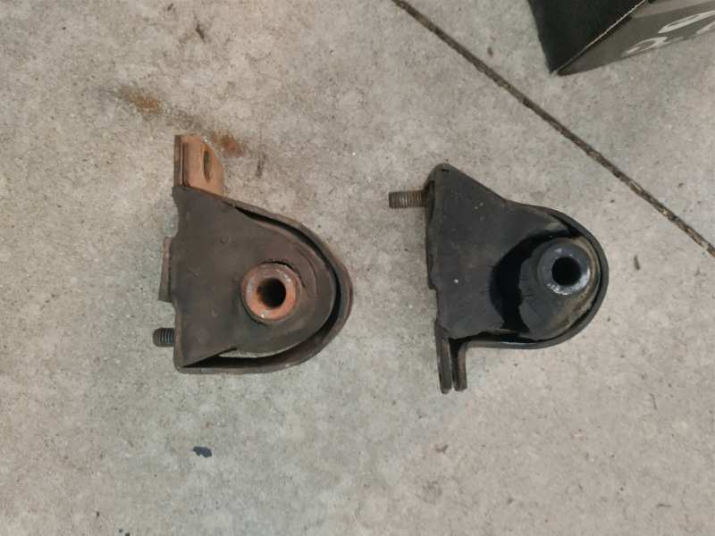

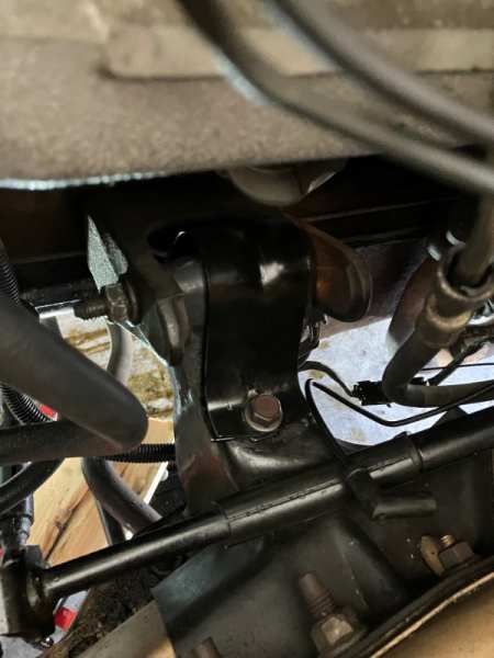

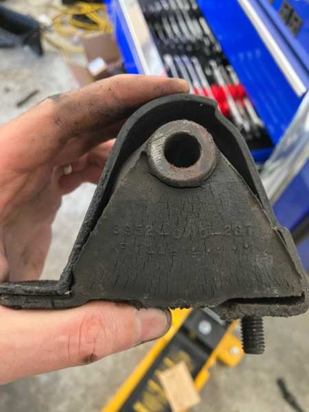

I just finished changing the motor mounts. It turns out they're original! They appear to be dated November 1989.

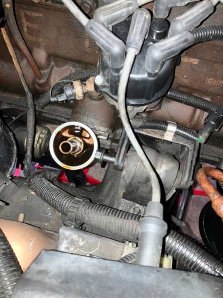

I just changed my oil a couple hundred miles ago, but I had to drain the oil again because the oil filter was in the way of the long bolt. Then the thing the filter screws into was also in the way! (I have no idea what that's called.) It turns out you can remove that. There's a bolt underneath.
Now I need to put the filter back on and hook up the vacuum hoses. The hoses will be a project because I'm not sure where they all go and all of them are loose.

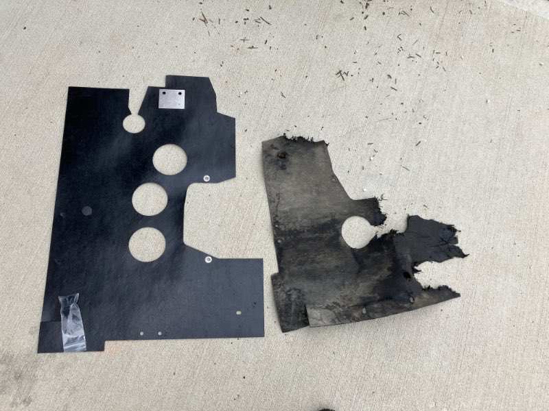

I installed the new splash guard today. I'm super thankful that Detroit Muscle Technologies is reproducing these. It was pouring rain really hard today after I installed it. I'm glad I got it done!
 Here's a before and after picture.

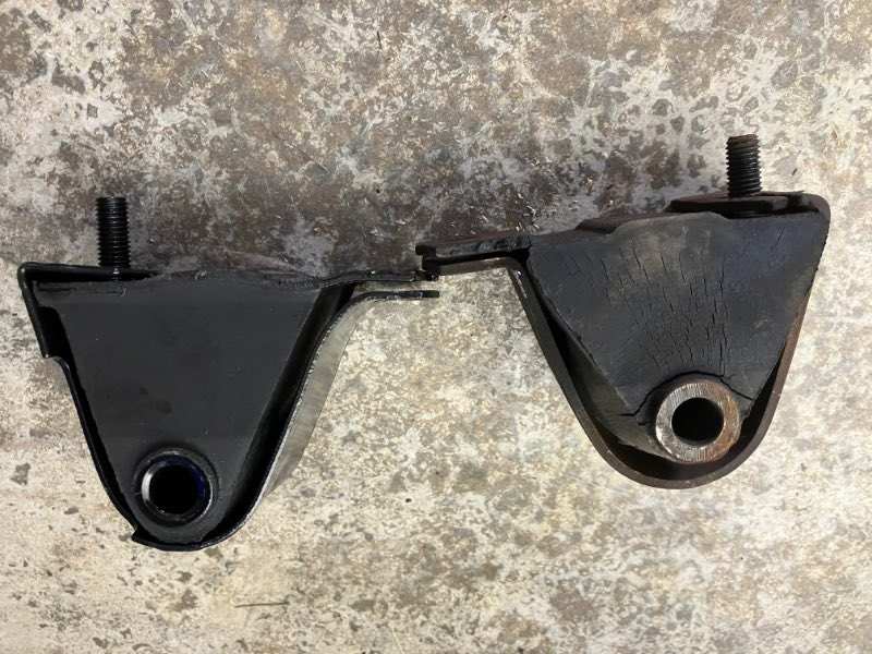

Did you put the motor mount bolt back through the other direction so you don't have to do that again next time?
I tried, but there was something in the way (just barely) on the other side, so I just put it back the way it was. And apparently that's the way it came from the factory because that was the original motor mount!
It's running MUCH smoother now.
It's been a few years since we've done this, but I'm sure we put the bolt back in the other direction. We may have had to cut the bolt so that it didn't hit the oil filter. Like I say, it's been a few years. It's been our experience that the motor mounts do need to be replaced periodically. The rubber gets brittle and breaks after a while. Just replaced the motor mounts on our newly acquired '97 a couple weekends ago. This is what I took out:
Are those mounts supposed to be the same? The difference between them seems a little wonky. Is it riding a lot smoother now?
I can't remember what was on the other side, but I recall it being something that looked more difficult to remove, so I just went with the old setup. Now that I know it's an issue, I'll plan to do the motor mounts and the oil change at the same time. It was just really annoying because I had already changed my oil twice in less than 1,000 miles and I had to drive to the store to get some oil.
Now that I've done it once, I feel pretty confident that I could do this within an hour next time. It seems like the majority of my time on this truck has just been spent figuring out how to do things. Any time I have to redo something, it goes pretty quickly.
I also replaced the oil cap and the o-rings on the filter housing. I'm sure they were original as well. I'm not sure whether they were leaking, but I love replacing things before they become a problem.
Those were the old motor mounts that I took off. They would have looked the same when new. Our record for replacing one was about 20 minutes.
If the O-rings on the oil filter housing were original, then I'm sure they were leaking. That's another repair that all of our old Jeeps need if original. The rubber O-rings don't last 30-40 years.
You're probably right. They were completely flattened, flush with the metal. I never saw oil dripping from it, but it probably had a very slow leak.

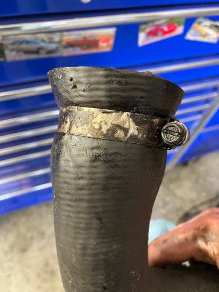

I've been juggling a lot of projects recently. I replaced all of the heater hoses, the radiator hoses, and the coolant reservoir. I'm about to go flush the radiator also, but I'm waiting until I'm ready to pull it out onto the driveway. I also have a new heater valve that I'll be installing when I do the flush. The bench is removed right now, so it will be interesting trying to back it out of the garage.
The heater hose tee was in rough shape. I took this picture when while I was midway through sanding it down.

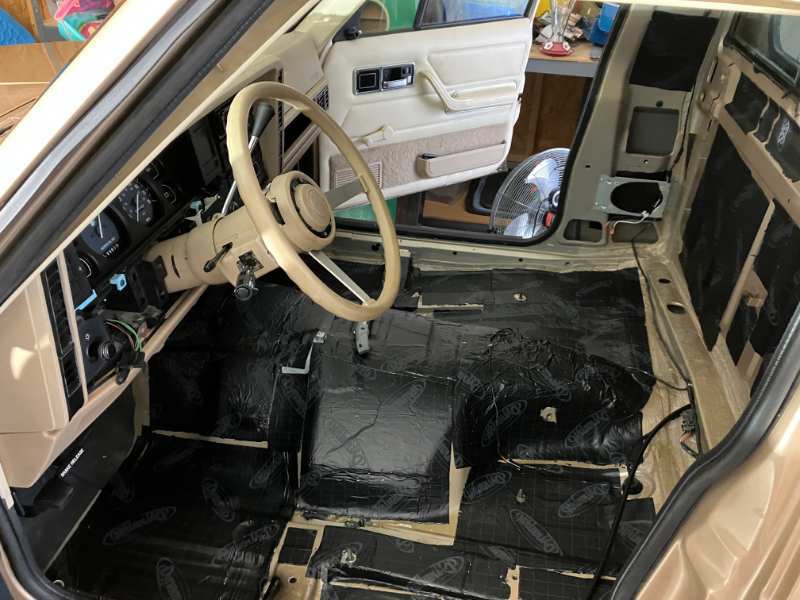

I removed the carpet and pressure washed it.
I found two of the three clips that had broken off the courtesy lights, so I was able to repair them!

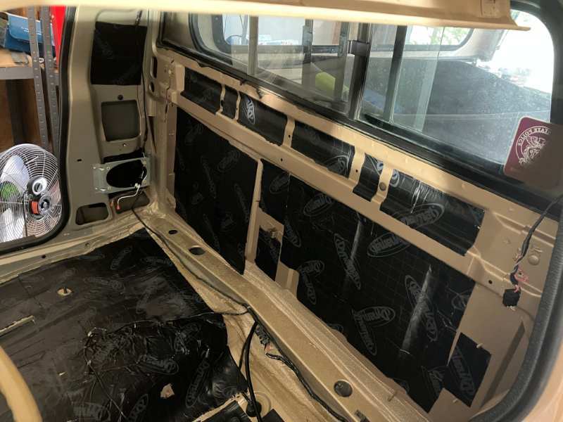

I just some Dynamat Xtreme and some Dynapad today, but I have to wait until my POR-15 comes before I can install it.
Busy weekend!
I had forgotten to change the lower radiator hose the first time around, so I replaced both it and the heater valve. It turned out that the hose was completely saturated with oil, probably from when the valve cover gasket was leaking. It was so loose, it was ready to fall off on its own.

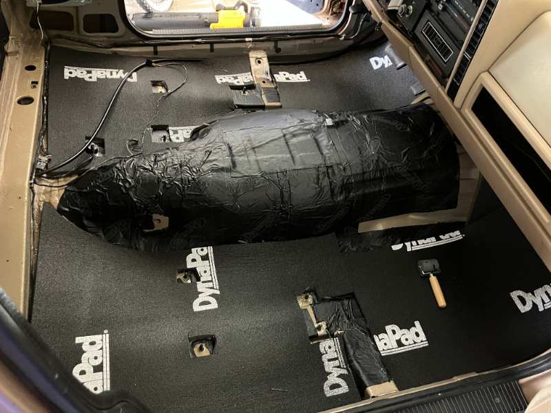

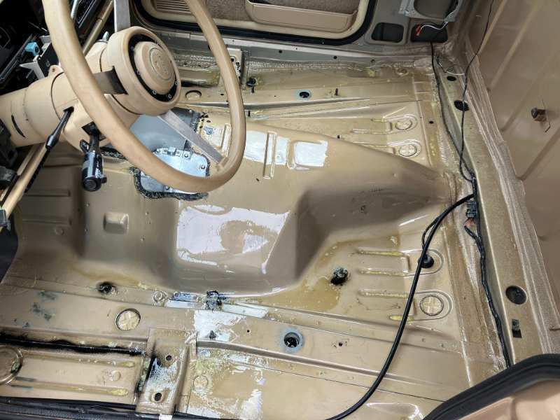

I sprayed all of the surface rust with Rust Oleum primer, patched a couple holes with seam sealer that seem to have been made at the factory, and treated the floor with POR-15 after using their degreaser and metal prep. The transmission hump looked so beautiful and shiny when I finished, I'm a little sorry I had to cover it up.

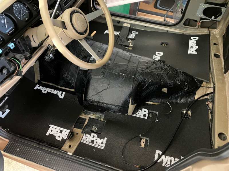

I put down some Dynamat. I haven't driven it yet, but it made a huge difference when knocking against the sheet metal.
I added some Dynapad on top of that.

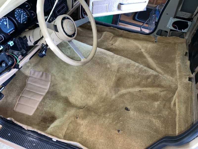

A couple weeks ago, I had pressure washed the carpet with degreaser, Oxiclean, and regular carpet shampoo.
I have most of the trim back on now and the floor feels great. The carpet went back into place very easily. I need to replace the tree clips on the trim along the top of the driver's side, and I need to replace that antenna grommet before I finish the trim.
All of that sound deadener is going to make a huge difference with that truck. It will make it a pleasure to drive.
I hope so! It seemed to me that it felt quieter working inside the cab after I installed the DynaPad. I still need to install the DynaMat on the doors and ceiling.
