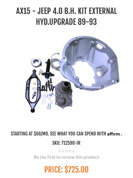

Ricky8227 Posted November 17 Share Posted November 17 I have a 1992 jeep Comanche 4.0 4x4. Wanting to purchase the advanced adapters ax15 external slave conversion kit. What pilot bearing do I order? Also when ordering a clutch kit, do I order it for a 1992 jeep Comanche? Or from like a 1995 xj? Link to comment Share on other sites More sharing options...

Eagle_SX4 Posted November 17 Share Posted November 17 1 hour ago, ghetdjc320 said: Actually, it probably won’t fit. When they went to external slave, the tranny input shaft was 3/4 vs the 5/8. A pilot bushing from 93- XJ should fit. Not that it really matters but the previous owner switched my truck to an internal slave AX15 and it had the 3/4 inch inputshaft. I was very surprised to find this when I changed to the external slave setup. I think the switch to the larger input shaft was before the external slave cylinder. 5 hours ago, Ricky8227 said: So the pilot bearing that comes in the 1994+ clutch kit will fit? You may already have the larger input shaft you will have to measure it when you pull out your transmission. Also when I switched to the external slave cylinder I did not change my clutch because it had less than 10,000 miles on it and was in great shape. I did not run into any issues with the internal slave clutch with the external slave cylinder. Link to comment Share on other sites More sharing options...
