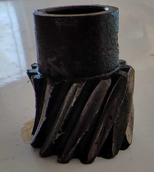

Eagle_SX4 Posted October 18, 2025 Share Posted October 18, 2025 I had my cam shaft eat my distributor gear. It could be that but I have not found any other instances of that happening so it is a real long shot. This is what my distributor gear looked like. Link to comment Share on other sites More sharing options...

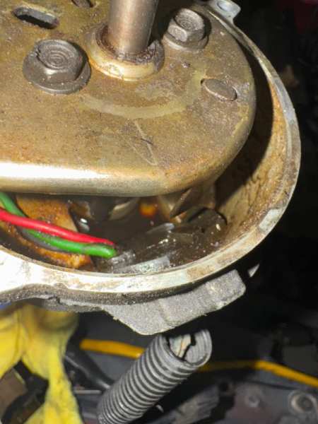

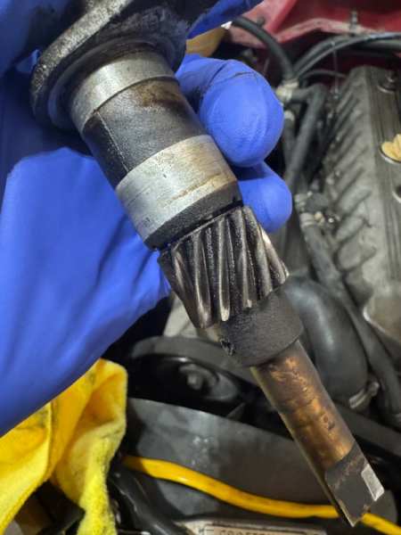

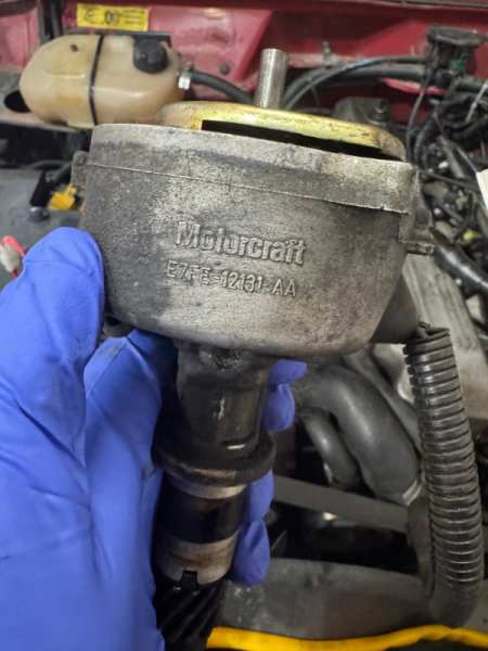

Smash6 Posted October 18, 2025 Author Share Posted October 18, 2025 So we removed the distributor. I didn’t like how much play there was. The gear shows some wear and there was oil in the distributor housing. It appears to be the original motorcraft. So we’ll be replacing it. Link to comment Share on other sites More sharing options...
Eagle_SX4 Posted October 18, 2025 Share Posted October 18, 2025 Look down in the distributor hole and check the gear on the cam shaft. If it is worn out it will just eat your new distributor gear even worse than the old one. Link to comment Share on other sites More sharing options...

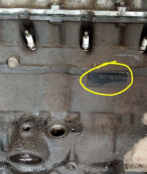

Smash6 Posted October 18, 2025 Author Share Posted October 18, 2025 Thanks! Peaked in and it isn't too bad. I think the long block is about 13 years newer than that distributor. It isn't perfect...but at this point, if that cam is hosed, the motor is coming out for a rebuild. F-it. Link to comment Share on other sites More sharing options...
Eagle_SX4 Posted October 19, 2025 Share Posted October 19, 2025 The date code on the engine is just above the distributor hole towards the front slightly. First number is the year, second 2 are the month and the last 2 are the day. Link to comment Share on other sites More sharing options...
