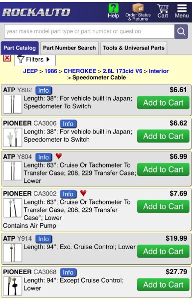

Greenjeans Posted October 17, 2025 Share Posted October 17, 2025 I also did the 2wd to 4wd conversion (XJ). I bought a new one from rock auto, I’m pretty sure it is 94”. That is without cruise control. The 63” is shorter because it goes to the cruise control under the hood. You need the long one if it’s going all the way to the speedometer. Link to comment Share on other sites More sharing options...
ratrapp Posted October 17, 2025 Author Share Posted October 17, 2025 i think thats way I'm going to go if i do this. Link to comment Share on other sites More sharing options...
