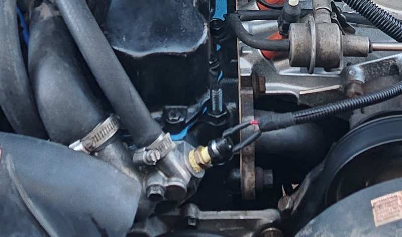

Eagle_SX4 Posted October 1, 2025 Share Posted October 1, 2025 You can get a new thermal switch for your e-fan so that it automatically kicks on earlier. I installed one when I swapped my engine and went to an open cooling system. This is the one I got it has been working great so far. It is a 200 degree switch. https://www.pegasusautoracing.com/productdetails.asp?RecID=27900 I installed it into an H.O. thermostat housing with an extended wire harness. Link to comment Share on other sites More sharing options...
