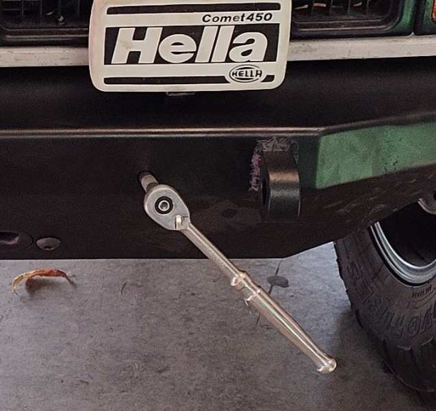

Eagle_SX4 Posted September 11, 2025 Share Posted September 11, 2025 10 hours ago, Big_Mark said: As long as you can get to the winch spool a hidden mount is great. But if it's just tucked away and you have to dissasemble the bumper to get to the winch mechanisim you might be in a pickle if the cable gets bound up in the woods. With the iron rock bumper I welded a socket extension on the spool lever and drilled a hole in the bumper to access it by using a socket extension through the front of the bumper it works really well. The trick is drilling the hole in the right spot. Link to comment Share on other sites More sharing options...
EUREKA Posted September 11, 2025 Author Share Posted September 11, 2025 3 minutes ago, Eagle_SX4 said: With the iron rock bumper I welded a socket extension on the spool lever and drilled a hole in the bumper to access it by using a socket extension through the front of the bumper it works really well. The trick is drilling the hole in the right spot. Perfect practical solution. Link to comment Share on other sites More sharing options...

Eagle_SX4 Posted September 11, 2025 Share Posted September 11, 2025 1 hour ago, 75sv1 said: Boostwerks makes one. That is where I got the idea for the socket extension for the spool lever. I emailed them but they never got back to me on when the M8000 remote free spool adapter would be available. So I made my own. Link to comment Share on other sites More sharing options...
75sv1 Posted September 11, 2025 Share Posted September 11, 2025 24 minutes ago, Eagle_SX4 said: That is where I got the idea for the socket extension for the spool lever. I emailed them but they never got back to me on when the M8000 remote free spool adapter would be available. So I made my own. Still, cool that you fabbed it up. I will say that taking off the solid bumper on the BDF Hidden winch setup, is fairly easy. So, switching in and out to a tube bumper would not be a big deal. I can see around town or such, the sheet metal bumper might keep some from messing with the winch. Link to comment Share on other sites More sharing options...

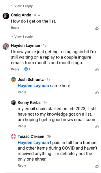

Htchevyii Posted September 15, 2025 Share Posted September 15, 2025 The Baddadfab Facebook page is not very inspiring. I had been considering ordering, but his last post was in 2024 and the comments seem to indicate that people are not getting their products or even an answer. The Boostwerks one was my other favorite option. 😕 Link to comment Share on other sites More sharing options...
EUREKA Posted September 18, 2025 Author Share Posted September 18, 2025 I On 9/15/2025 at 1:07 PM, Htchevyii said: The Baddadfab Facebook page is not very inspiring. I had been considering ordering, but his last post was in 2024 and the comments seem to indicate that people are not getting their products or even an answer. The Boostwerks one was my other favorite option. 😕 Thanks for the info. I think I'm going with the iron rock set up. Link to comment Share on other sites More sharing options...
