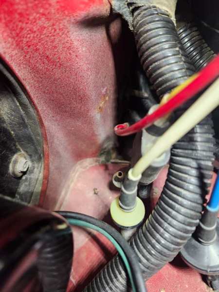

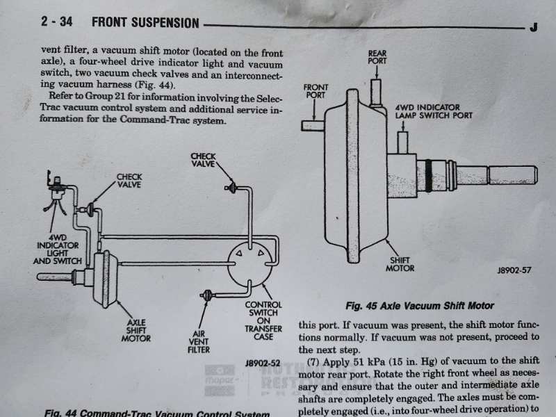

robfg67 Posted September 8, 2025 Author Share Posted September 8, 2025 STATUS UPDATE: I ran a new 1/4" line from the vacuum switch under the coolant bottle to the white male port coming off the shift motor at the axle and the PART TIME light did not come on with engine running and in engaged in 4WD. I tested the hose at the vacuum switch with engine running and 4WD engaged with a digital manometer and it is pulling vacuum, but not much. It was about .024" of water column. Again, when I tested the vacuum switch with a vacuum pump a couple days ago (which pulls a lot deeper) it turned on the PART TIME light. I also removed the transfer case vacuum plug and the pintle seemed to move freely to me. Lastly, although this Jeep is 35 years old, it only has 40k original miles and is in MINT condition. Any thoughts? Link to comment Share on other sites More sharing options...

llhat Posted September 9, 2025 Share Posted September 9, 2025 looks like some troubleshooting procedures in that scan above... but seem to be cut off......... can the full pages be scanned? Link to comment Share on other sites More sharing options...

llhat Posted September 9, 2025 Share Posted September 9, 2025 there is a vacuum line on the passenger fender, at one spot will have a 'tee' for cruise control.... and it supplies vacuum to the hvac box it follows the fender behind the battery down to the canister on the bumper. Question........ when you have your heat or even A/c operating, and you hit a hill or accelerate, does the air output 'switch' on its own to the defrost ducts on the windshield? If it does, that is a sign of weak vacuum/ cracked canister, or a hole in the hose... Otherwise I'd think you would have enough vacuum supply for the shift device and associated parts... On the intake manifold there's probably at least 3 sources of vacuum... as seen above.. supplying the fuel pressure regulator and in combination supplying the EGR supplying the rear CCV fitting on the valve cover that rearmost fitting is probably the source for the rest of the vacuum systems.... on the other schematic, there's the switch on transfer case... should be a vacuum supply to it, as that switch re-directs vacuum based on shift position.... Link to comment Share on other sites More sharing options...

WAEMID IV Posted September 17, 2025 Share Posted September 17, 2025 Based on all your confirmed known functional components, the issue has to be with the white line or something it plugs into. We know the light on the dash works when the switch has vacuum, and we know the CAD axle is actually engaging (right?) Once the CAD fork is in the *engaged* position, the *white* line receives vacuum. Thus, if the CAD *is* working and your part time light *doesn't* turn on, it means the *white* line is not receiving vacuum or it is compromised at some point, perhaps a check valve may have failed internally. I would triple check to make sure the shift fork inside the CAD thingy does actually engage, just to be certain, because that's usually where this kind of issue stems from. Link to comment Share on other sites More sharing options...
