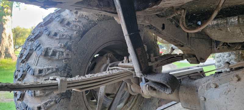

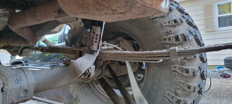

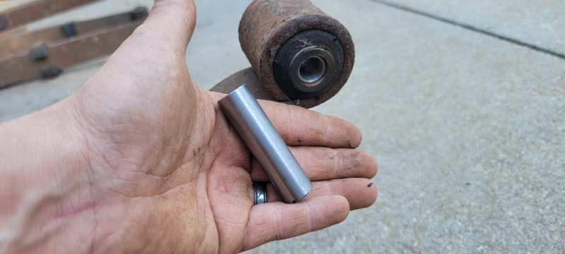

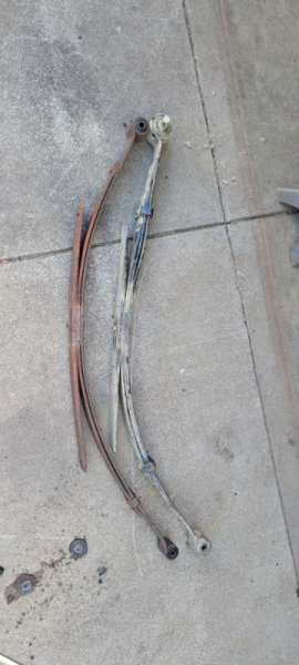

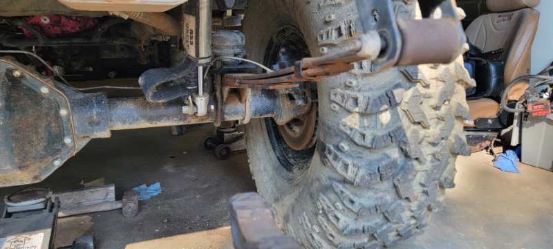

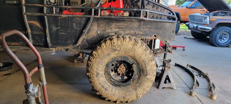

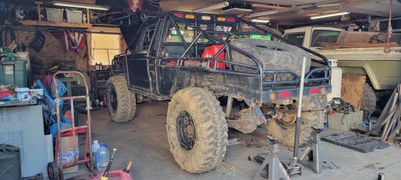

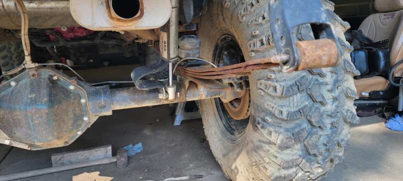

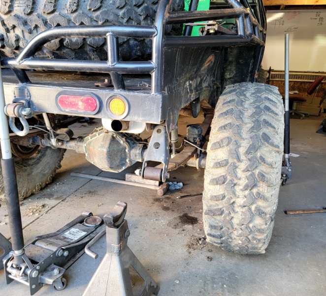

ThatJeepGuy Posted September 8 Author Share Posted September 8 The F150 leaf spring swap progress update This was the before. Take notice to the shackle angle... The pictured leaf spring on the right is a dorman factory replacement. On the left we have the f150 leaf spring. Small note - the front bolt in the Ford is an 18mm which is larger than our factory 9/16s bolt. I'm having a custom sleeve made to correct this but others may drill out their front mounting hole to compensate. Install is simple enough 1st thing and its not too surprising, it sits lower than the former dorman leafs did. Obviously lighter rated so i expected that, roughly 1-1.5" lower than previously- this being measured in my distance between bump stop(s). Also the shackle angle, which again this is to be expected because of the slightly longer length. I'm still going to keep my eye out for another set of the higher weight rated leafs before i call this over with soo until then - hope this helps others Link to comment Share on other sites More sharing options...

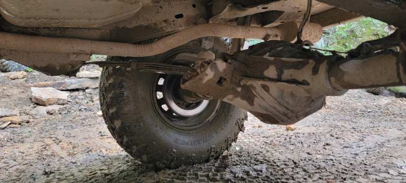

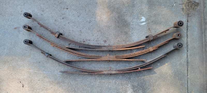

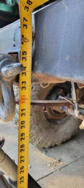

ThatJeepGuy Posted September 13 Author Share Posted September 13 Soo we're back! Bottom leaf is the 3 leaf pack, middle leaf is what I believe to be the 1415 pack and the top is what I believe to be thr 1900 pack. Difference between the 1415 and 1900 4 leaf packs? The 1900 pack has dual clamps and also the arched overload vs the 1415 pack having 1 light duty clamp and a completely flat overload. Adapting sleeve for the front bushing Again this is the 3 leaf pack. Just under 34" to my bumper. This is purely a reference point Then at just under 35" we have the 1415 pack Lastly what i believe is the 1900 pack at just over 35". I'm going to stick with the 1900 leaf pack to start out, if they prove to be too stiff then I can bastardize the pack as needed with he other 2 sets. Link to comment Share on other sites More sharing options...
